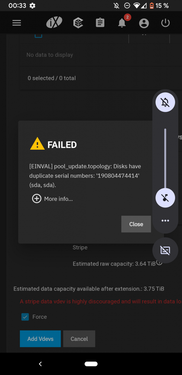

Hello,
Just add a 2nd HDD to the NAS
I would like to extend the 1st disk or add the 2nd through a vdev.
When i triés i for an error about a duplicate serial number
This duplicate is thé SSd (sda) divide in 2 partition.
1 for the os 1 for Storage.
I add the New disk (sdc) to the sdb pool.
Thats why i do not understand this message error
Is somebody understand why ?
9,700

obligatory: your hardware is not recommended, and you have obviously somehow forced the OS disk to be allocatable. this is quite a ways outside any supported configuration. since I do not know how you forced this, I would first suspect that some part of this hack is affecting your other disks. I notice your screenshot seems to say you are trying to add sda to sda, which i would assume is why it says they are the same drive.
