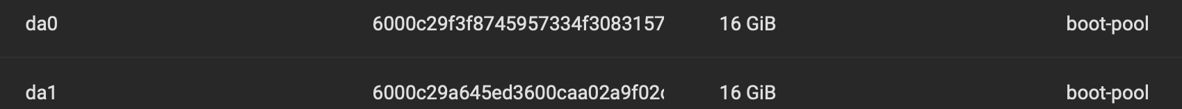

da0 and da1 are my boot disks from ESXi. They do not show serial numbers:

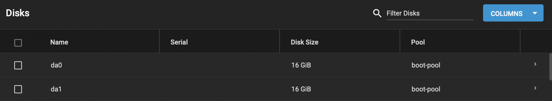

middlewared.service_exception.ValidationErrors: [EINVAL] pool_create.topology: Disks have duplicate serial numbers: '' (da0, da1).da0 and da1 are my boot disks from ESXi. They do not show serial numbers:
