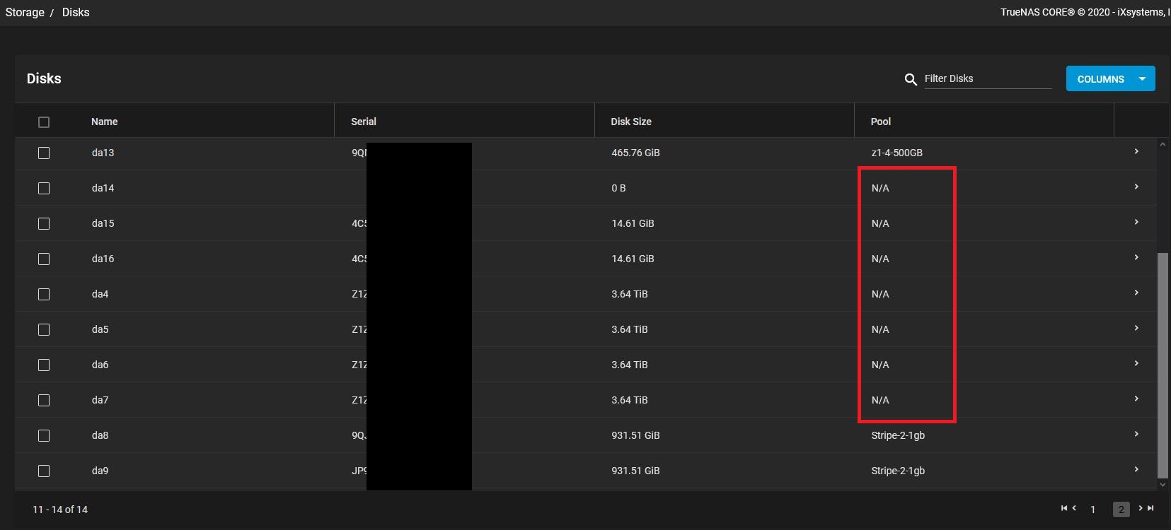

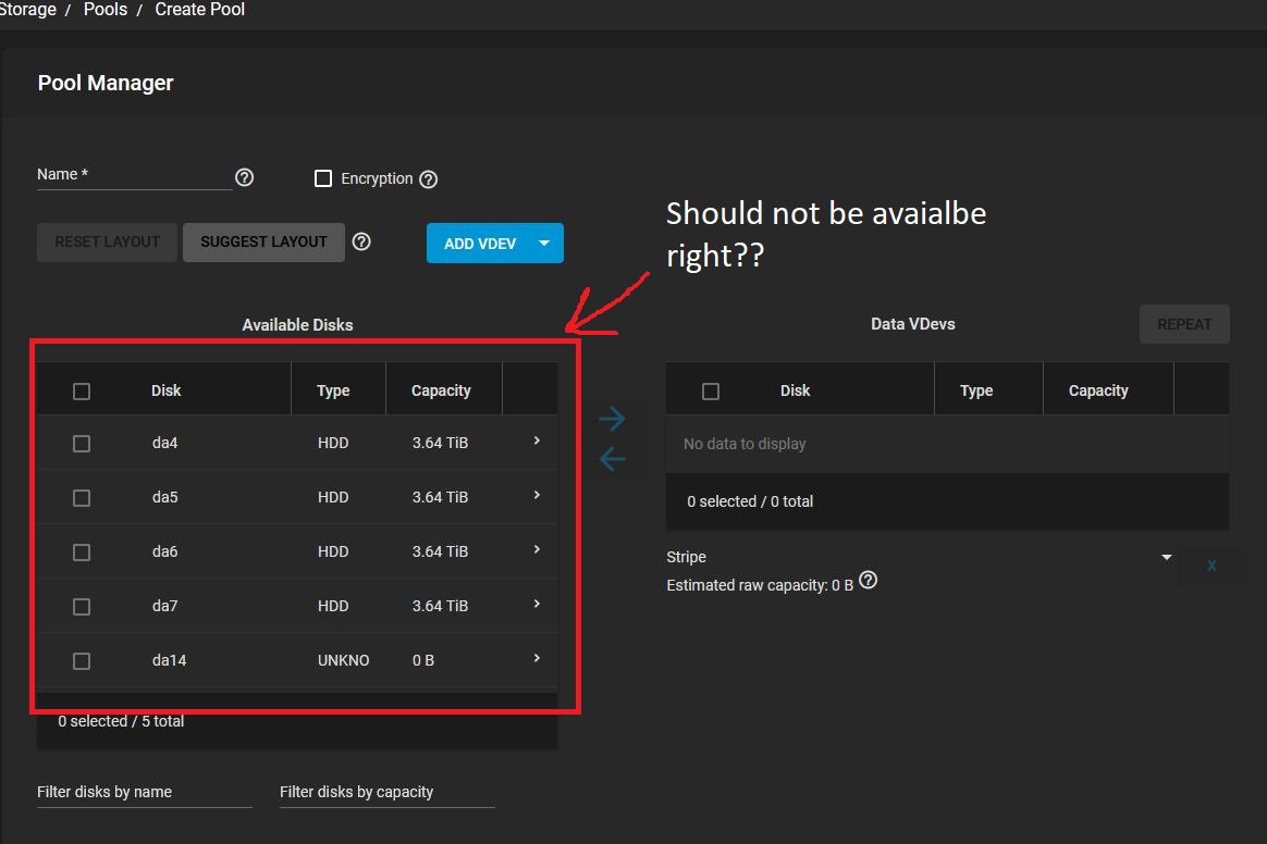

Hello everyone,
I am new to this forum so please forgive me for not contributing much. FreeNAS and TrueNAS has been wonderful thus far and I've never needed to come here until today. That being said, here is my issue:
I recently moved my TrueNAS system over to a new one. The old system was a custom box consisting of a SuperMicro motherboard with built in SAS controller. The OS runs off two USB drives for redundancy. I recently moved everything to a SuperMicro JBOD chassis which is connected via two 8088 cables to a Dell PowerEdge R310. The SAS controller is a "LSI 9200-8e 6Gbps 8-lane external SAS HBA P20 IT Mode". Everything moved over great and was up and running as normal. It wasn't until I added some older SATA drives, to create a new pool, that I noticed my main pool (Pool1) didn't show the existing drives as being used by Pool1. The drives that I moved over are 4TB drives. When I was creating a new pool, I saw that the four 4TB drives could be used to create a new pool. I thought this wasn't right because the drives are supposedly already assigned. I have updated TrueNAS to the most current version and I've conducted a pool scrub. I'm not sure what to do as this point.
I've attached some screen shots help make it clear as to what I'm talking about. Thank you.

That does appear odd for sure. Please go ahead and make a ticket on jira.ixsystems.com and attach these screenshots, as well as a debug file (system -> advanced -> save debug). We'll need to investigate what's going on here and see if this is a legit bug or not.

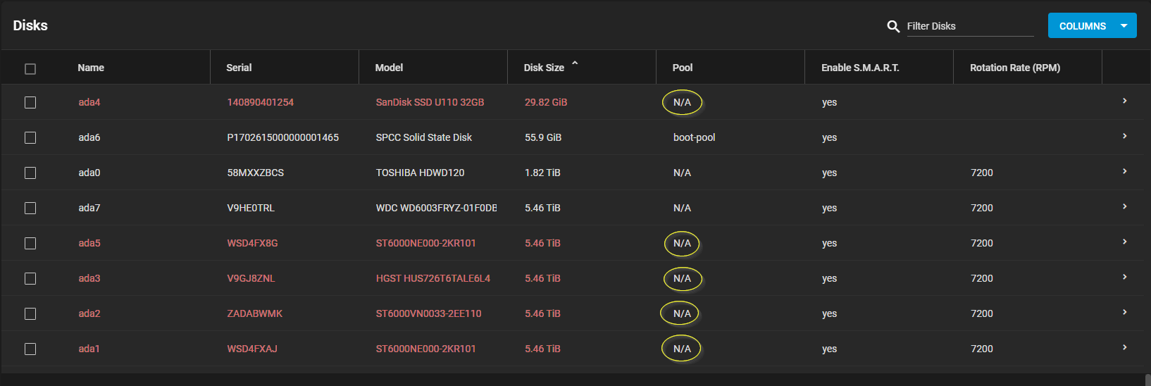

I too can add the three missing disk to a new pool, in the pool manager, as shown in "truenas issue2.jpg" screenshot.
I've attached the output of geom disk list and zpool status -v.
As you can see, ada0 and ada1 are acutally SSDs, not HDDs.
Also, ada2, ada3 & ada4 don't actually "exist", they should be da0-da5.

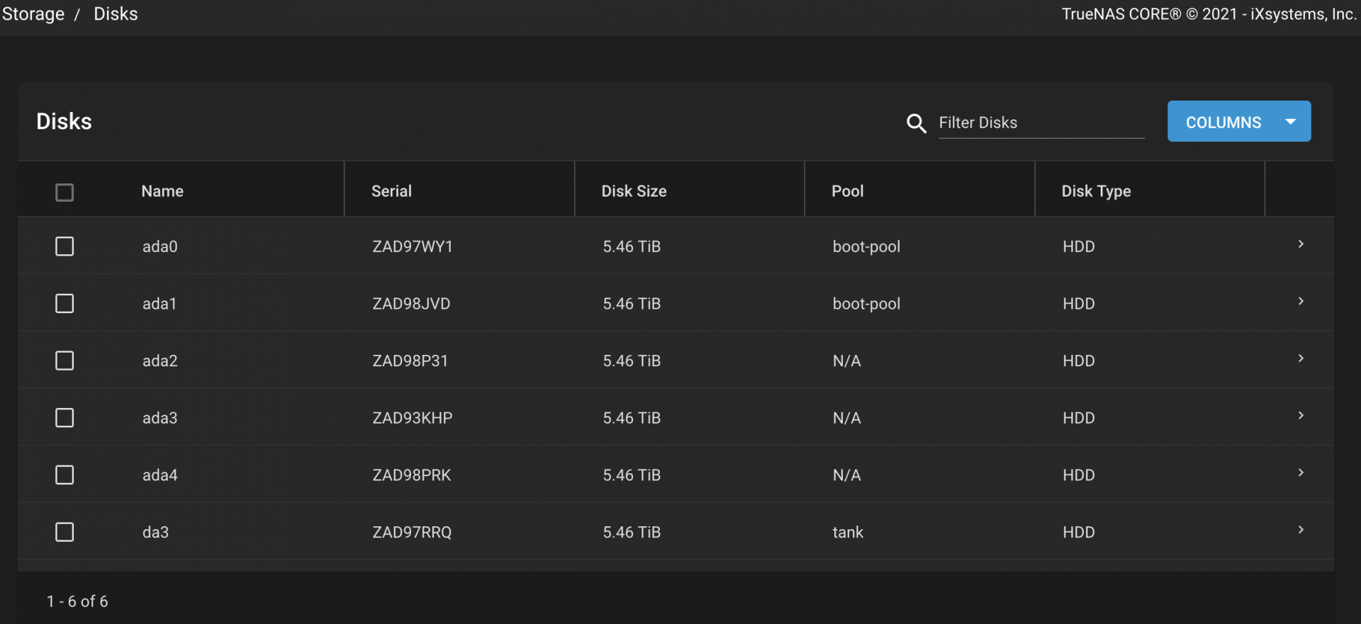

Following up on this, I found the ticket that (I'm assuming) @tensi0n lodged on jira.ixsystems.com
TrueNAS | NAS-109184 | Drives not showing assigned to pool
According to the only comment on the ticket:
your da4-da7 drives have the same serial numbers as da0-da3 drives, your system is seeing the same drives twice, probably due to a wiring issue. We support multipaths, but we don't create multipaths from drives that are already used in a pool. Please consult your controller manual in order to disable this.
I've double checked and cross referenced the serials numbers of the drives, but they all appear (as far as I can tell) to be reported as individually different in TrueNAS.

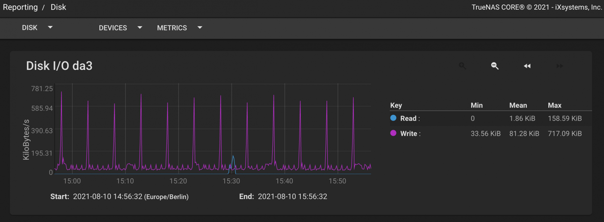

Additionally, da3 is the only reported disk in the "Reporting / Disk" section. It is also the only disk that is reported correctly in "Storage / Disks" section. (screenshot attached)

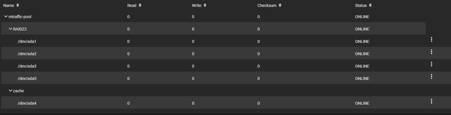

Hello, I am new to truenas, I imported a ZFS pool from XigmaNAS to TrueNAS. The pool imported fine with my cache ssd drive but these drives are not showing up as assigned to the pool. So they are still available to select when creating a new pool etc...
I found this thread and it speaks to an issue that was in a previous version of TrueNAS.
I have ran the commands in shell midclt call -job disk.sync_all and it executes without error.
Any help would be greatly appreciated
thanks
Version:
TrueNAS-12.0-U8.1
