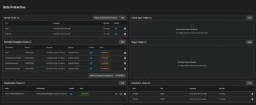

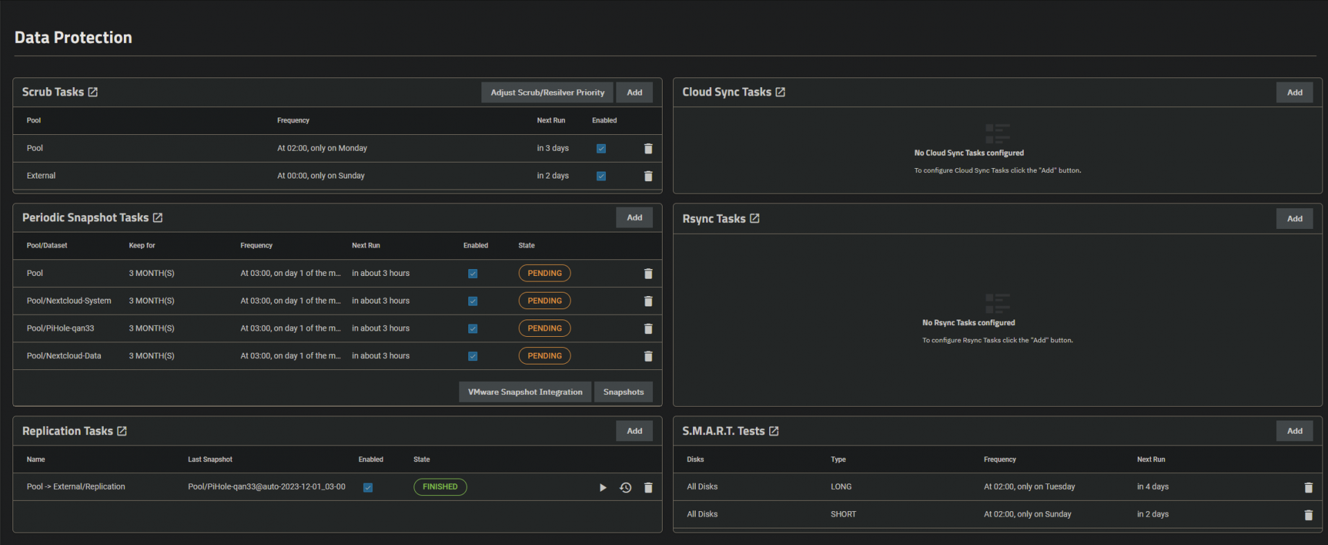

I powered off all vms before 0:00. But the crash came anyway... so there is something wrong with the Truenas system itself. But with no error logs? This is so strange. Maybe its something because of the backup jobs? Maybe one backup job is not configured well. This will explain why it always crash at 0:00. But there is no job at 0:00. I took this screenshot at 0:07 after truenas booted again. But maybe there is a pending job? I mean a job which failed days ago and now truenas want to run this job again at 0:00? Maybe an error happened in the past and then Truenas will try to run it again or want to fix this at 0:00? Maybe someone know if such processes are included in Truenas' code?

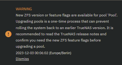

Is there a option in Truenas to fix zfs pools automatically? And I get this new message after the upgrade to 23.10. But I do not know how do I upgrade my zfs pools. I guess I need to use the terminal and just enter "zpool upgrade <pool name>"?
No need to upgrade the pool. That prevents rollback.
If it is a corrupted pool, its worth reporting the issue. @florihupf did you report a bug or find a resolution?

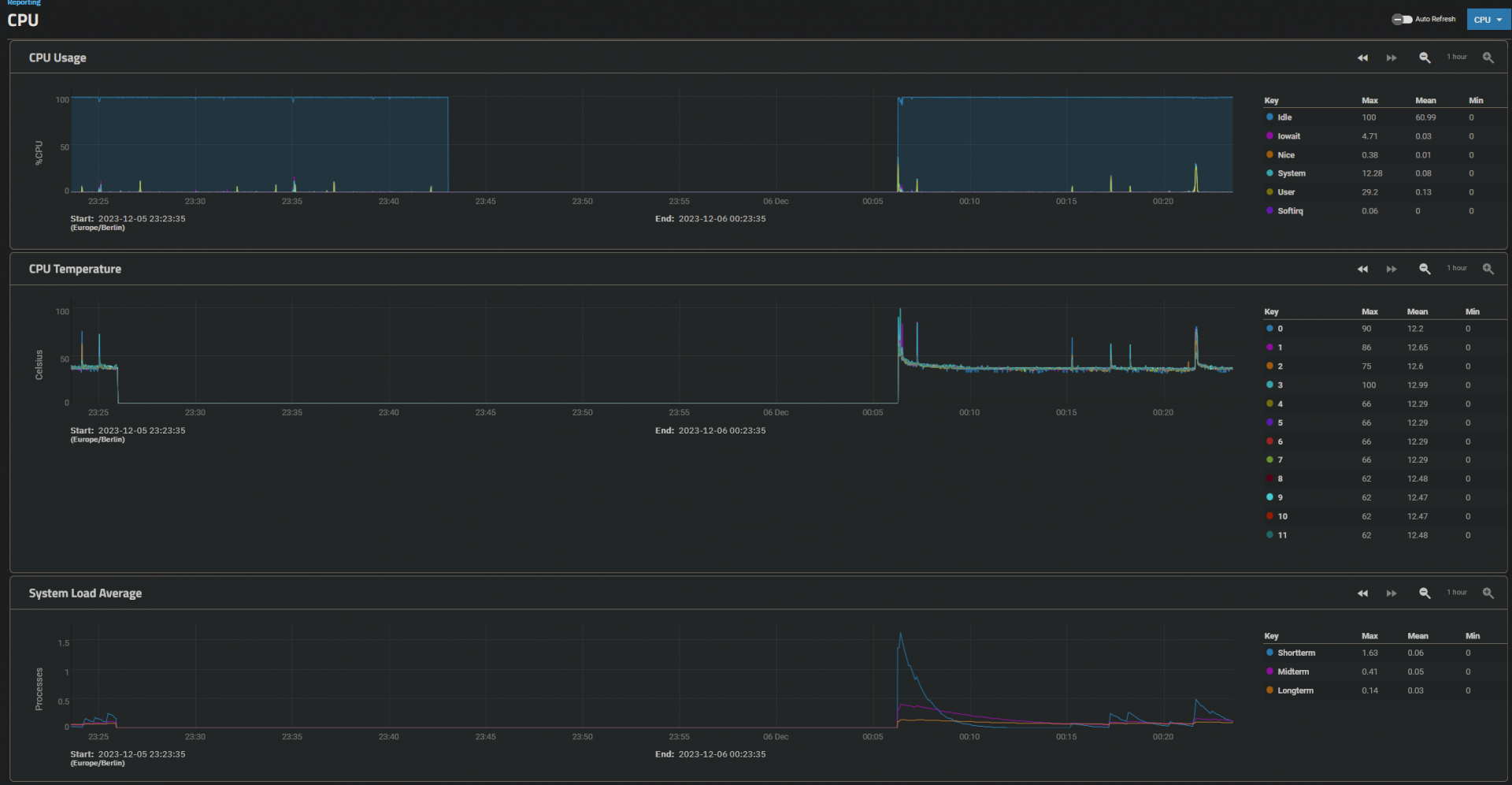

Now I updated the bios clock (was 1h behind) and updated the bios. The system is still always crashing at 0:00. But now I can see something in the reporting of the cpu, disk, .... So the system was this night already down at 23:43, until truenas rebootet and was available again at 0:06.
I don't think its because of missing ecc ram, because normal ram do not fail that often and it also make no sense that the system always crash to a specific time.
But I think I need to switch to Proxmox now, this is too much for me. No informations in the logs and I need to reboot my vms every night. This is not cool.
Memory errors don't occur regularly... so lack of ECC is not causing any issue at midnight.
Lack of ECC allows something in memory to be corrupted and then committed to storage. This can corrupt a file system. Its a rare event, but very difficult to diagnose or remedy.
Its not clear what the cause is here, but it does not appear to be a software bug that is causing issues on many systems... likely something in the local system. Erasing the pool/systems and reloading may remove the underlying cause.... regardless of whether its proxmox or SCALE.
