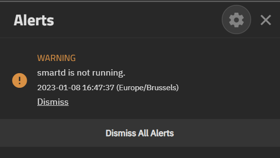

TLDR : SMART simply won't start.

[EFAULT] Jan 08 16:48:37 systemd[1]: Starting Self Monitoring and Reporting Technology (SMART) Daemon... Jan 08 16:48:37 smartd[72413]: smartd 7.2 2020-12-30 r5155 [x86_64-linux-5.15.79+truenas] (local build) Jan 08 16:48:37 smartd[72413]: Copyright (C) 2002-20, Bruce Allen, Christian Franke, www.smartmontools.org Jan 08 16:48:37 smartd[72413]: Opened configuration file /etc/smartd.conf Jan 08 16:48:37 smartd[72413]: Configuration file /etc/smartd.conf parsed but has no entries Jan 08 16:48:37 smartd[72413]: Unable to monitor any SMART enabled devices. Try debug (-d) option. Exiting... Jan 08 16:48:37 systemd[1]: smartmontools.service: Main process exited, code=exited, status=17/n/a Jan 08 16:48:37 systemd[1]: smartmontools.service: Failed with result 'exit-code'. Jan 08 16:48:37 systemd[1]: Failed to start Self Monitoring and Reporting Technology (SMART) Daemon.
File "/usr/lib/python3/dist-packages/middlewared/main.py", line 181, in call_method
result = await self.middleware._call(message['method'], serviceobj, methodobj, params, app=self)
File "/usr/lib/python3/dist-packages/middlewared/main.py", line 1255, in _call
File "/usr/lib/python3/dist-packages/middlewared/schema.py", line 1284, in nf
File "/usr/lib/python3/dist-packages/middlewared/schema.py", line 1152, in nf
res = await f(*args, **kwargs)
File "/usr/lib/python3/dist-packages/middlewared/plugins/service.py", line 168, in start
raise CallError(await service_object.failure_logs() or 'Service not running after start')
middlewared.service_exception.CallError: [EFAULT] Jan 08 16:48:37 systemd[1]: Starting Self Monitoring and Reporting Technology (SMART) Daemon...
I have no idea what could be causing this, nothing special is set on my SMART configuration nor disks. And everything worked without any issues these past years with the exact same HW & controller.
EDIT: Could it be a missing driver in the newest release of Bluefin?
Thanks in advance!

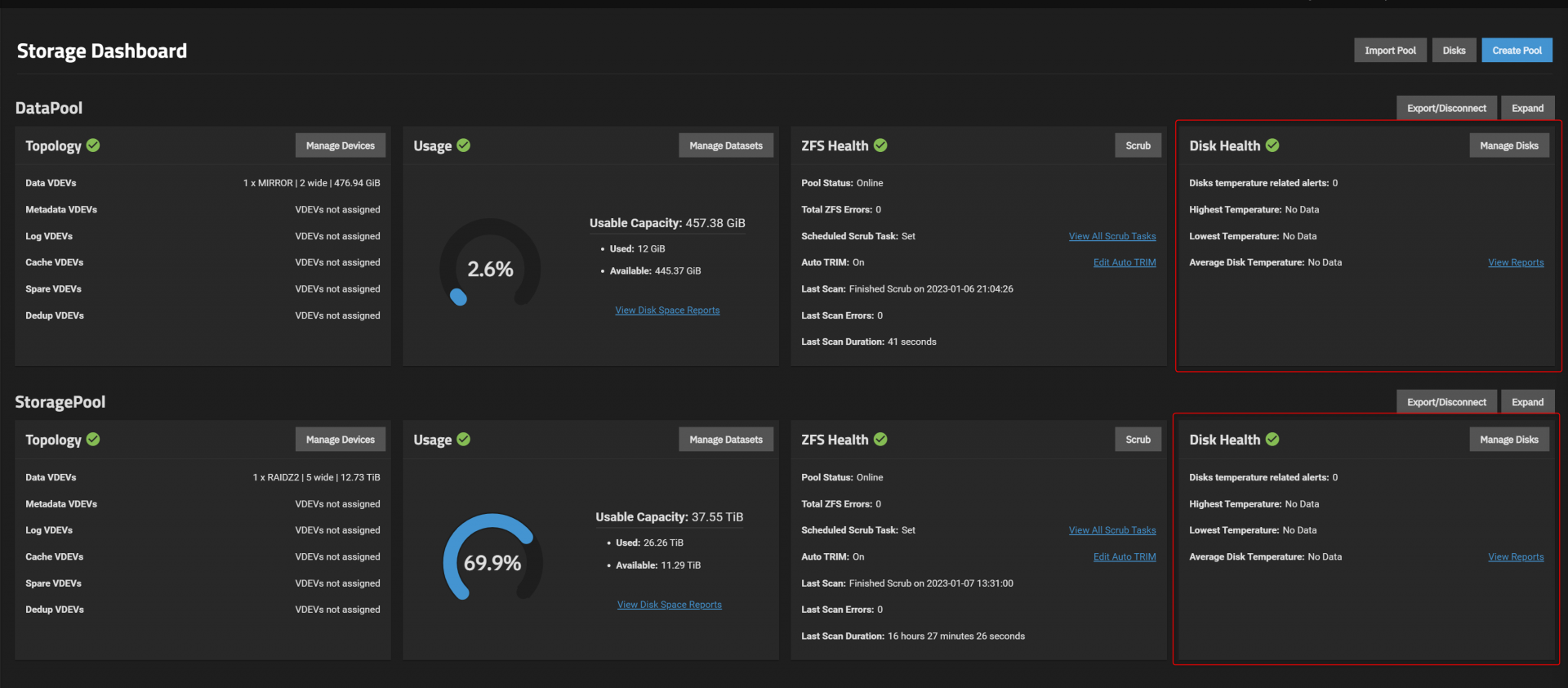

And my storage view

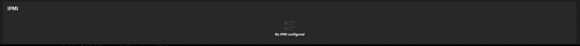

I also just noticed that my IPMI is no longer recognized (HP ILO4):
Really starting to think some drivers for the HPE DL380 Gen9 are not included in the linux image :)

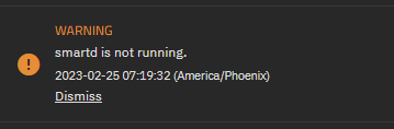

I am having exactly the same problem(s) with a fresh install of SCALE 22.12.0 on a DL380 Gen9. The S.M.A.R.T service (smartmontools.service) will not start as the /etc/smartd.conf file is empty. Trying to add proper contents to the file manually simply results with it getting overwritten with an empty file when trying to start the service. Additionally IPMI does not show up in webUI but "ipmitool sensors" form the shell works fine.

    args = args + ["-d", "cciss,0"]
    return args
I then restarted the middlewared service(systemctl status middlewared), and I now have a fully populated /etc/smartd.conf file and am able to start the SMART services.
Still no clue why IPMI is not being detected.

I have the same error.
I am running TrueNAS-SCALE-22.12.1. I noticed this warning message only after upgraded to Bluefin and recent update to 22.12.1 didn't help.
I have a PC/Desktop type hardware, my CPU Alder Lake Core i5-12600K, 64GB DDR4, Nvme boot drive, and use on motherboard SATA ports connecting 4 WD 12TB WD Red Plus NAS internal HDD running ZFS. The motherboard model is GIGABYTE Z690 UD AX DDR4 (LGA 1700/ Intel Z690/ ATX/ DDR4/ Triple M.2/ PCIe 5.0/ USB 3.2 Gen2X2/ Type-C/WiFi 6/2.5GbE LAN/Motherboard).
Hope someone can point me to whether this warning is serious and what can I do to address it, thanks!
