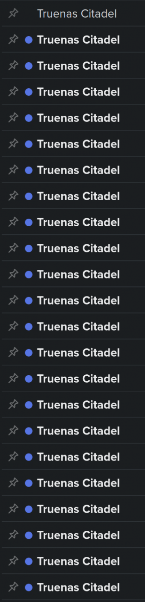

Over the past few days I've been getting this alert sporadically, and then today the flood gates opened and over 70 emails have poured in. I tried running `systemctl restart smartd` but that didn't seem to help.
I'd appreciate any assistance troubleshooting!
