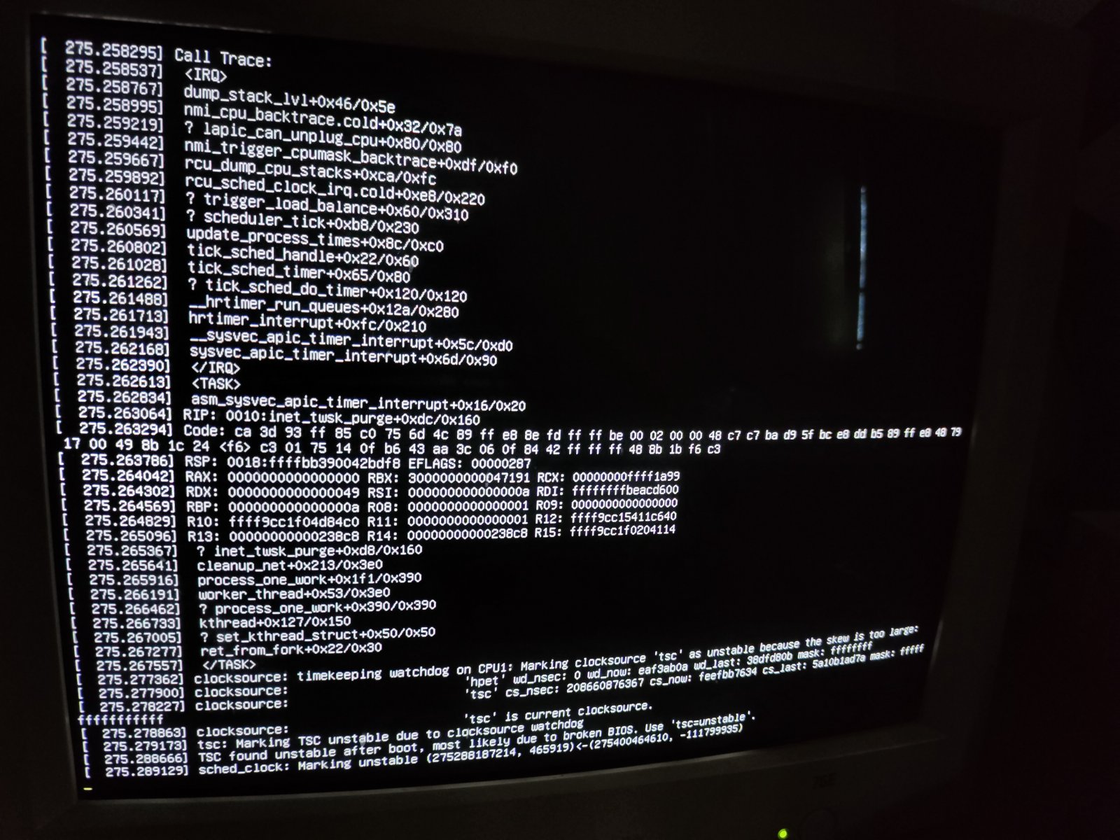

BUT THEN i came to look back up 15m ago to see how it went and well... This popped off:
I'm thinking of reinstalling the BIOS for this mobo in case it got an update but at this point I'm not sure what's the issue here, and if it is indeed the mobo being faulty i would end up with a nice $300 unstable piece of server
I'm also attaching the IPMI event log as afaik the BIOS event log should describe a reboot of the system, and there are unknowns that have the same description, but i don't know what they mean.
Again any help whatsoever is greatly appreciated.

Well you didn't post the log (I do that all the time) but I would definitely check BIOS updates, and, look at all the powersaving options in the BIOS. I would definitely add the tsc=unstable to kernel boot options. I believe you will find that will fix it. Most reports seem to be Ryzen.
Something like this should do it:
midclt call system.advanced.update '{"kernel_extra_options": "tsc=unstable"}'

Oh yeah sorry i did attach the log file but in between me sending the message the website gave me 502 and forgot to save it. Anyway here's the file.
Also I've completely restored everything to base settings, bios, reinstalled latest Truenas Scale on another ssd, restored main config and dataset, and it still froze. Now I've added the kernel option for tsc unstable and I'll see how it goes.

I don't recall if that's a bug with debian, the kernel driver, or the "bios". Hopefully you rebooted after applying the option. SHOULD be fine. Would love to hear back though in a few days.
