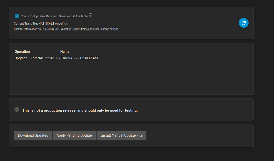

I didnt know about this thread. Anyway, same issue from 22.02.0. I get a update notification for 22.02.RELEASE, but fails to upgrade due to downgrade.

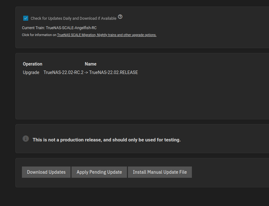

I'm facing the same issue as f3_. I installed Truenas SCALE RC2 a few weeks ago and upgraded today using the UI.
After the upgrade I'm presented with another upgrade, but it fails with
Error: [EFAULT] Unable to downgrade from 22.02.0 to 22.02.RELEASE
I rolled back to RC2 to double check which version it was installing and interestingly my RC2 upgrade screen looks like sybreeder's.
But after applying this upgrade and rebooting, I'm presented with another upgrade that looks like:
And then results in the error.
It feels like the ".RELEASE" part of the version number is missing somewhere and that's why the system thinks there is another upgrade.

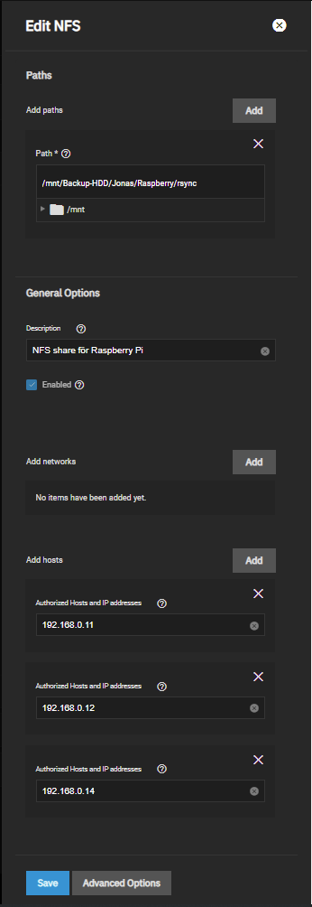

I was not able to get my NFS share working on 22.02.0, I am no expert but I checked what I could to get it working.
My share is simple, just one folder shared for my raspberry pi with access from it's IPs
I upgraded from TrueNAS-SCALE-22.02-RC.2 and all was working there.
Once in 22.02.0 I checked that my /etc/exports existed and they did, also with my knowledge they looked correctly configured (I have no log of this but if needed I can boot back to 22.02.0 to collect info)
I tried everything I could think of, reboot, disable / enable NFS service, edited the NFS share but nothing helped, every time I tried to mount it I got the following error
root@raspberrypi:/# mount -v -t nfs 192.168.0.77:/mnt/Backup-HDD/Jonas/Raspberry/rsync /mnt/truenas/
mount.nfs: timeout set for Tue Mar 1 11:13:57 2022
mount.nfs: trying text-based options 'vers=4.2,addr=192.168.0.77,clientaddr=192.168.0.12'
mount.nfs: mount(2): Permission denied
mount.nfs: access denied by server while mounting 192.168.0.77:/mnt/Backup-HDD/Jonas/Raspberry/rsync
Once I had done all I could with my knowledge I rebooted my Truenas back to TrueNAS-SCALE-22.02-RC.2 and then all started to work as before. I can if needed go back to 22.02.0 to help and try to solve this, my environment is just for home use so no critical uptime or anything in the way to help out.
Feb 23, 2022
3
I think that 22.02.0 and 22.02.RELEASE are same version.
