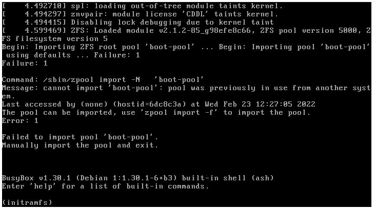

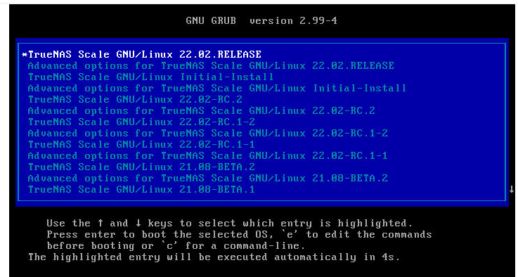

Thanks for the offer. I tried to switch back to RELEASE - unfortunately now I can't get anything to work anymore.
In this screen neither my USB keyboard nor my IPMI-Remote-Console can interact with the grub menu (keyboard strokes are ignored)
and after that I end in:
a force mount succeeds, but it doesn't continue on exit.
I guess I should just reinstall and restore from the truenas backup I created before the update to release? Or is there any hint what I could do in such a situation?
UPDATE: Nevermind - I could boot it up after I tried it a second or third time importing the boot-pool with "import -f boot-pool" and exiting afterwards. I'd say I didn't do anything different (which I know is said to be a first sign of madness, but it worked).

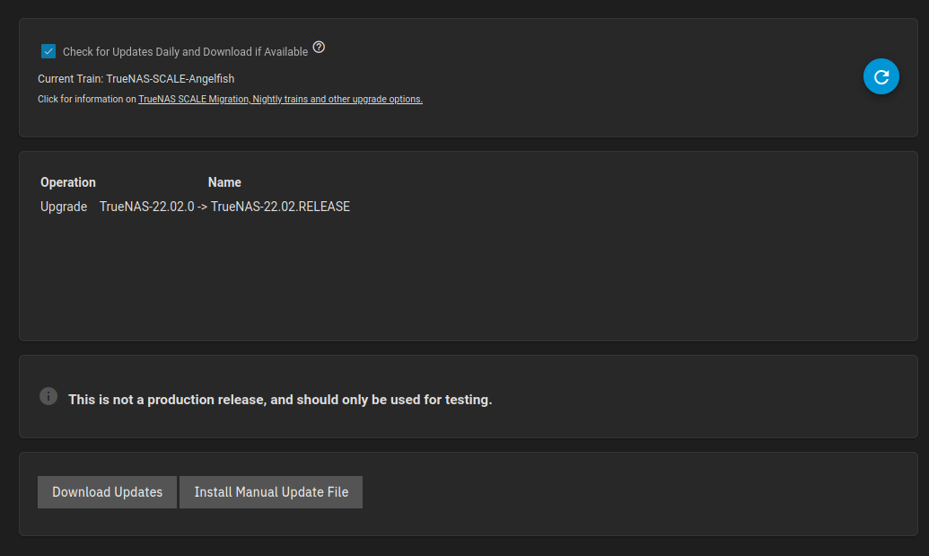

After fresh install TrueNAS SCALE 22.02.0 (Angelfish) Release i have this message to update. Why? iso 8ab1cb587ac03e6b8f3688c07863b8746a009bed26c40b104a005bd1f06e47cd isn't release or what? Why i got
I can confirm this behavior running as a VM under VBox on top of FreeBSD 12.3

weird issue after upgrading from RC2
The release notes for 22.02.0 are being updated and we should hopefully have the known issue posted soon. This is an empty update notification that is coming from a bug in the backend update train. This notification can be ignored and is being resolved in SCALE 22.02.1.
Magnus33
May 5, 2013
429
In terms of bugs this about as minor as it gets and everything else seems to be functioning correctly.
