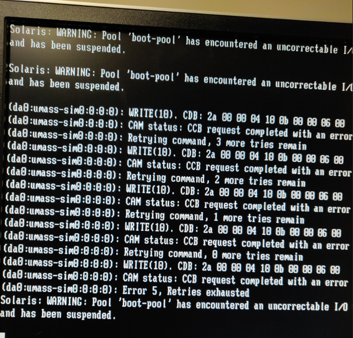

Hello
I managed to install Truenas on the Sandisk USB key, but after a few times I received this error message:
My hardware :
CPU : i7 930 socket 1366
Motherboard : Asus p6x58d-e
Memory : 14gig
USB key : SanDisk SDCZ430-128G
My NAS is not responding on usb key...
I tried 2-3 times and it's always the same result on the USB key.
I installed Truenas on a Kingston 256 gig SSD hard drive (sata) and everything works and remains stable.
I check the BIOS option and found nothing.
Thx for your help
Redcoat
Feb 18, 2014
2,922
Welcome to the forums!
USB's are known to have short life as boot drives for FreeNAS/TrueNAS which is why they are no longer recommended. You found the solution with your SSD boot drive. A search here will confirm...

Understood, but if your USB key doesn't work then you need to consider the alternative. If you search here you will find this issue discussed and debated ad-nauseam. Your solution is to get an HBA and free up mainboard sata port(s).
Redcoat
Feb 18, 2014
2,922
BTW - USB2 keys have a better history than USB3 - try a USB2 port if you have one. YMMV.

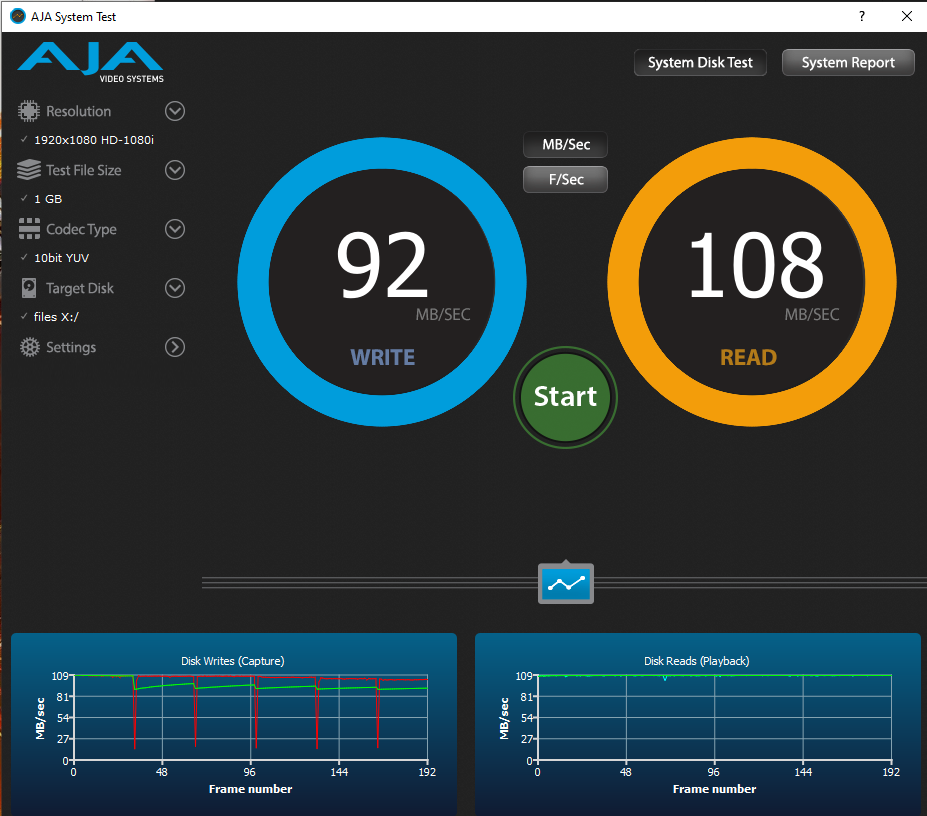

I change the onboard nic for the new one
2 ports gig : 82576-2T-X1(E1G42ET)(Intel-1pc) (CA)
I test the smb speed after ... its seem more fast ... maybe 10mbits more
