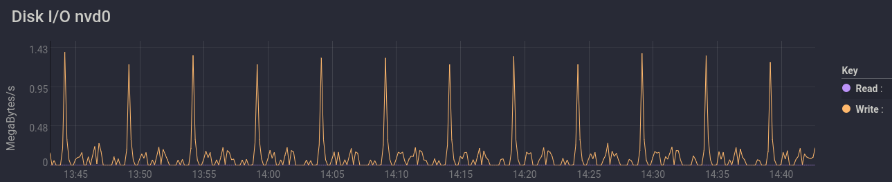

I share this frustration. It's all because of the System Dataset, really, as you can see the writes to the boot device are nearly zero, and very rare once you relocate the System Dataset to another pool (either the data pool or a spare SSD.) The constant "clicks" during idle periods that users hear on their spinning HDDs goes away once they remove the System Dataset from said data pool.
Perhaps someone can better explain why the System Dataset needs persistent storage (and constant writes every 5 minutes during a period of inactivity), rather than living in RAM for longer periods of time between writes?
The above "EKG pattern" of spikes every five minutes is during a period of inactivity. Nothing is streaming. No SMB shares are being used. No scrubs are being done. Why can't this activity remain in RAM indefinitely or at least for prolonged periods? Why the need to constantly write to the disk?
Correct me if I'm wrong, but if I "lose" my System Dataset, and reboot, won't I still have all of my configurations, SMB shares, etc, and a new System Dataset will be created from scratch? If that's the case, it can't be that critical to have to write to it (on disk) every 5 minutes?
The system dataset is where syslogs are kept, and also where the Reporting graph data is stored.
