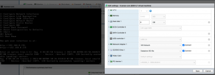

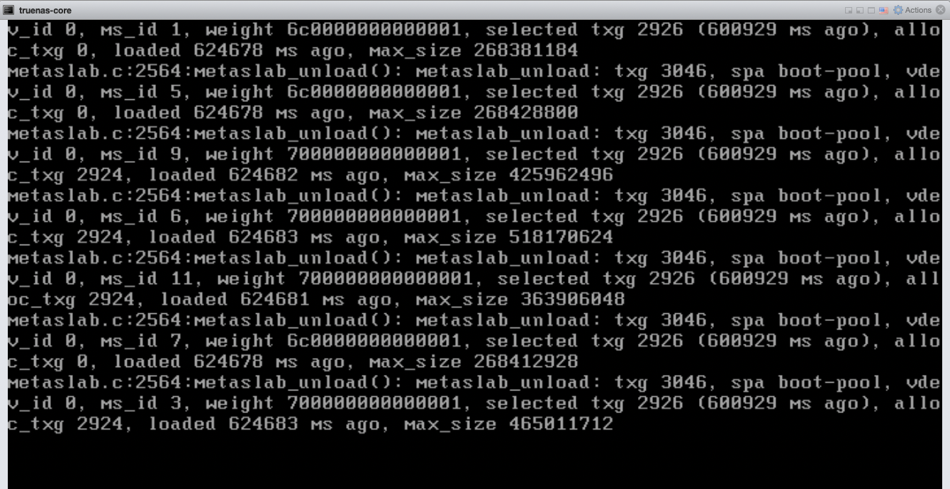

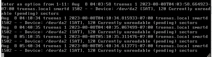

So created and I installed a truenas 13 on a new vm.
It booted and i imported the affected pool. all the backups of this truenas were either on the pool or on gdrive with i had to get rid of delete a few week ago since they changed their licensing.

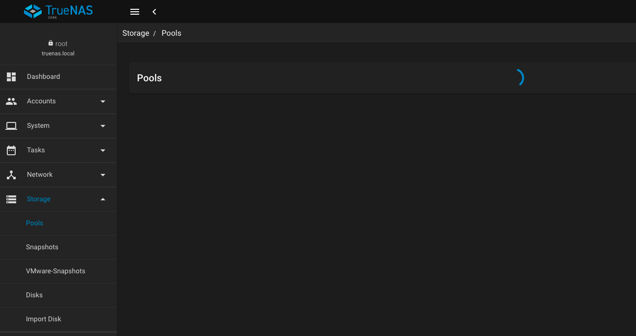

After importing the pool i still cant access the pool or disk info either via console or via Webui. It just shows loading. I have left it 30+ mins but still the same.
Should i leave it longer or does anyone else have any other suggestions?

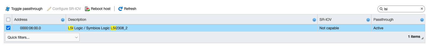

How are the pool disks arriving in the VM? is the HBA in PCIe passthrough?
Grinas
May 4, 2017
174
9,700
OK; that's relatively good news.
so can you see the disks?

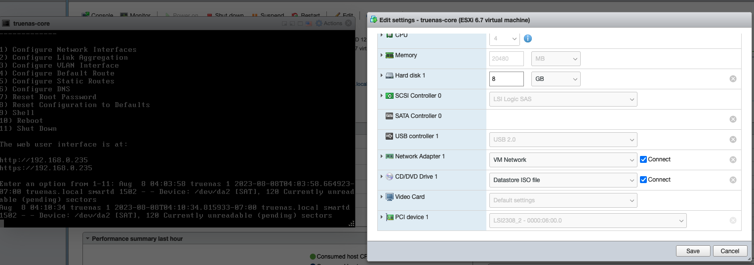

got a few errors about da2 having readable sectors in ESXI console too.
9,700
That's strange... if that's a disk in TrueNAS, and attached to the PCIe HBA which is in passthrough to the VM, ESXi can't see it.

When i say ESXI console i mean console of VM in ESXI so it is being seen by truenas VM.

Solaris: WARNING: Pool 'ThreeTBM' has encountered an uncorrectable I/O failure and has been suspended.
That does seem to not be your boot pool though, so it's not great news for the pool import.
I would of thought it would of least been able to tell me the problematic drives so i can try to switch them with the old degraded ones. Now i dont know what drives are good and whats not to create a new pool.
These are the errors i see on truenas vm console

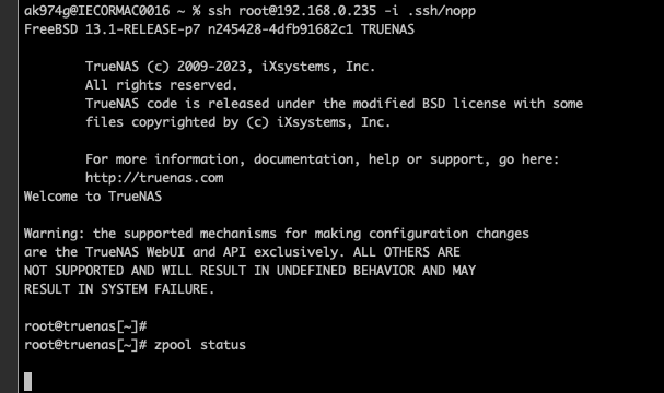

You should still be able to run zpool status and see something in that state (I would expect).
How about smartctl -a /dev/da3 (etc.)?
Grinas
May 4, 2017
174
10 minutes since i ran zpool status and zero output. Doesnt appear to have locked up as when i press enter it goes to new line.
smartctl -a /dev/da3 this does seem to work.

                    command.
                    Self-test supported.
                    No Conveyance Self-test supported.
SMART capabilities:            (0x0003)    Saves SMART data before entering
                    power-saving mode.
Error logging capability:        (0x01)    Error logging supported.
Short self-test routine
recommended polling time:      (   1) minutes.
Extended self-test routine
recommended polling time:      ( 378) minutes.
SCT capabilities:            (0x003d)    SCT Status supported.
                    SCT Data Table supported.
  1 Raw_Read_Error_Rate     0x000b   100   100   016    Pre-fail  Always       -       0
  2 Throughput_Performance  0x0005   139   139   054    Pre-fail  Offline      -       70
  3 Spin_Up_Time            0x0007   147   147   024    Pre-fail  Always       -       415 (Average 365)
  4 Start_Stop_Count        0x0012   100   100   000    Old_age   Always       -       591
  5 Reallocated_Sector_Ct   0x0033   094   094   005    Pre-fail  Always       -       276
  7 Seek_Error_Rate         0x000b   100   100   067    Pre-fail  Always       -       0
  8 Seek_Time_Performance   0x0005   124   124   020    Pre-fail  Offline      -       33
  9 Power_On_Hours          0x0012   092   092   000    Old_age   Always       -       61005
 10 Spin_Retry_Count        0x0013   100   100   060    Pre-fail  Always       -       0
 12 Power_Cycle_Count       0x0032   100   100   000    Old_age   Always       -       403
192 Power-Off_Retract_Count 0x0032   099   099   000    Old_age   Always       -       1341
193 Load_Cycle_Count        0x0012   099   099   000    Old_age   Always       -       1341
194 Temperature_Celsius     0x0002   171   171   000    Old_age   Always       -       35 (Min/Max 13/57)
196 Reallocated_Event_Count 0x0032   093   093   000    Old_age   Always       -       307
197 Current_Pending_Sector  0x0022   100   100   000    Old_age   Always       -       120
198 Offline_Uncorrectable   0x0008   100   100   000    Old_age   Offline      -       0
199 UDMA_CRC_Error_Count    0x000a   200   200   000    Old_age   Always       -       1102
SMART Error Log Version: 1
ATA Error Count: 1153 (device log contains only the most recent five errors)
    CR = Command Register [HEX]
    FR = Features Register [HEX]
    SC = Sector Count Register [HEX]
    SN = Sector Number Register [HEX]
    CL = Cylinder Low Register [HEX]
    CH = Cylinder High Register [HEX]
    DH = Device/Head Register [HEX]
    DC = Device Command Register [HEX]
    ER = Error register [HEX]
    ST = Status register [HEX]
Powered_Up_Time is measured from power on, and printed as
DDd+hh:mm:SS.sss where DD=days, hh=hours, mm=minutes,
SS=sec, and sss=millisec. It "wraps" after 49.710 days.

Disk da2 is gone so ill see if i can replace that with another drive and if that solves it. Unfortunelly this ESXI host runs my firewall/router and another few things that i need for day to day usage so not the most convenient thing to reboot.
9,700
Only 3 disks with no errors in SMART... that's possibly involved here.
I see Multi-zone and read errors.
da2 is certainly the worst impacted and I suspect may be the one stopping everything with timeouts... can you get it to run without that drive connected?

Tried to shutdown Vm but it was stuck after 30+ mins so had to power it off in ESXI and then shut down host and removed that drive and replaced with a spare.
Seems new truenas vm is very slow to boot or wont boot like the other one as been waiting 20+ minutes for ssh and UI to respond.
these are the errors i get in truenas console in ESXI.
9,700
Looks like your boot pool is in trouble again...
