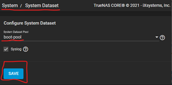

@Hans Otto Lunde , i had the same issue with my Truenas mini X+ and it was driving me absolutely nuts.
In my case, the sound was produced when the "System Dataset" was writing the "Syslog" information which happens every 5 seconds or so.
By default, Truenas installs the “System Dataset” in the same pool as the first dataset. As a solution, one could move the “System Dataset” to the boot pool which is installed on an SSD with no moving parts.
Go to System-->System Dataset, under System Dataset Pool select the “boot-Pool” and click “save”.
Now my system is almost silent (you can still hear the fan noise from time to time but that is normal and expected).
