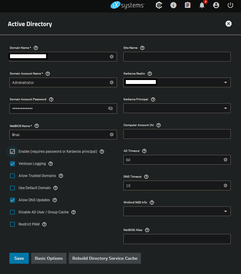

Also attached a screenshot of advanced settings. There is nothing in syslog about any errors for when it either faults or just disables.
