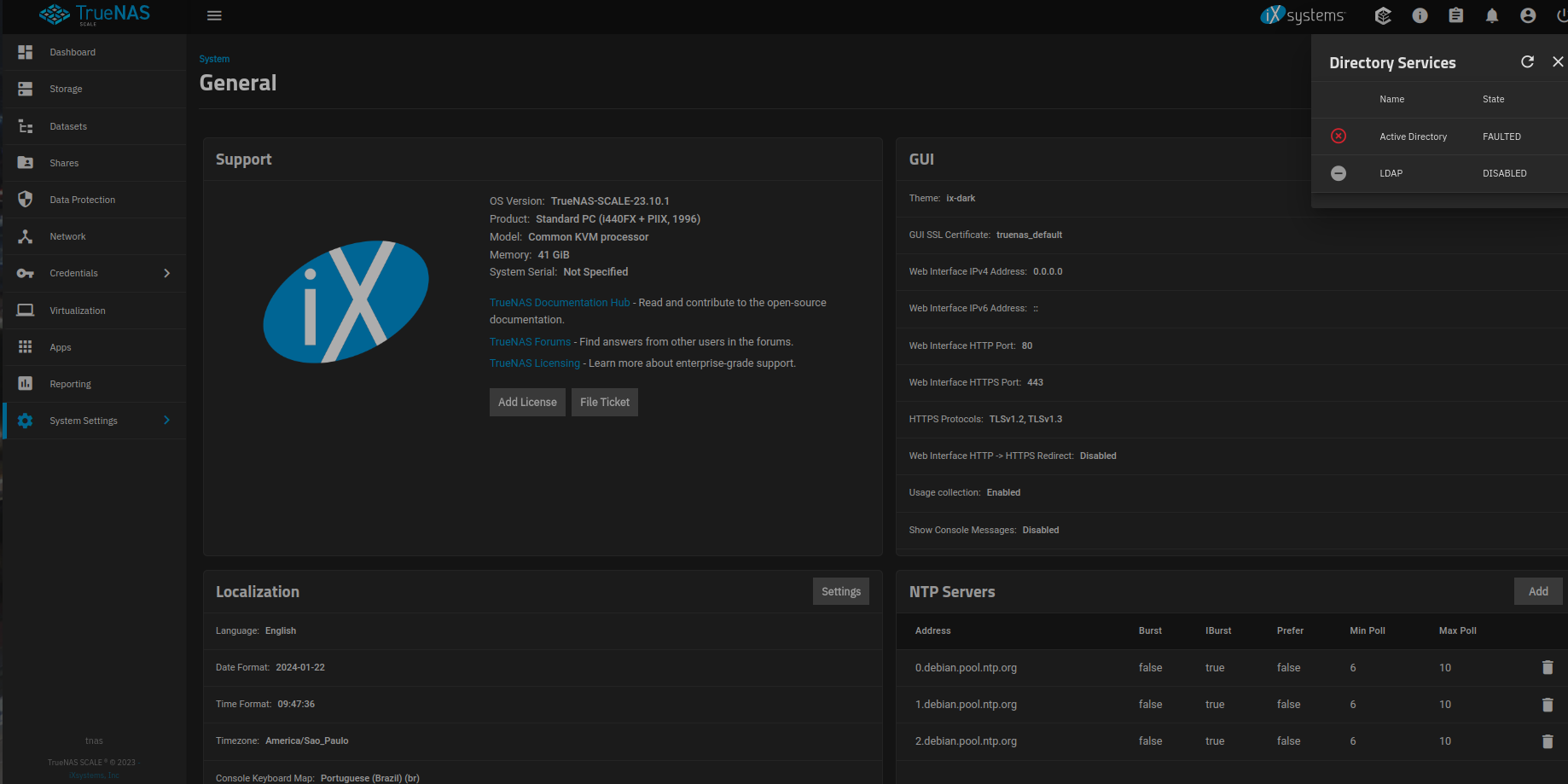

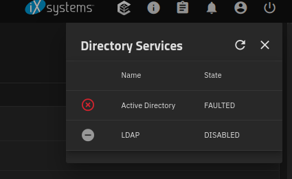

There is an issue with Active Directory authentication, and the details are as follows:
Attempt to connect to the netlogon share failed with error: [EINVAL]. The Active Directory service is automatically disabled due to an invalid configuration.
2024-01-22 09:41:01 (America/Sao_Paulo) Re-Open
Steps to reproduce:

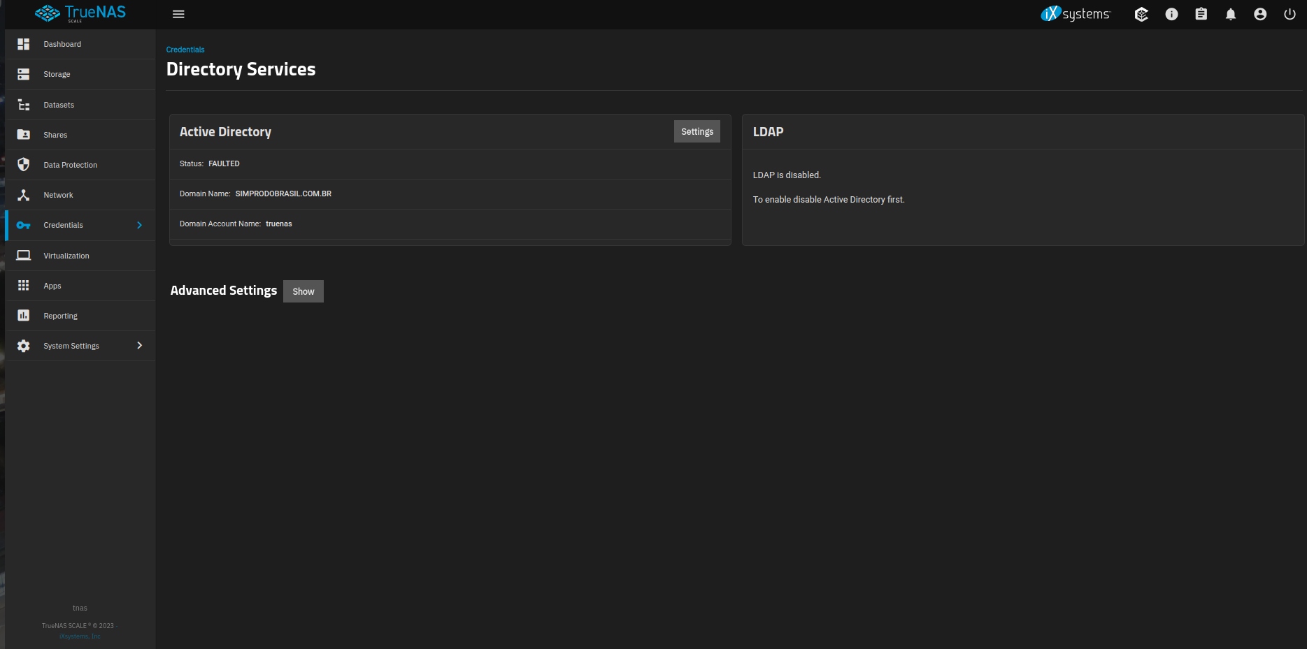

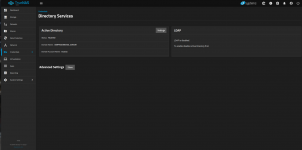

1)After updating from version 23.10 to 23.10.1, the directory service appears to stop working (see attached screenshot).
2) After entering the password in Credentials > Directory Services and checking the enable box, everything works for a few minutes and then crashes again.
3) If the system is restarted after step 2, the error occurs again. The system stops directory services as shown in the attached screenshot.
This is very frustrating because my shares only work via Active Directory running on SMB policies.
Steps to reproduce:
Please PM me a debug.
nativ0
Apr 27, 2023
3
I followed the thread that razexzzz posted a few years ago, and it worked. I left the domain with valid credentials and then re-entered the domain. So far it is holding on. If crashes again, I send you the debug file. tnx a lot .
