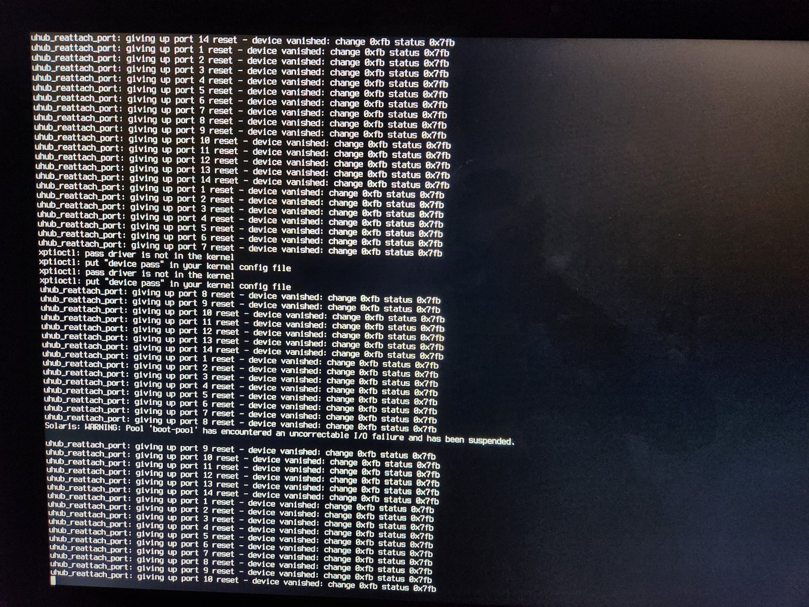

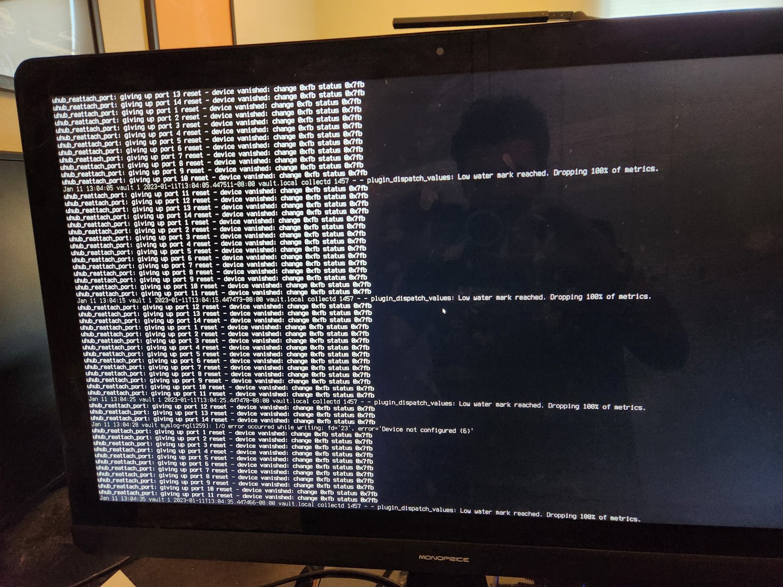

The problem will usually start within a 24 hour period of a reboot.
When the problem occurs, TrueNAS becomes unresponsive. I am unable to see it on the network, the web UI does not connect, you can't reach the login page. Attaching a monitor to the physical box, I see the following cascade of error messages in the console and the console is unresponsive to the keyboard:
uhub_reattach_port: giving up port 13 reset - device vanished: change 0xfb status 0x7fb
uhub_reattach_port: giving up port 14 reset - device vanished: change 0xfb status 0x7fb
uhub_reattach_port: giving up port 1 reset - device vanished: change 0xfb status 0x7fb
uhub_reattach_port: giving up port 2 reset - device vanished: change 0xfb status 0x7fb
uhub_reattach_port: giving up port 3 reset - device vanished: change 0xfb status 0x7fb
uhub_reattach_port: giving up port 4 reset - device vanished: change 0xfb status 0x7fb
uhub_reattach_port: giving up port 5 reset - device vanished: change 0xfb status 0x7fb
uhub_reattach_port: giving up port 6 reset - device vanished: change 0xfb status 0x7fb
uhub_reattach_port: giving up port 7 reset - device vanished: change 0xfb status 0x7fb
uhub_reattach_port: giving up port 8 reset - device vanished: change 0xfb status 0x7fb
uhub_reattach_port: giving up port 9 reset - device vanished: change 0xfb status 0x7fb
uhub_reattach_port: giving up port 10 reset - device vanished: change 0xfb status 0x7fb
Jan 11 13:04:05 vault 1 2023-01-11T13:04:05.447511-08:00 vault.local collectd 1457 - - plugin_dispatch_values: Low water mark reached. Dropping 100% of metrics.
Please see 'console-image.jpg' attached for more context. I would supply the full text but it's not captured in the /var/log files.

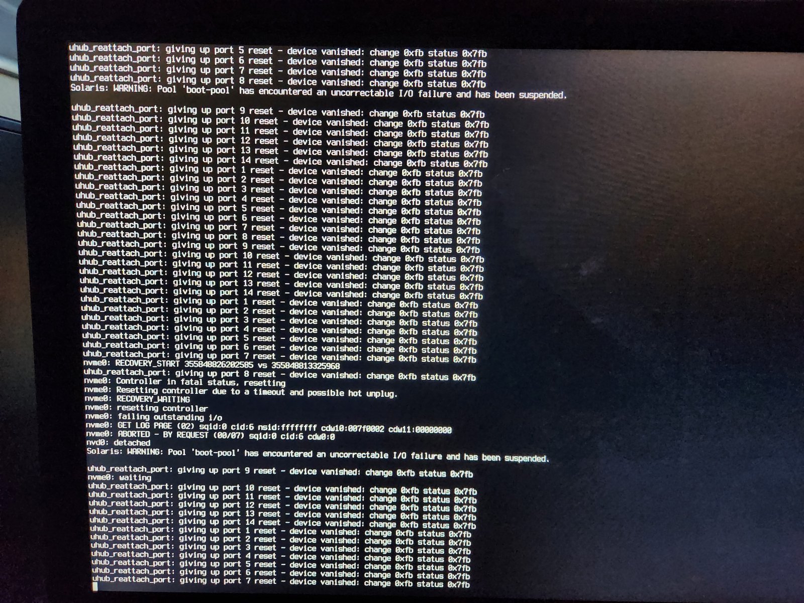

Bad news, it bailed again. Good news though is I managed to catch it as it happened (or very shortly afterwards) which gave me access to some new error messages I hadn't caught before (please see comprehensive console log in screenshots):
Some entries of note:
xptioctl: pass driver is not in the kernel
xptioctl: put "device pass" in your kernel config file
Solaris: WARNING: Pool 'boot-pool' has encountered an uncorrectable I/O failure and has been suspended
nvme0: Controller in fatal status, resetting
nvme0: Resetting controller due to a timeout and possible hot unplug.
nvme0: RECOVERY_WAITING
nvme0: resetting controller
nvme0: failing outstanding i/o
nvd0: detached
nvme0 = Intel Optane Memory H10 32GB with SSD Solid State Storage 512GB HBRPEKNX0202AC
nvd0 = apparently nvme0 by a different name?
boot-pool is on ada04

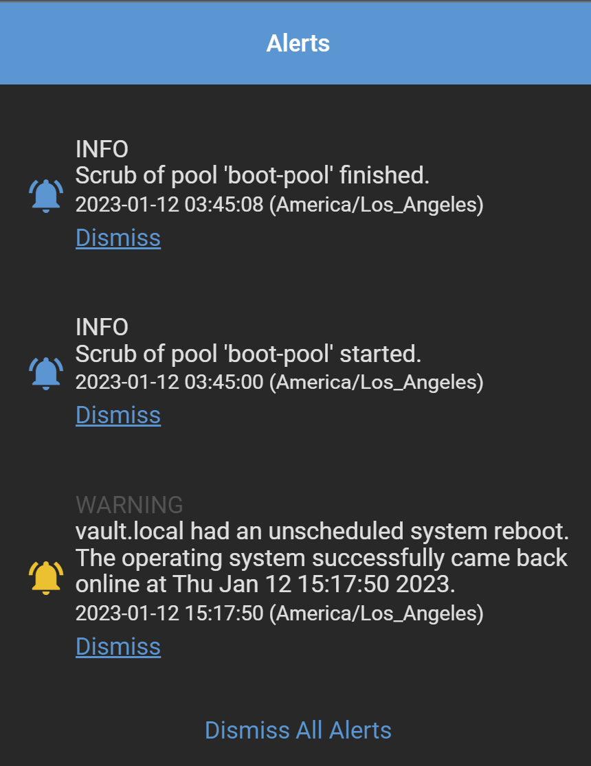

Attached screenshot of the notifications after hard restart.
Attached smartctl results for each storage disk, they are all marked passed.
For context, I wasn't doing any heavy load on the truenas when this occurred, it had been awhile since I had done anything with it, and I had just created a few folders on my samba share before it went belly up.
From what I can gather, it looks like both the boot-pool (ada4) and and the cache (nvme) are disconnecting and being put into a fatal/suspended status? A few thoughts:
  • I could potentially simplify the pool by yanking the nvme0 and see if the problem resides with that nvme or the m.2 slot it's plugged into.
  • I saw some similar error messages in the forums searching for the xptioctl messages mentioning potentially a bad cable (though their issue looked more like a drive problem). When I moved the boot drive off the SilverStone Technology ECS07, I changed the cable at that time, so that seems unlikely.

The nvme driver deals with talking to the SSD. The nvd driver provides access to the SSD's NVMe namespaces in a similar way to other drivers wired up to GEOM, so that you can do the same things (software RAID without ZFS, etc.). The nda driver is also available as an alternative to nvd, and I think it bypasses GEOM for extra performance with fewer features.
An NVMe SSD will have one or more namespaces, think of them as partitions, SCSI LUNs, datasets, etc. Most consumer SSDs only support a single one, but enterprise SSDs often support multiple namespaces.
