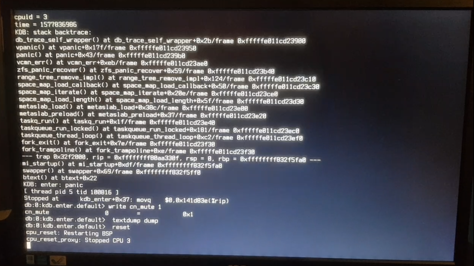

I was doing a file transfer and the server suddenly shutdown and was in a boot loop, i plugged in a hdmi and checked the console and it came up with this error, cpu_reset_proxy: Stopped CPU 1 and this number would change from 1 to 0 to 3 etc so it wasn't always the same number, also sometimes it would say this error too, 0 :kdb.enter.default> textdump dump then would reset. I installed a fresh install of Truenas several times, Unplugged the cpu, ram and drives then put them back in and the problem persisted, I've narrowed it down to my Raid Z1 pool because when I try to import the pool it shows that error and forces the machine into a constant reboot. The other pools i have managed to import fine with no problems. I need some advice on what this could be because I'm just a noob with this stuff and I'm at a loss here on if I have made a mistake somewhere or worst case scenario I've lost really important data. The Raid Z1 has 4x4TB IronWolf Pro Drives and they are still in their warranty, I have only had them for 1 year and 6 months so far. I'll write the specs and put pictures below, thankyou if you can help me in anyway.
The Version of Truenas it's running is 13.0 U4 and I did try to go back to 12.0 and still the same problem, but I don't know how to download/find older versions of Truenas.

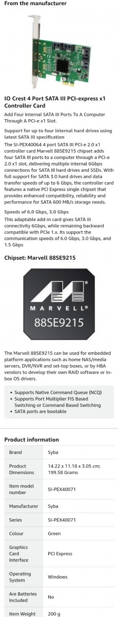

Yes it boots fine without all of the drives connected and only gives that error when the 10TB Raid Z1 is connected, it goes through the process of importing it then it just crashes and goes into a boot loop and gives me one of them two errors.

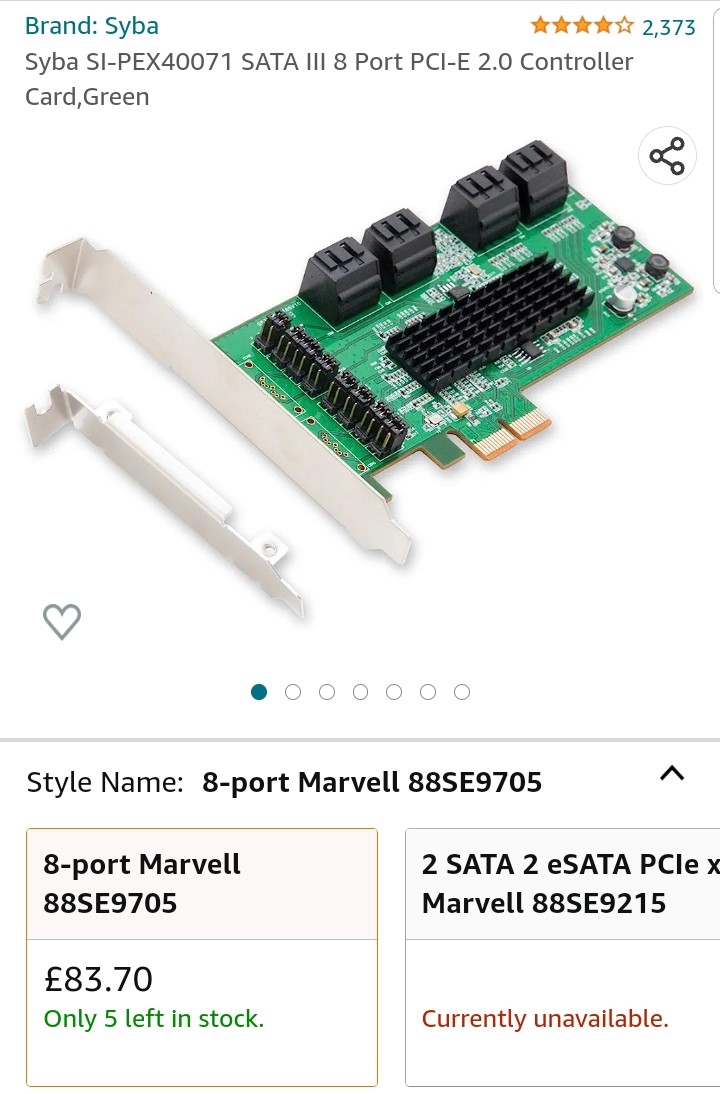

The Sata Card I have just posted pictures of it here.
Before I bought it i did some research on the best sata card to get and they said to get one with a marvell chip on it, they were the most reliable which yes i have seen that they can cause problems and so far until now it has been fine but a problem that i have always had with this server is that if i am transferring files constantly for more than 20 minutes one after the other it would often crash for some reason and im not sure why.

Well the best "SATA" card was not what you have there. There are very few SATA addin cards that work with ZFS
Something like ebay.co.uk Link would have been a much better idea - but do you have the slots for one? I don't think you do as you have an X16, an X4 and a largely useless X1
You could put the GPU into the X4 slot, depends on what you use the GPU for and put a proper HBA into the X16 slot. Use the HBA for HDD's and the ports on the motherboard for any SSD's you may have. What do you use the GPU for?

Marvel SATA chips are not well supported by TrueNAS Core (and also TrueNAS Scale). Only Intel embedded SATA controller work well. If you need more SATA/SAS ports then you should pick a supported HBA.
The best HBA for TrueNAS are
- LSI/Broadcom 9300 (with the SAS3008 chip that supports SAS3 12 Gbps) flashed in IT-mode with the 16.00.12.00 firmware https://www.truenas.com/community/resources/lsi-9300-xx-firmware-update.145/
- LSI SAS 2308 chip is older (6 Gbps) but it works also well if you connect only spinning disks. Typically IBM M1015
More recent Broadcom HBA like 9400 and 9500 series should work. But I have never tried them.

Yes, what i did was i took the SATA add in card out and moved the raid 10TB Z1 drives into the only 4 SATA ports on my motherboard and the same problem happened, yeah with the SATA card i did know about the SAS cards and stuff but it wasnt in my budget and i didn't know enough at the time. In the original post i said that the truenas version is 13.0 U4 and i tried an older 12.0 version. I have been using the gpu just for video since my cpu doesnt have graphics.
As far as i know i have the SATA card on the top PCIE port and the gpu at the bottom which i presume the top is x16 and the bottom is x4?
