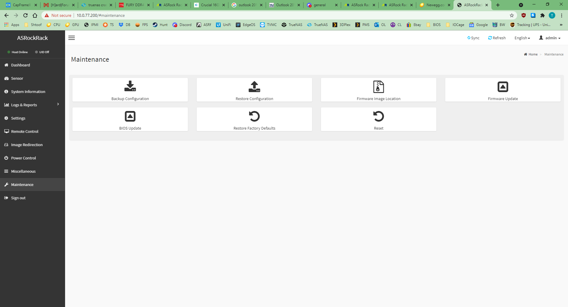

Did you update the BIOS/BMC yet?

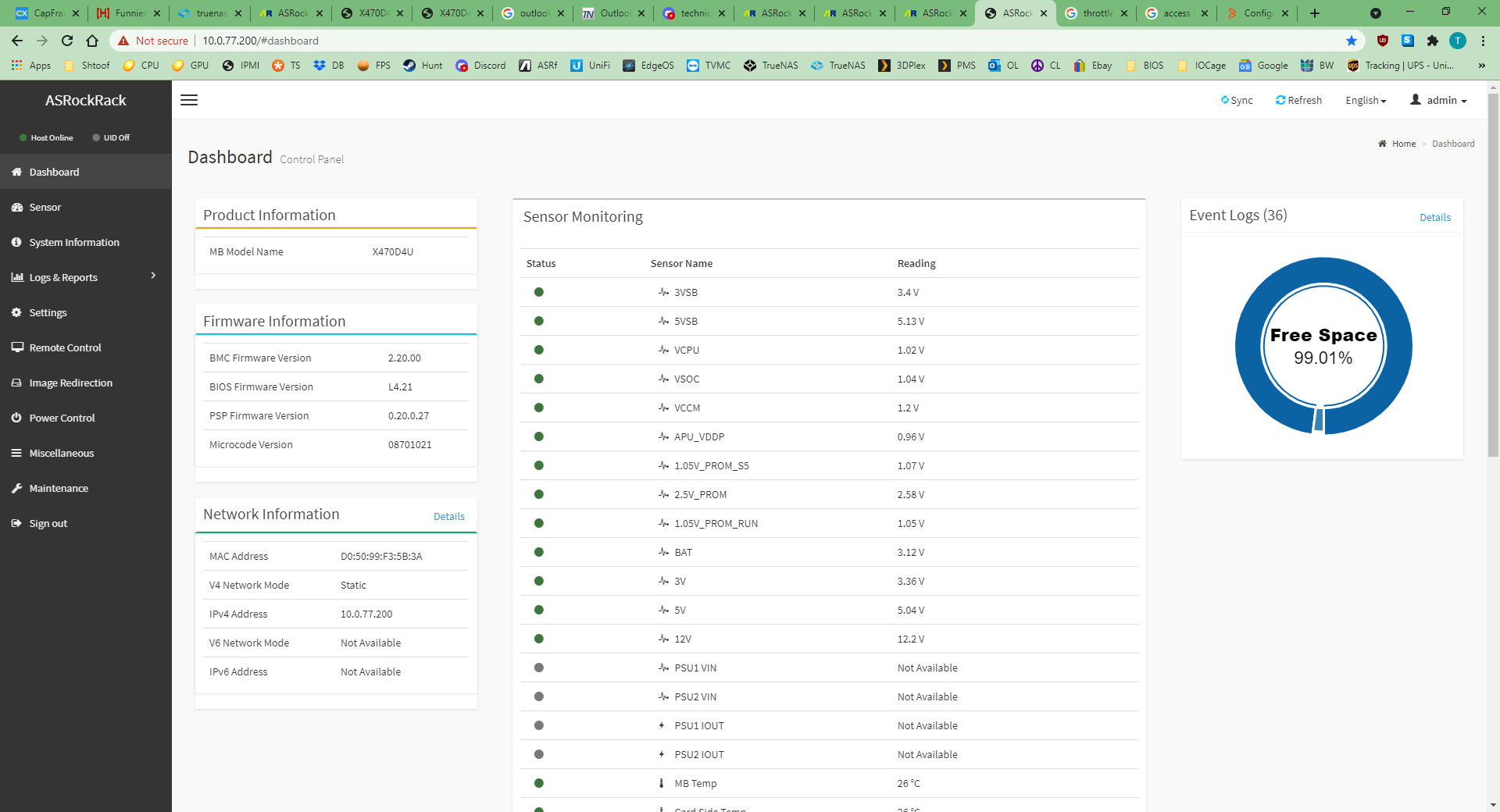

You "should" be able to access the IPMI dashboard via the Realtek dedicated NIC and it will tell you BIOS/BMC versions ..setup doesn't need to be running to do so

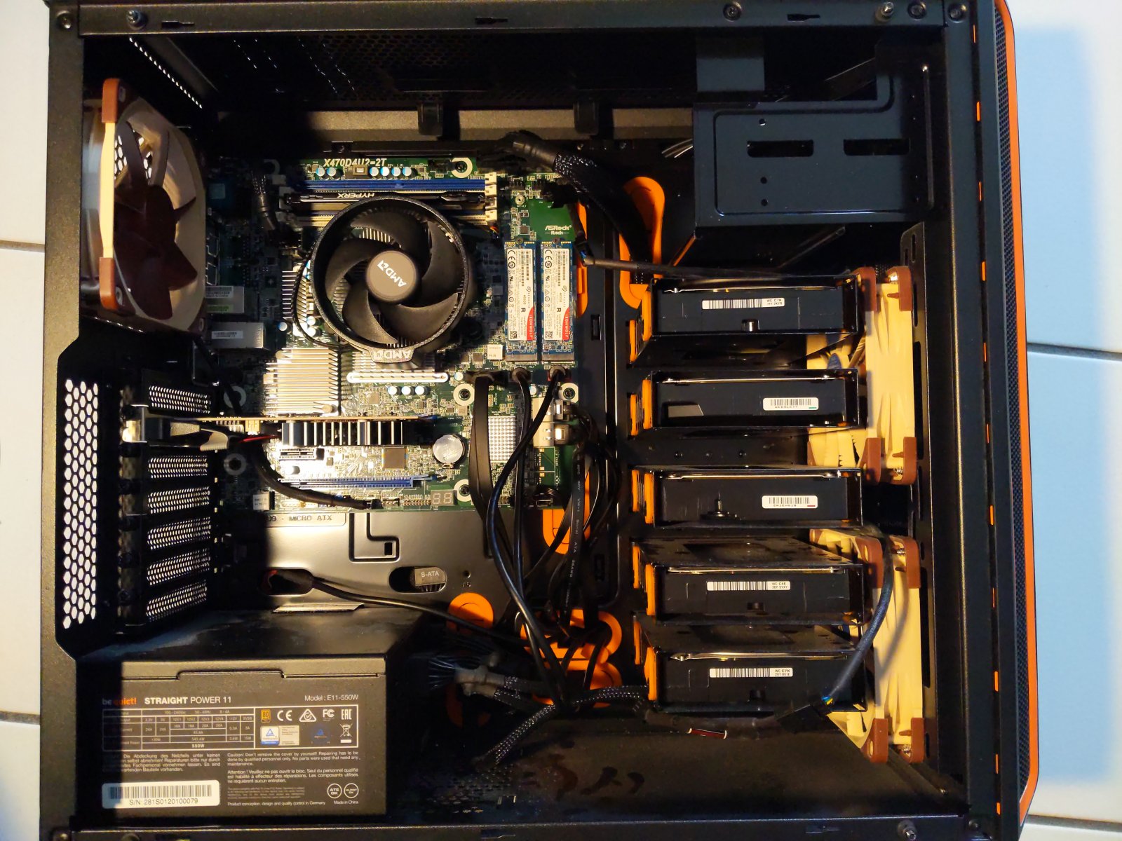

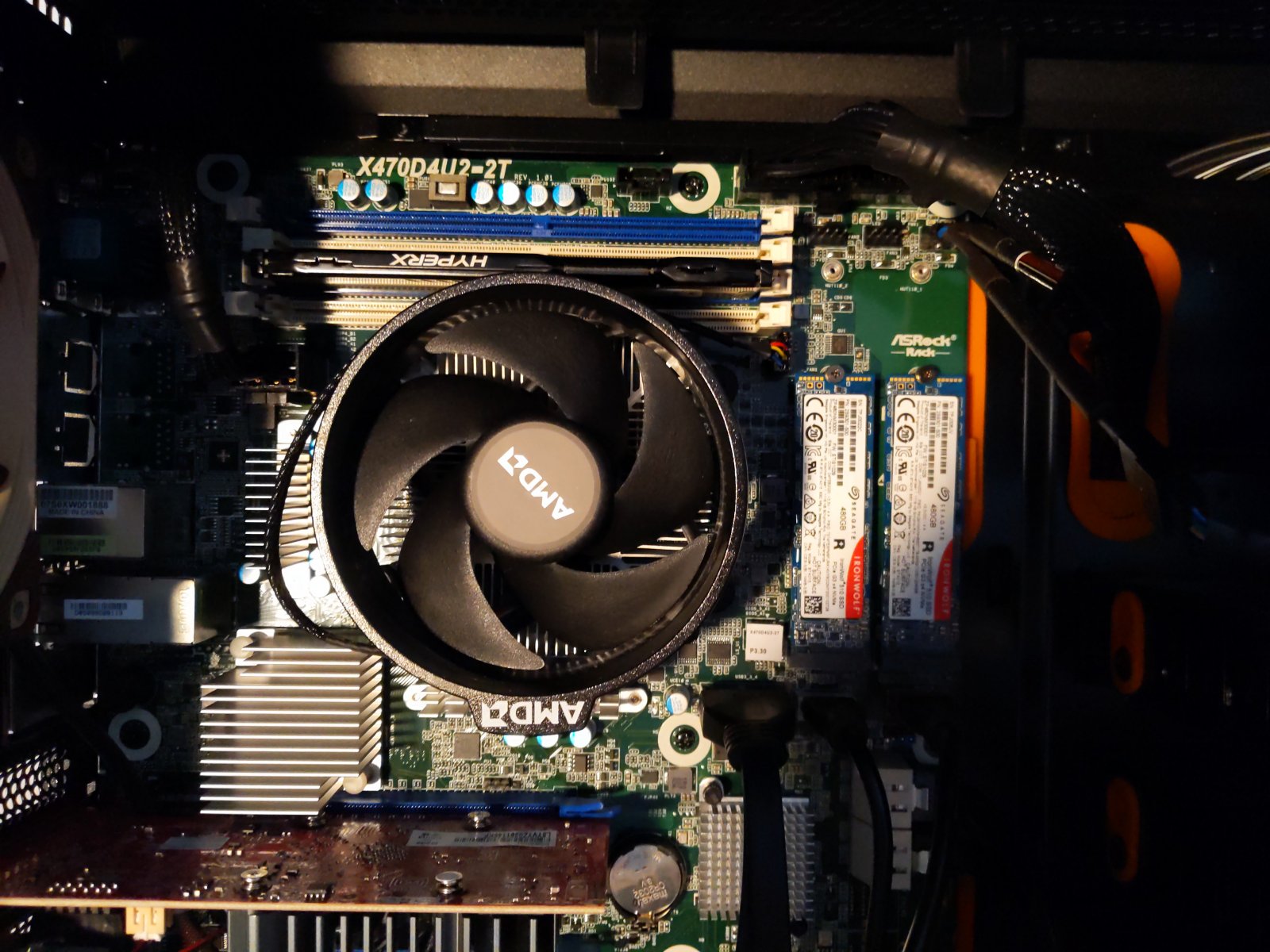

Hello, Here is a picture of my system so you can have a look if you notice anything out of place. I will need to change my cpu cooler because it covers one ram slot, but otherwise nothing really jumps at me.
ThreeDee
Jun 13, 2013
700
What's the video card for? The square Wraith cooler gives you room for that closest memory slot (at least on the X470D4U anyways).
The video card is just an asus i found, nothing fancy just enough to output a video signal ;)
I changed the cpu cooler, same error message, now i'm waiting for an ECC memory stick and i'll see if this solves the issue.
