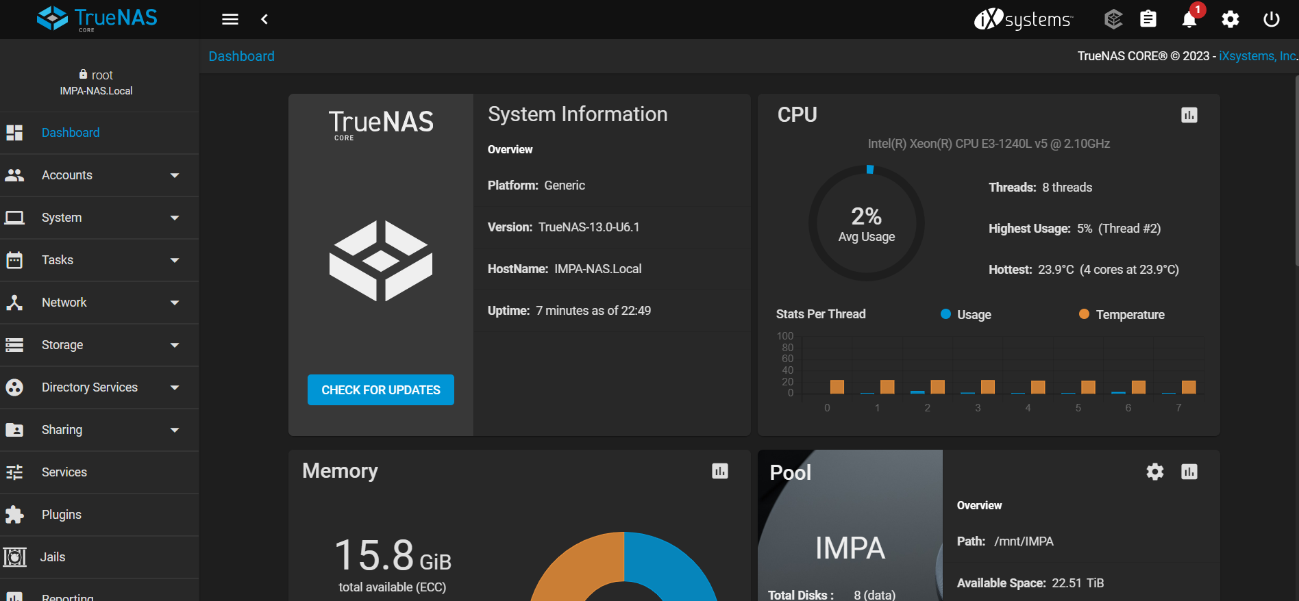

I don't know if my description is not accurate enough.
My production equipment is using the latest TrueNAS-13.0-U6.1
The truenas core in the virtual machine mentioned in the thread is a new test environment only used to test jail upgrades. It has nothing to do with the production environment.
There is only one device in the production environment from beginning to end. Running version TrueNAS-13.0-U6.1.
There are 6 jails in this production equipment. The versions of these jails are 12.1-RELEASE to 12.3-RELEASE.

My thoughts exactly. 我的想法完全正确。
I feel like I’m not a person who just comes to others for help when I have a problem.
Unless you really try it and it really doesn’t work.
