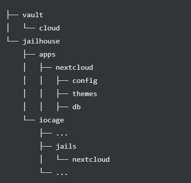

So I got this structure
If im right, i only need to create eg "nextcloud2" as a new jail and then copy all content from iocage/jails/nextcloud to iocage/jails/nextcloud2 ?
It seems like that this folder contains the basic jail config as well as fstab (mountpoints i guess) and the file system root?
Edit: Or without root? I feel a bit lost. Is the plan to fully setup a new jail including all stuff i need or is the plan to create an empty new jail, then wipe root and to place the existing config if my nextcloud into it?

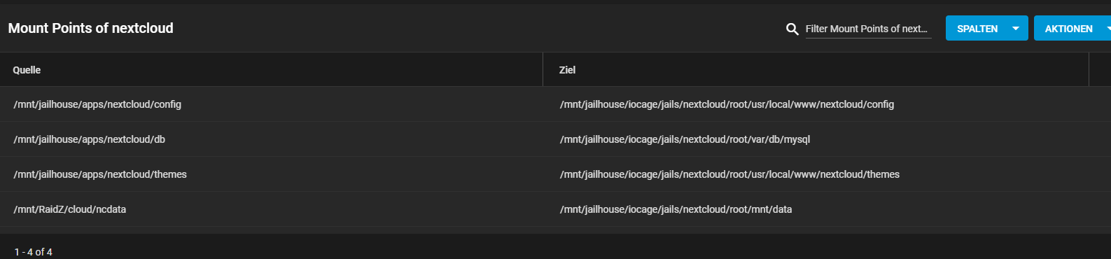

so far not, as far as i remember i get an error on that jail update for a long time now but it worked within 11.3 fine, im trying to setup a new nextcloud instance right now with same db and stuff as its mounted from outside
Krautmaster
Apr 10, 2017
81
ok fragt nicht wie aber ich habs hinbekommen über ein neues Jail dass ich von Grundauf neu eingerichtet hab mit selbem Mount zur DB und zu der NC Config. Dann hab ich NC20 installiert, Rechte neu vergeben, die bestehende DB ging aber ich musste das update via OCC von der Konsole machen. Nun läufts aber wieder. Passt. Danke euch.
Edit: lol seems like by fault i responded in German. Well. I got it to work by creating a new jail. As the Nextcloud data like config and db was already mapped from outside the jail, i was able to do a fresh NC setup, mounted the config and db dir, restart the jail, run a occ update via commandline and then it worked out pretty good.
