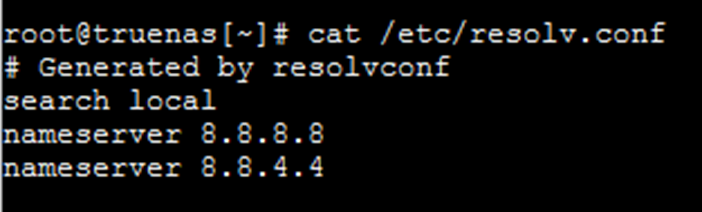

Can you post your /etc/resolv.conf
MarioH
Aug 4, 2020
13
Hi Nick,
this is the resolv.conf:
As said before, this were only some of the nameservers elaborated, furthermore a direct to 8.8.8.8 does not reveal any issues, so they are available and reachable for the server.

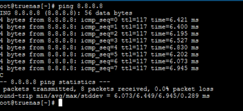

Let's try a couple troubleshooting steps (from the TrueNAS command line, post the output from each):
  1. ping 8.8.8.8
  2. dig www.google.com
  3. dig @8.8.8.8 www.google.com
MarioH

Here we go:
1.
2.
3.
BTW: I enjoyed regarding "The Math on Hard Drive Failure"
Nick2253
Apr 21, 2014
1,633
Ok, so it looks like something weird is going on. If I didn't know any better, I'd guess that a firewall is blocking traffic via port 53.

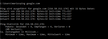

And I checked on the Windows PC:

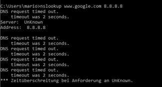

From the Windows PC, run: nslookup www.google.com 8.8.8.8
MarioH
Aug 4, 2020
13
Now it gets interesting:

Firewall/ISP blocking DNS requests unless they use a local recursive server? What DNS server does your Windows system use (ipconfig /all)? Why don't you configure this one for your TrueNAS, too?
MarioH
Aug 4, 2020
13
No blocking from FW/ ISP (as far as I understand :smile: )
The DNS-Server for Windows and TrueNAS are the very same.
