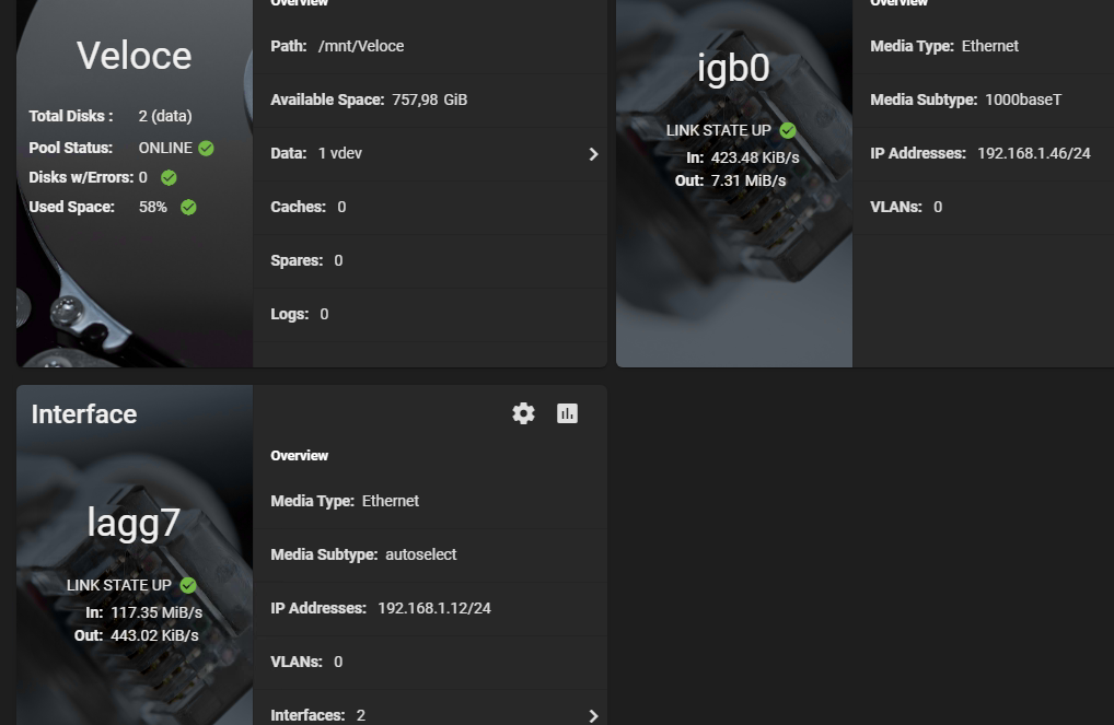

-Issue 1 I experienced the same problem. But I'm ALWAYS using two nics on the same subnet with a similar setup as yours. I don't know if it's a trick but here's what I do to be able to achieve it.
--Configure your LACP with a fixed ip address
--Enable the standalone nic with dhcp
here's proof:
1658464781957-png.57037
I don't understand this limitation and what trouble it's trying to prevent us from.
But anyway, maybe this solution will be patched away eventually
Just redid the same two days ago on TN 12.0-U8 and it just works.
-Issue 2 In the process, have you ever chose the Standalone nic (maybe by mistake ONCE) to be part of NIC team?
I had my share of cold sweat once when I tried to Reassign an adapter to standalone use after it was on lagg interface.
-- The issue was the MAC adresss mirroring that kept sticking to it.
--- Had to change manually the mac of the adapter(s)
--- Kick all network configs and redo it.
