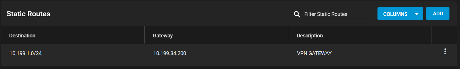

Hello, I am trying to host an OpenVPN Server on a machine running TrueNAS-13.0-U3.1.
I tried following along this tutorial, which mostly worked, until I tried accessing anything other than TrueNAS's web UI with its designated port.
My goal is for a client to be able to access other services running on the NAS and to establish SFTP connections with TrueNAS via the VPN.

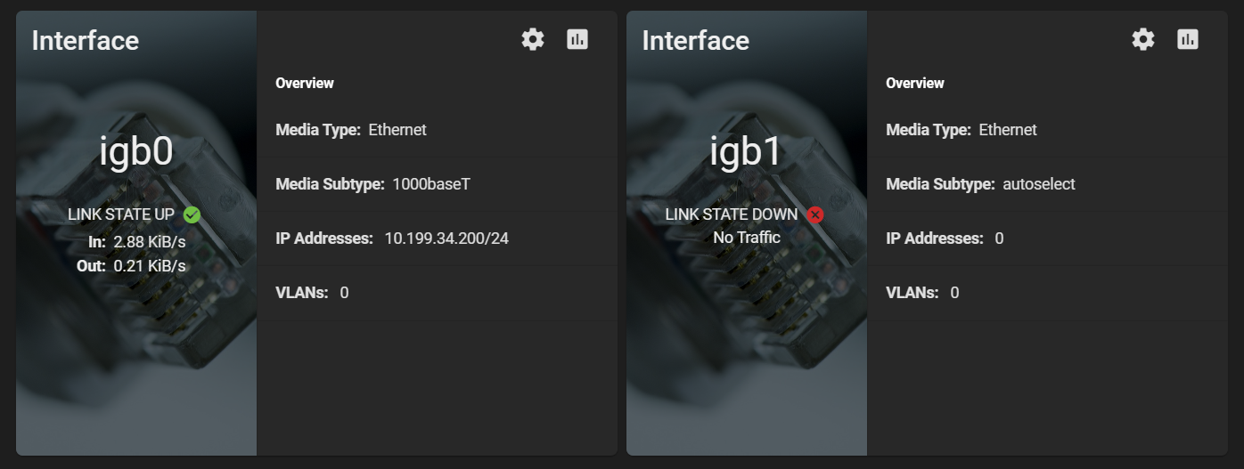

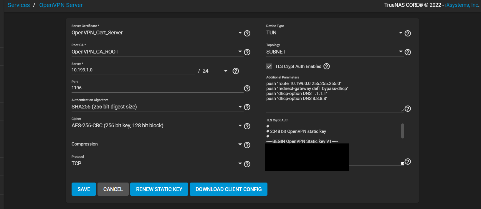

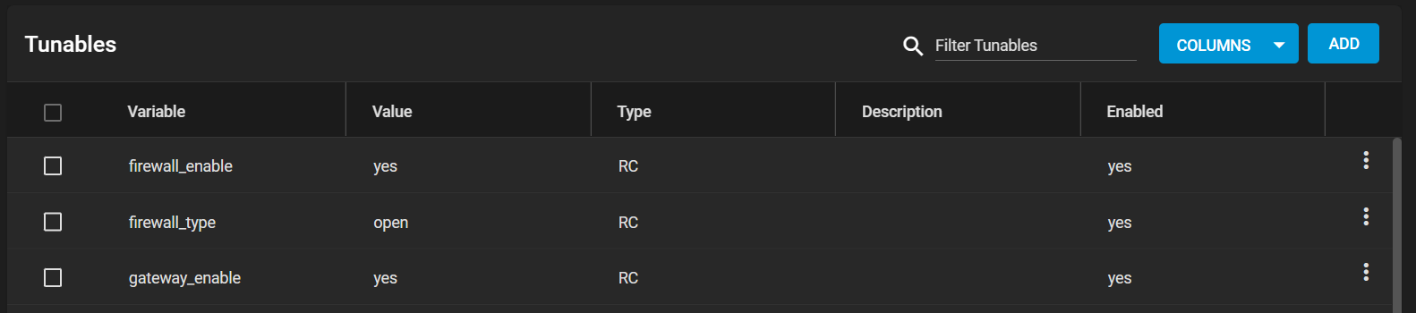

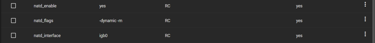

So yeah, that's my problem. When I try to access anything that is not TrueNAS's web UI, it just doesn't work; not even other things which are on the same IP but on different ports, below are screenshots with everything that might be relevant to my problem.

Hello,
is your Subnet 10.199.0.0/24 -> Subnetmask 255.255.255.0
or is it 10.199.0.0/16 -> Subnetmask 255.255.0.0
VPN Net 10.199.1.0/24
Your Gateway is on 10.199.34.200 if you use /24 i can not be reached.
Change Gateway to 10.199.0.200 if it is located there or change the Route in additional Parameters to 10.199.0.0 255.255.0.0 if it is located in 34.
BazzT
Jan 23, 2023
4
i was wrong, your net is 10.199.34.0/24
Change the additional Parameters to 10.199.34.0 255.255.255.0 and it shound work
