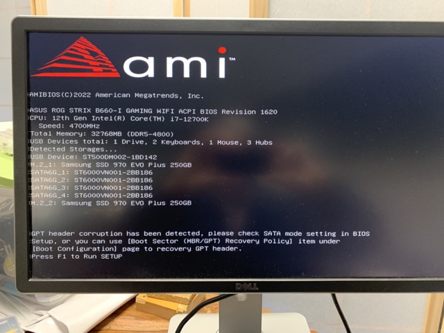

I've tested burning the ISO onto a 500Gb hard drive with USB connection and booting from it.
The very first time the computer boots there is this message (GTP header corruption has been detected) I fix this by following instructions provided in the screen capture. Maybe that recovery process is damaging the rest of the boot process?

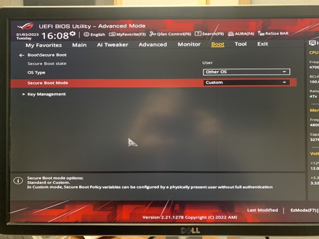

2. I verified the instructions about how to install TrueNAS and the installation process encourages to disable SecureBoot (which I did, see pictured below)
3. Once the computer tries to boot from the SATA drive the same message appears (GPT header corruption) this means that the iso image just downloaded from server is not right? I'll check the checksum and report back to this thread.

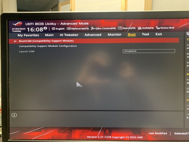

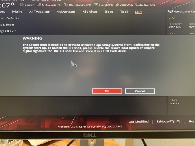

4. Checked if it is possible to entirely disable SecureBoot, but that option is grey in my motherboard and cannot be enabled without connecting an external video card? I don't have an external video card available and the motherboard is so small that there is no space to plug one. I want to be able to use the only one PCI available to plug a 10Gbit network card in a couple of months.
Additional image captures with comments:
1) IMG_146: AMI Bios message, note, the HDD is attached now to a SATA bus and the GPT message persist, either the original media is corrupt or it is not "trusted" by the motherboard.
2) IMG_150: It looks like it is NOT POSSIBLE to disable Secure Boot at all. What I can do is to manually load a digital signature from a USB flash drive. TRUENAS Staff, can you provide one?
3) IMG_151: Secure Boot Mode is set to Custom, as indicated in the documentation.
4) IMG_151: CSM Compatibility mode can't be disabled
I need help!

I'm glad I'm not the only one. TrueNAS CORE can't be installed on a computer where you can't disable secure boot. I installed TrueNAS SCALE instead
