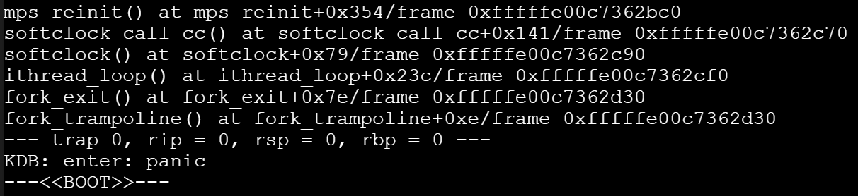

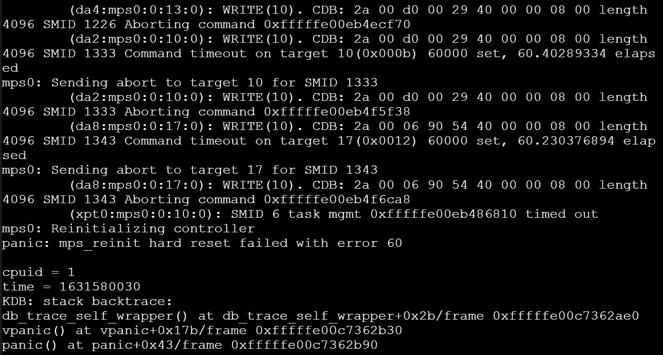

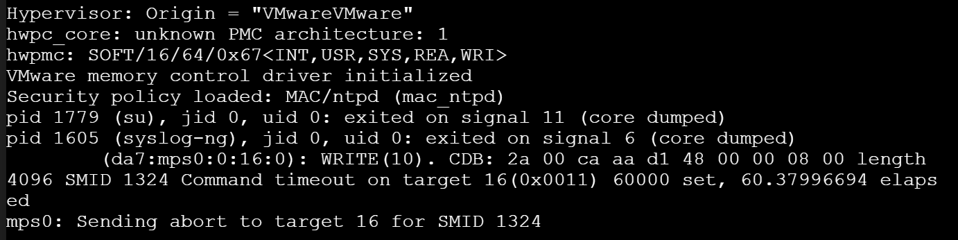

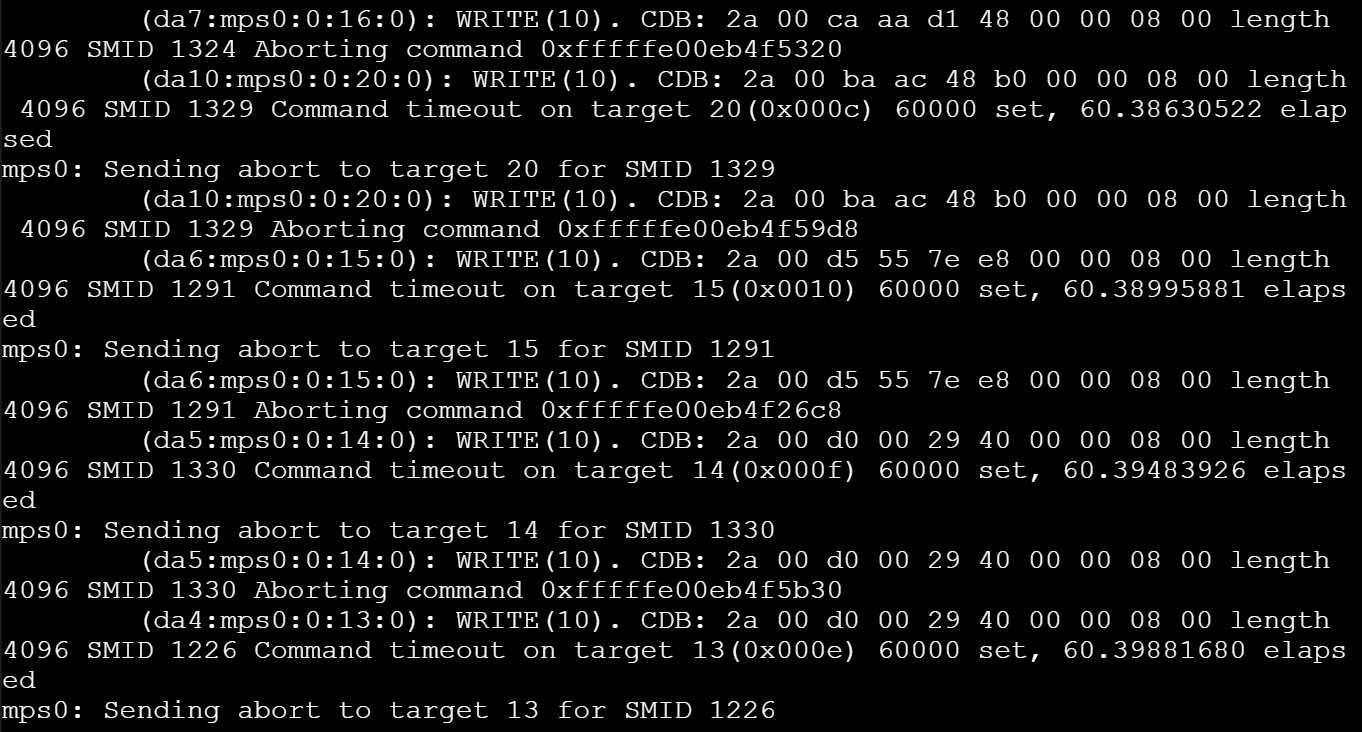

Hello Everyone,
This is my first post. I am new to TrueNAS. I recently installed it when migrated over to a new server. My knowledge is limited of both FreeBSD along with TrueNAS. I simply used online guides to do installations.
The server specs are as follows:
ESXi 6.7U3
TrueNAS 12.1
Supermicro X8DT6
2 x Intel(R) Xeon(R) CPU L5640
48 GB non-ecc DDR3 (32GB assigned to TrueNAS)
OCZ 60GB SSD (50GB provisioned for TrueNAS)
LSI 9207e (latest v20 IT firmware)
I have dual port and a quad port intel-based NICs (I don't know the model numbers)
I also have a Radeon 5400-based card
I have two ZFS pools:
6 x HGST 4TB enterprise drives (HMS5C4040BL) in raid2z
2 x WD Green 1.5T drives mirrored
The system constantly reboots. The rebooting happens anywhere from 1 to 5 hour intervals. While I rather not have the system constantly reboot, the main issue is that every reboot messes up the iSCSI connection between the TrueNAS server and a Win2k16 domain controller (using iSCSI for folder redirection). The connections are not automatically re-established, requiring me to re-create the iSCSI shares on the TrueNAS server along with delete and create the target connection on the Win2k16 server.
In an attempt to resolve the solution, I upgraded to the latest firmware for the LSI HBA, reattached the iSCSI cable, and I even ordered some ECC DDR3 ram because I read that the non-ECC stuff can be problematic.
Any and all help will be greatly appreciated.
I've enclosed the output from dmesg.

You're running TrueNAS under ESXi 6.7 on a Supermicro X8 system?
That's not expected to work. People have always had problems with PCI passthru on the X8 systems, and they often manifest similarly to what you describe, random freakouts several times a day.
Ditch the ESXi and run TrueNAS on the bare metal and it should be fine.
