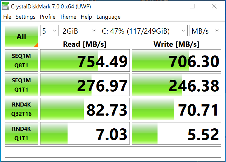

Windows VM
Does anyone have any ideas on tuning TrueNAS network stack. I have the 2 10G ports in LACP but NFS can only use 1 connection so I doubt network topology will be the issue. When will pNFS be coming to TrueNAS Core?

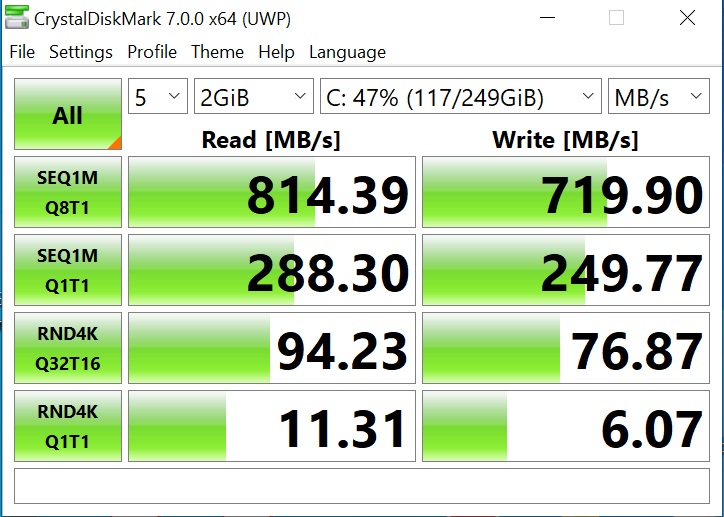

With some tuning I get 22000 R/W IOPS in a windows 10 VM.
