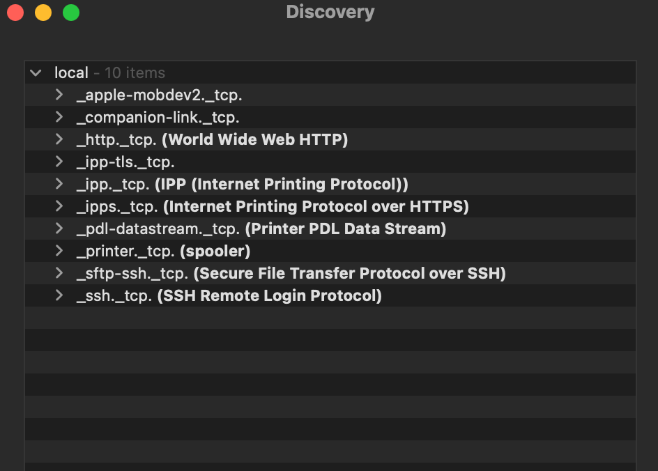

forfiter
Jan 22, 2014
28
This is what Discovery shows me, nothing nas related to be seen there...

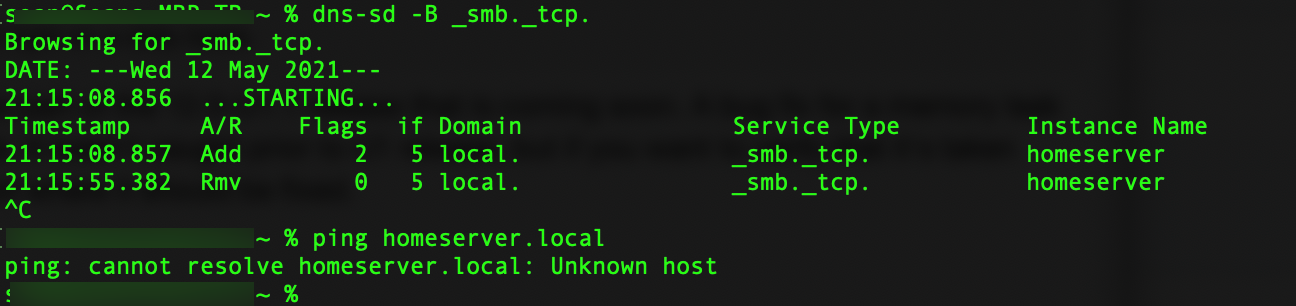

sean_h
May 12, 2021
Did this issue ever get resolved? I find I have exactly the same problem; the TrueNas box advertises itself on the local network for only a few minutes before dropping out. After that it can be accessed by IP, but not by its hostname. Attached is the output from the dns-sd command (taken from a MacOS). At the time the Rmv entry appeared in the list, the homeserver entry disappeared from the Mac's Finder. I was doing nothing else between the two entries.
Relevant details:
TrueNas version: TrueNAS-12.0-U3.1
MacOS Version: 11.3.1 Big Sur
I started noticing this issue shortly after upgrading from FreeNAS to TrueNAS Core
