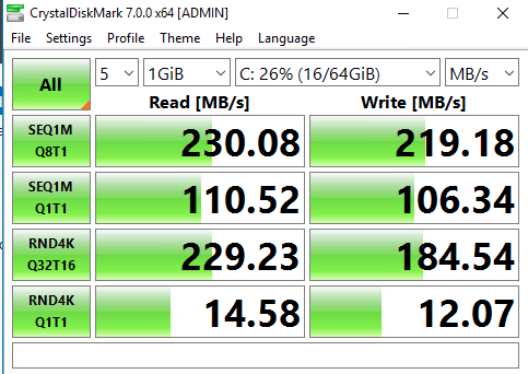

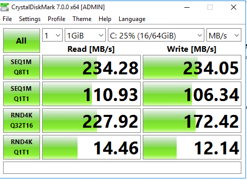

Quick-and-dirty test for before and after.
2x1GbE iSCSI setup using em driver, slight regression in SEQ1M, slight increase in RND4K high queue, but for the most the stats are "margin of error"
