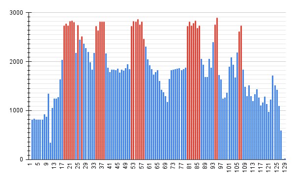

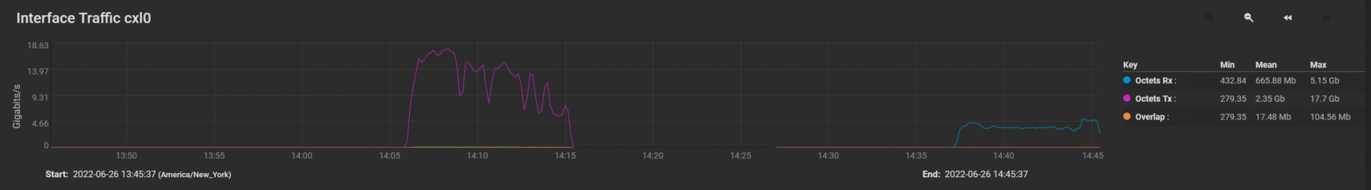

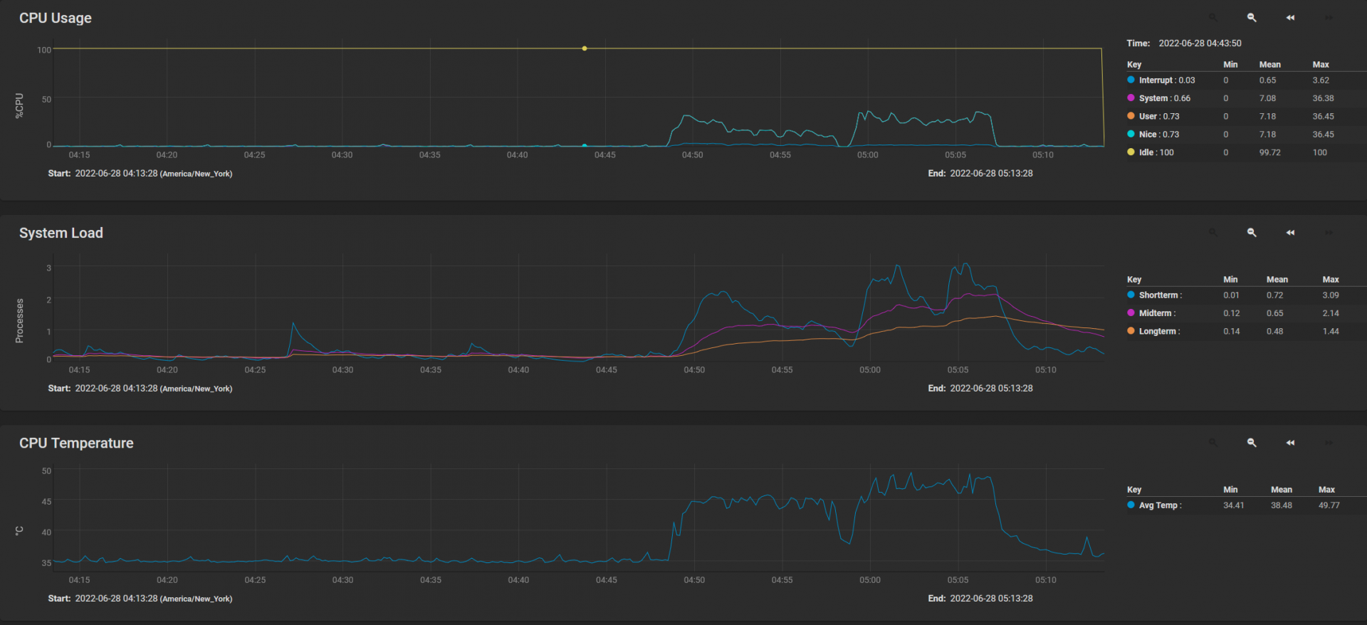

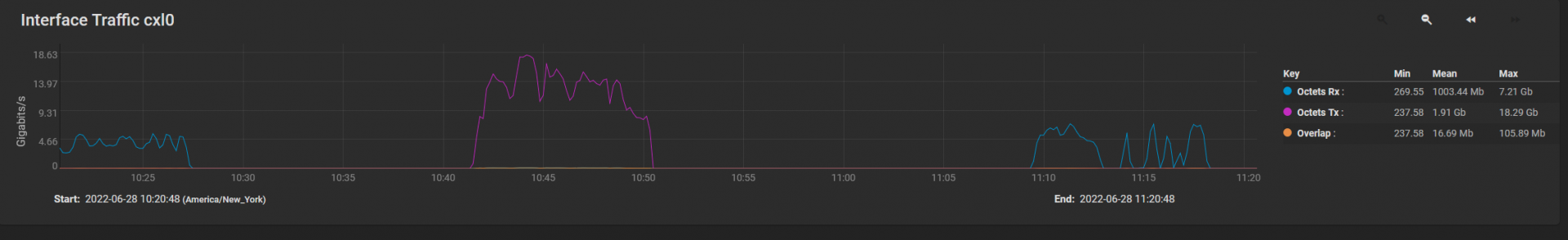

Dec 29, 2014
1,135

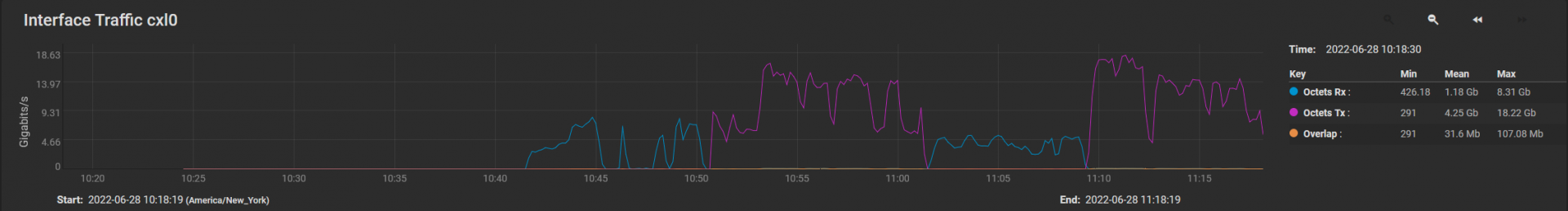

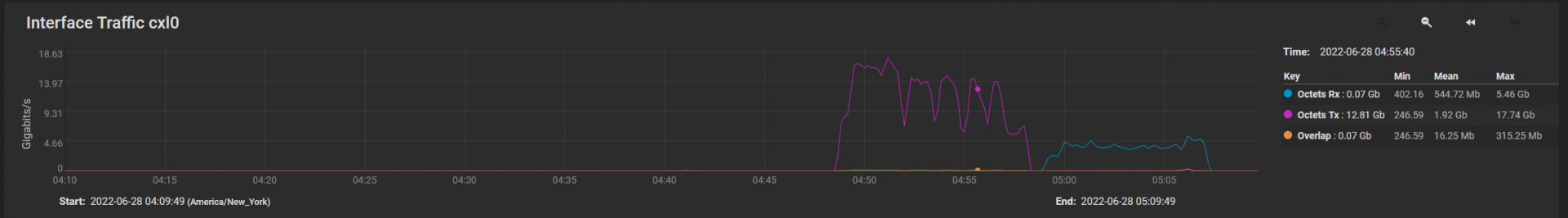

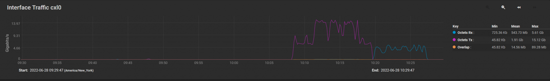

Here is my workload test again. These are the sizes of the 4 VM's I am moving around.
root@freenas2:/mnt/MIRROR-I/VMWare # du -m PCNS_vapp_en ASA-V alfred-2015 vcenter65-vCSA-7.0.3-19234570
1741    PCNS_vapp_en
1604    ASA-V
107831  alfred-2015
72134   vcenter65-vCSA-7.0.3-19234570
It took under 10 minutes to move them off, and under 10 minutes to move them back. I was moving them to a local data store in the ESXi 7 host.

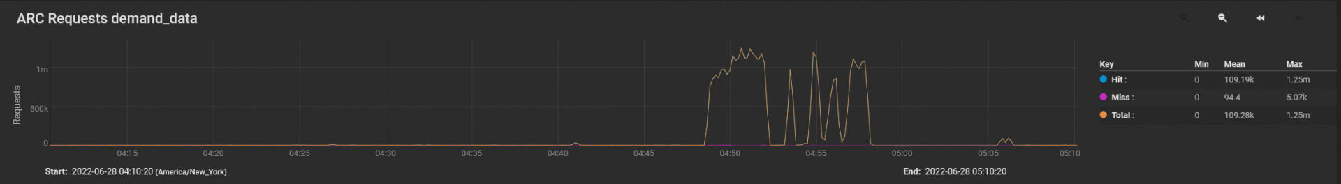

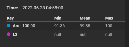

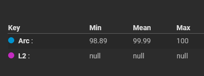

ARC Info still looks good to me.

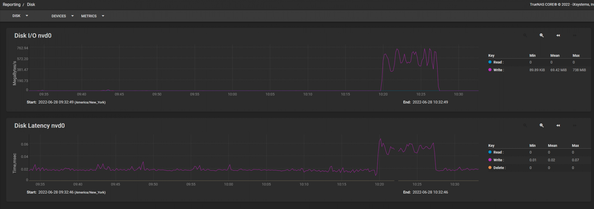

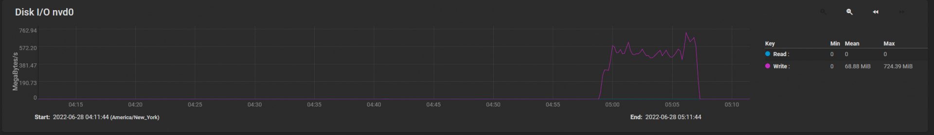

Here is the disk IO on the SLOG device.
Here is the dtrace output during the move back to the NFS data store.
dtrace: script '/mnt/MIRROR-I/CIFS-I/elliot/dirty.d' matched 2 probes
CPU     ID                    FUNCTION:NAME
  4  75698                 none:txg-syncing    4MB of 4096MB used
  4  75698                 none:txg-syncing  819MB of 4096MB used
  5  75698                 none:txg-syncing  835MB of 4096MB used
  6  75698                 none:txg-syncing  819MB of 4096MB used
  5  75698                 none:txg-syncing  819MB of 4096MB used
  1  75698                 none:txg-syncing  819MB of 4096MB used
  1  75698                 none:txg-syncing  927MB of 4096MB used
  4  75698                 none:txg-syncing  879MB of 4096MB used
  1  75698                 none:txg-syncing 1346MB of 4096MB used
  7  75698                 none:txg-syncing  348MB of 4096MB used
  3  75698                 none:txg-syncing 1057MB of 4096MB used
  7  75698                 none:txg-syncing 1240MB of 4096MB used
  2  75698                 none:txg-syncing 1244MB of 4096MB used
  6  75698                 none:txg-syncing 1278MB of 4096MB used
  6  75698                 none:txg-syncing 1640MB of 4096MB used
  5  75698                 none:txg-syncing 2040MB of 4096MB used
  5  75698                 none:txg-syncing 2740MB of 4096MB used
  7  75698                 none:txg-syncing 2773MB of 4096MB used
  4  75698                 none:txg-syncing 2732MB of 4096MB used
  3  75698                 none:txg-syncing 2825MB of 4096MB used
  2  75698                 none:txg-syncing 2831MB of 4096MB used
  6  75698                 none:txg-syncing 2802MB of 4096MB used
  4  75698                 none:txg-syncing 2174MB of 4096MB used
  5  75698                 none:txg-syncing 2743MB of 4096MB used
  5  75698                 none:txg-syncing 2444MB of 4096MB used
  6  75698                 none:txg-syncing 2515MB of 4096MB used
  5  75698                 none:txg-syncing 2367MB of 4096MB used
  4  75698                 none:txg-syncing 2272MB of 4096MB used
  5  75698                 none:txg-syncing 2194MB of 4096MB used
  5  75698                 none:txg-syncing 1989MB of 4096MB used
  5  75698                 none:txg-syncing 1838MB of 4096MB used
  7  75698                 none:txg-syncing 2180MB of 4096MB used
  6  75698                 none:txg-syncing 2730MB of 4096MB used
  0  75698                 none:txg-syncing 2632MB of 4096MB used
  6  75698                 none:txg-syncing 2820MB of 4096MB used
  0  75698                 none:txg-syncing 2818MB of 4096MB used
  5  75698                 none:txg-syncing 2811MB of 4096MB used
  3  75698                 none:txg-syncing 2162MB of 4096MB used
  7  75698                 none:txg-syncing 1872MB of 4096MB used
  7  75698                 none:txg-syncing 1789MB of 4096MB used
  4  75698                 none:txg-syncing 1840MB of 4096MB used
  5  75698                 none:txg-syncing 1828MB of 4096MB used
  5  75698                 none:txg-syncing 1851MB of 4096MB used
  7  75698                 none:txg-syncing 1776MB of 4096MB used
  6  75698                 none:txg-syncing 1832MB of 4096MB used
  7  75698                 none:txg-syncing 1819MB of 4096MB used
  4  75698                 none:txg-syncing 1862MB of 4096MB used
  5  75698                 none:txg-syncing 1944MB of 4096MB used
  6  75698                 none:txg-syncing 1846MB of 4096MB used
  0  75698                 none:txg-syncing 2727MB of 4096MB used
  4  75698                 none:txg-syncing 2828MB of 4096MB used
  7  75698                 none:txg-syncing 2815MB of 4096MB used
  7  75698                 none:txg-syncing 2863MB of 4096MB used
  6  75698                 none:txg-syncing 2759MB of 4096MB used
  7  75698                 none:txg-syncing 2816MB of 4096MB used
  5  75698                 none:txg-syncing 2461MB of 4096MB used
  7  75698                 none:txg-syncing 2304MB of 4096MB used
  5  75698                 none:txg-syncing 2049MB of 4096MB used
  4  75698                 none:txg-syncing 1924MB of 4096MB used
  7  75698                 none:txg-syncing 1841MB of 4096MB used
  1  75698                 none:txg-syncing 1732MB of 4096MB used
  6  75698                 none:txg-syncing 1787MB of 4096MB used
  1  75698                 none:txg-syncing 1826MB of 4096MB used
  6  75698                 none:txg-syncing 1608MB of 4096MB used
  4  75698                 none:txg-syncing 1424MB of 4096MB used
  6  75698                 none:txg-syncing 1378MB of 4096MB used
  4  75698                 none:txg-syncing 1297MB of 4096MB used
  5  75698                 none:txg-syncing 1170MB of 4096MB used
  6  75698                 none:txg-syncing 1646MB of 4096MB used
  7  75698                 none:txg-syncing 1828MB of 4096MB used
  4  75698                 none:txg-syncing 1832MB of 4096MB used
  3  75698                 none:txg-syncing 1849MB of 4096MB used
  1  75698                 none:txg-syncing 1852MB of 4096MB used
  2  75698                 none:txg-syncing 1868MB of 4096MB used
  5  75698                 none:txg-syncing 1821MB of 4096MB used
  4  75698                 none:txg-syncing 1848MB of 4096MB used
  0  75698                 none:txg-syncing 1880MB of 4096MB used
  5  75698                 none:txg-syncing 2726MB of 4096MB used
  4  75698                 none:txg-syncing 2820MB of 4096MB used
  5  75698                 none:txg-syncing 2739MB of 4096MB used
  4  75698                 none:txg-syncing 2790MB of 4096MB used
  3  75698                 none:txg-syncing 2837MB of 4096MB used
  6  75698                 none:txg-syncing 2688MB of 4096MB used
  7  75698                 none:txg-syncing 2734MB of 4096MB used
  0  75698                 none:txg-syncing 2054MB of 4096MB used
  5  75698                 none:txg-syncing 1937MB of 4096MB used
  5  75698                 none:txg-syncing 1690MB of 4096MB used
  4  75698                 none:txg-syncing 1690MB of 4096MB used
  2  75698                 none:txg-syncing 2053MB of 4096MB used
  4  75698                 none:txg-syncing 1871MB of 4096MB used
  5  75698                 none:txg-syncing 2394MB of 4096MB used
  6  75698                 none:txg-syncing 2758MB of 4096MB used
  5  75698                 none:txg-syncing 2900MB of 4096MB used
  5  75698                 none:txg-syncing 1725MB of 4096MB used
  4  75698                 none:txg-syncing 1632MB of 4096MB used
  6  75698                 none:txg-syncing 1244MB of 4096MB used
  6  75698                 none:txg-syncing 1263MB of 4096MB used
  4  75698                 none:txg-syncing 1369MB of 4096MB used
  3  75698                 none:txg-syncing 1893MB of 4096MB used
  5  75698                 none:txg-syncing 2089MB of 4096MB used
  5  75698                 none:txg-syncing 1934MB of 4096MB used
  5  75698                 none:txg-syncing 1674MB of 4096MB used
  4  75698                 none:txg-syncing 2188MB of 4096MB used
  4  75698                 none:txg-syncing 2616MB of 4096MB used
  4  75698                 none:txg-syncing 2739MB of 4096MB used
  1  75698                 none:txg-syncing 1835MB of 4096MB used
  6  75698                 none:txg-syncing 1481MB of 4096MB used
  6  75698                 none:txg-syncing 1296MB of 4096MB used
  6  75698                 none:txg-syncing 1512MB of 4096MB used
  4  75698                 none:txg-syncing 1299MB of 4096MB used
  1  75698                 none:txg-syncing 1194MB of 4096MB used
  4  75698                 none:txg-syncing 1339MB of 4096MB used
  3  75698                 none:txg-syncing 1436MB of 4096MB used
  5  75698                 none:txg-syncing 1264MB of 4096MB used
  4  75698                 none:txg-syncing 1105MB of 4096MB used
  3  75698                 none:txg-syncing 1169MB of 4096MB used
  4  75698                 none:txg-syncing 1288MB of 4096MB used
  0  75698                 none:txg-syncing 1136MB of 4096MB used
  7  75698                 none:txg-syncing  979MB of 4096MB used
  5  75698                 none:txg-syncing 1227MB of 4096MB used
  6  75698                 none:txg-syncing 1711MB of 4096MB used
  4  75698                 none:txg-syncing 1511MB of 4096MB used
  0  75698                 none:txg-syncing 1423MB of 4096MB used
  6  75698                 none:txg-syncing 1095MB of 4096MB used
  0  75698                 none:txg-syncing  593MB of 4096MB used
  5  75698                 none:txg-syncing   16MB of 4096MB used
  2  75698                 none:txg-syncing   25MB of 4096MB used
^C
And here are the CPU stats.
I think it performs pretty well, but does this shed any light on areas where I could improve it?

One last thing. It sure looks to me like my 900P is performing pretty well. Check out the IO stats on that.
Dec 29, 2014
1,135
Really last one! I tested with my secondary unit that has an external array of faster SAS drives, and the numbers are better. Here is the NIC on the secondary.
That was Vmotion primary to secondary, then secondary to VM host, back to secondary, and then secondary to primary.
Here are the NIC stats on the primary.
That also tells me that the drives and/or RAID controller in the ESXi host are also a bit of a limiting factor since the numbers are better between the two units. Anyway, I am pretty happy now. Thanks again all!
