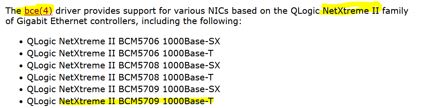

root@truenas[~]# pciconf -lv | grep -A1 -B3 network
bce0@pci0:1:0:0: class=0x020000 card=0x02371028 chip=0x163914e4 rev=0x20 hdr=0x00
vendor = 'Broadcom Inc. and subsidiaries'
device = 'NetXtreme II BCM5709 Gigabit Ethernet'
class = network
subclass = ethernet
bce1@pci0:1:0:1: class=0x020000 card=0x02371028 chip=0x163914e4 rev=0x20 hdr=0x00
class = network
subclass = ethernet

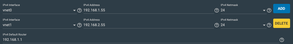

defaultrouter:auto # I tried with 10.0.0.1 which is the default router, no more success [...] ip4_addr:10.0.20.5/24

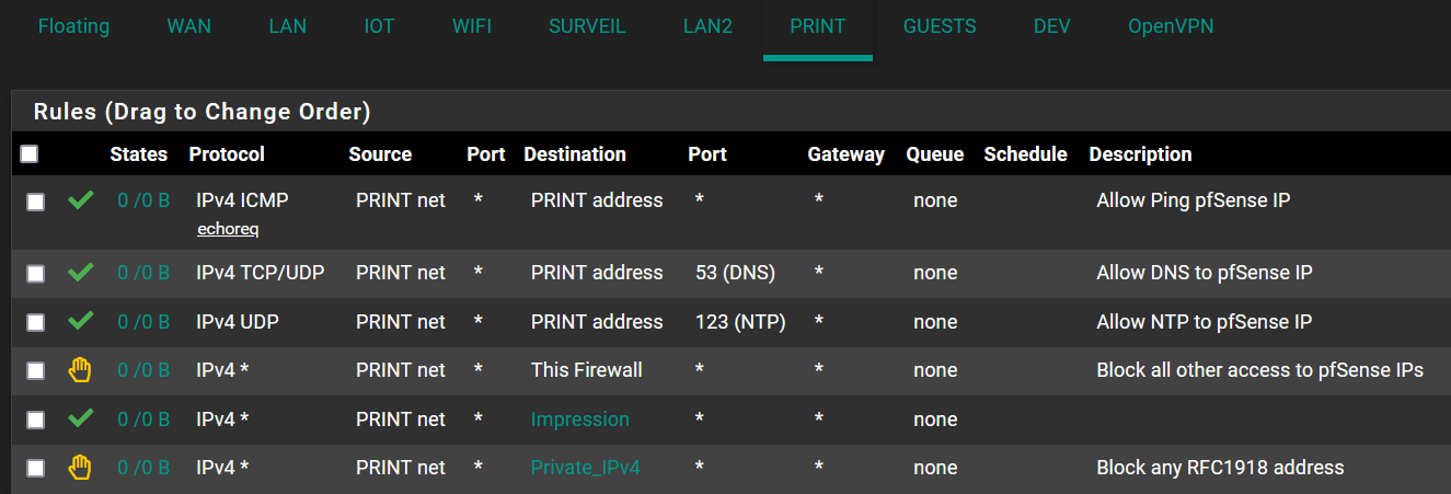

Is there anything missing in my pfSense rules ?Code:defaultrouter:auto # I tried with 10.0.0.1 which is the default router, no more success [...] ip4_addr:10.0.20.5/24
The defaultrouter must be in the 10.0.20.0/24 network - that's why the jail does not start. I assume the jail is supposed to be accessed from hosts in other networks and be able to reach the internet (to install packages and updates, at least)? Then you need something in that VLAN that is a router. Either your layer3 switch (if it is layer3 capable), a separate firewall, or as a last resort your TrueNAS host.

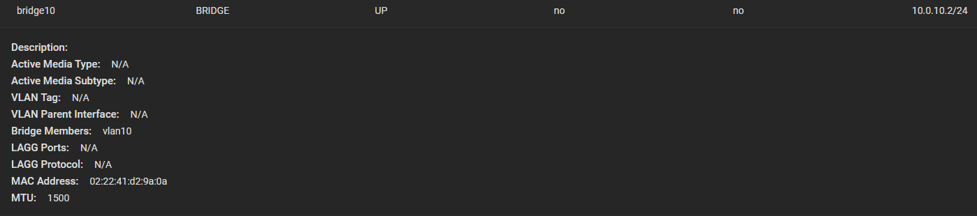

If you want the file sharing address to be in vlan 30, too, then your host does need an IP address there. So give the host an address for the bridge30 interface, not the vlan30 one.
jail=embyIP=10.0.10.20IP=10.0.10.2

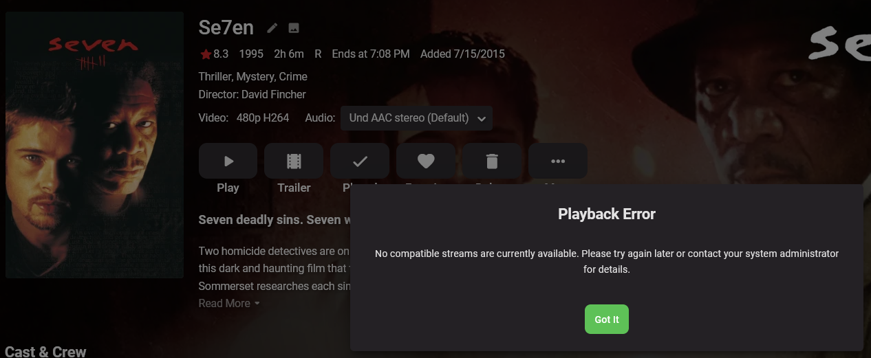

This is what I am trying to achieve. Emby server (serving movies) is now in vlan10 along with the TVboxes taht are pulling said movies.Well for one I would deem it reasonable to keep this emby thing in the same VLAN as the clients accessing it.
Is it not the goal of an emby jail in vlan10? I am not sure how it is different from your previous sentence ?What I would do in this case is move the web interface of the TrueNAS and possibly the SMB share, too, to a more isolated zone/VLAN.

I understood your last problem that you moved emby into VLAN 10 and then video playback stopped working? So there is at least one client not in VLAN 10 that needs to access emby?Is it not the goal of an emby jail in vlan10? I am not sure how it is different from your previous sentence ?
Yes, correct. Your data goes in regular TrueNAS datasets outside of iocage. These can then be mounted into the jails, read-write or read-only as desired.But I was under the impression that it is best practice to keep the jails for the "systems" and the datasets (not in iocage) for data...
The movie dataset resides on the TrueNAS that also hosts the emby jail, right? In that case the mounts do not use the network at all. They are configured at "Jails > jailname > Mount Points" in the UI. These are strict local Unix mounts, no sharing protocol involved.I thought that since jails have their own network stack, the embyjail would be able to access the movie dataset though this stack and ACL.
Physical --> LAGG (if present) --> VLAN --> Bridge
