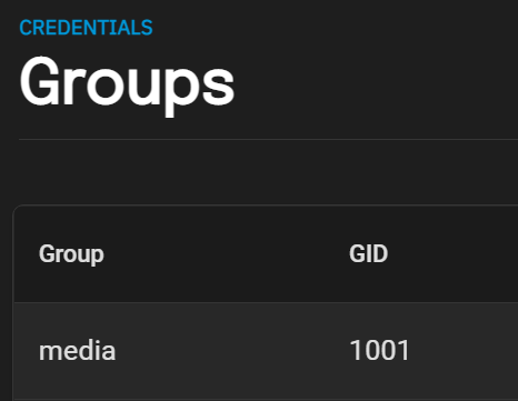

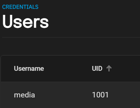

1) IDs and Groups
-create new ID&Group ahead of time and have UID/GID the same number for simplicity
-create them for each app you have (say radarr)
-create one called media

-create one called media (create one what? and what user should it have)
Create a user called media and a group called media. I create them with common UID/GID number for clarity.
