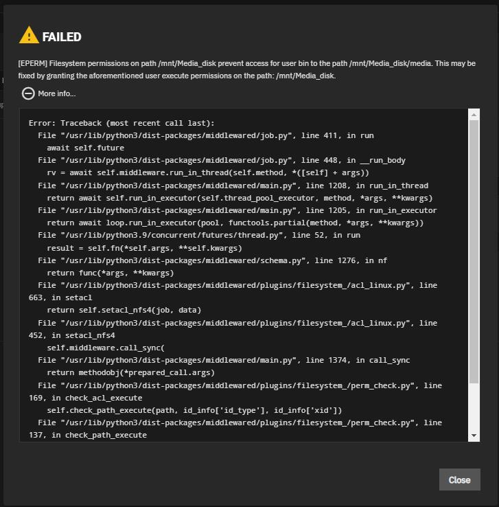

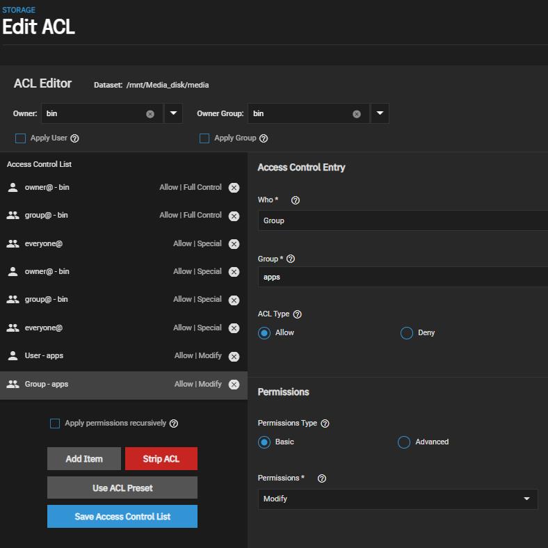

Hello gods.
I recently updated my NAS system from core to scale. Subsequently, when installing APPS, I found some permission issues: when giving APPS account and group permissions to folders (PLEX is used to read existing media files), there is a problem with not being able to give permissions. The error message is as follows. [EPERM] File system permissions on path /mnt/Media_disk prevent group applications from accessing path /mnt/Media_disk/media. This can be fixed by granting the above group execute permissions on the path. /mnt/Media_disk.

Yeah, this looks like one of those all-too-common cases where chmod 770 (or similar command) has been run from the shell. There are unfortunately a significant number of youtube influencers who don't understand permissions on Unix and recommend doing this (it basically breaks access to all data on the pool for non-root users).
This check was specifically added as a response to this (to help end-users diagnose broken permissions).

That is expected. Filesystem permissions are always based on uid / gid. Conversion of ids to names and whatnot is through NSS, which will go through whatever NSS modules are loaded (by default just your typical /etc/passwd, /etc/group files). That said, it won't cause permissions errors on the pool mountpoint because we default to 755 and root:root there. The only way to get different permissions on pool mountpoints is to modify from shell.

You could re-apply the chmod command so that it gives execute privileges to the parent folders: chmod 771
