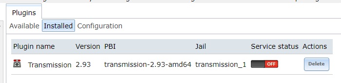

I turned off my FreeNAS server (FreeNAS-11.1-U5) while i was away from home. Transmission was working fine before that event.
Now that I'm back home, I found out that the Transmission Web is not showing anything.
I cannot turn it on using the GUI, it keeps showing OFF even i clicked on the button.
I try to use ./transmission start command, but it won't work either.
