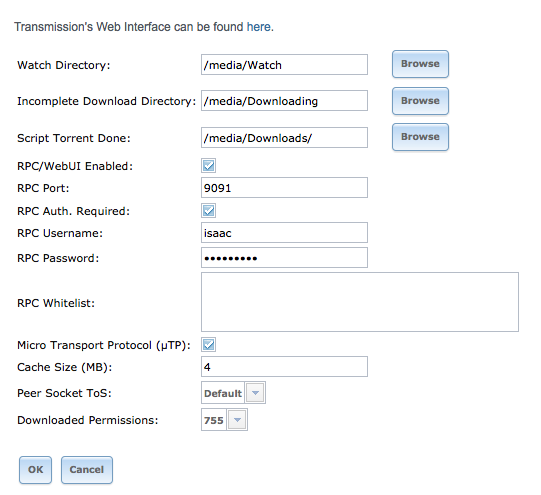

here are my settings for transmission

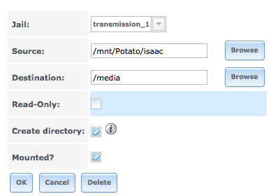

and here are the mounting settings

Joshua Parker Ruehlig
Dec 5, 2011
5,949
That is no longer where you set the transmission download directory, double check the labels. Those, for the most part are more advanced settings.
More standard settings can be set in transmission directly from the WebUI, transmission remote program, or the commandline.
I specifically removed the duplicated settings from that menu so they wouldn't overwrite what was set in transmission.

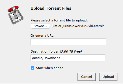

I changed it and it shows the free space correctly (well close enough), but whenever I add a torrent it gives me the same error (even if I manually set it). Also whenever I restart transmission it just changes back to //Downloads again.
So what the hell does "script torrent done" do then?
That's not where you set the default download directory in the transmission WebUI, just the directory for a single upload. See attached.
The "Script Torrent Done" is a script transmission will run whenever a torrent completes. See here https://trac.transmissionbt.com/wiki/EditConfigFiles
For example in my setup, torrents are started from SickRage or CouchPotato, when done I have a script from the nzbToMedia project run which sends the download the Sickrage or CouchPotato to be post-processed.
You shouldn't be touching that unless you are making an automated setup.

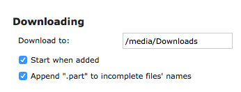

I have it changed correctly in the settings. I uploaded it and planned to use it in my post, but decided not to and I guess I forgot to remove it.
In a previous install (when it wasn't working) I changed the folder where settings.json was located and edited it, but transmission still did not obey those settings.
