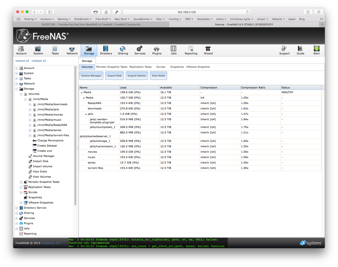

I tried putting in a dataset name and the path to it and it just gave me errors.
Please post a screenshot of your FreeNAS Storage tab, and state what path you tried.

here is the screen shot. Made "ReadyNAS" trying to just send it there and then move the file to where ever I wanted after that.. I'm currently trying to drag and drop file in my iMac's Finder but I keep getting "you do not have permissions to some of the items" errors. very annoying

To rsync to that dataset, the destination path would be <user>@<yourfreenasnameorip>:/mnt/Media/ReadyNAS.
Is that the path you used?
Do you have SSH enabled on FreeNAS (or are you trying to use an rsync daemon module)?
Does the user you're attempting to use with rsync have permission to write to that dataset?

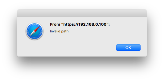

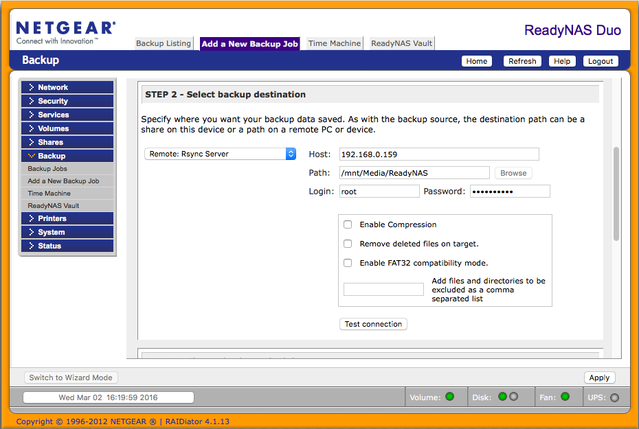

I tried path set to /mnt/Media/ReadyNAS
i wasn't sure if i would have to input a login and password
so i tried root and the password but still got invalid path.
I have FTP, NFS, Rsync, and SSH enabled.

Do you have SSH password login enabled for root?
It's possible the ReadyNAS is expecting the remote to be a daemon. If so, you will need to set that up on FreeNAS.
Amsoil_Jim
Feb 22, 2016
175
on the free has i added a Rsync module and chose the path /mnt/Media/ReadyNAS.
but this all seems to be all for not, because my ready was is and older DUO and they stopped updating the firmware quite some time ago and when I tried to add the new back up job the Apply button is greyed out, can't wait to not deal with that thing any more...
