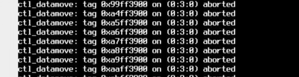

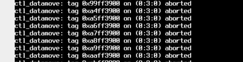

My Test Object at this time is one big 2TB file and speed is going up and down as described. But now a saw something.

With any RAIDZ*, you only get the write performance of at most a single disk, because each write needs to write a data block and some number of parity blocks on different drives. So you're seeing the raw write performance of your slowest drive.
For your screen shot, that indicates you may have a bad controller, which is disconnecting from the PCI bus under load.
