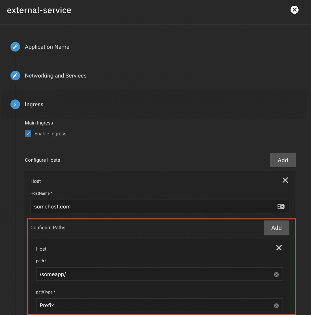

Use the TrueCharts app called External Service, then set it like this:
You'll need to add the path to have one there to work with...

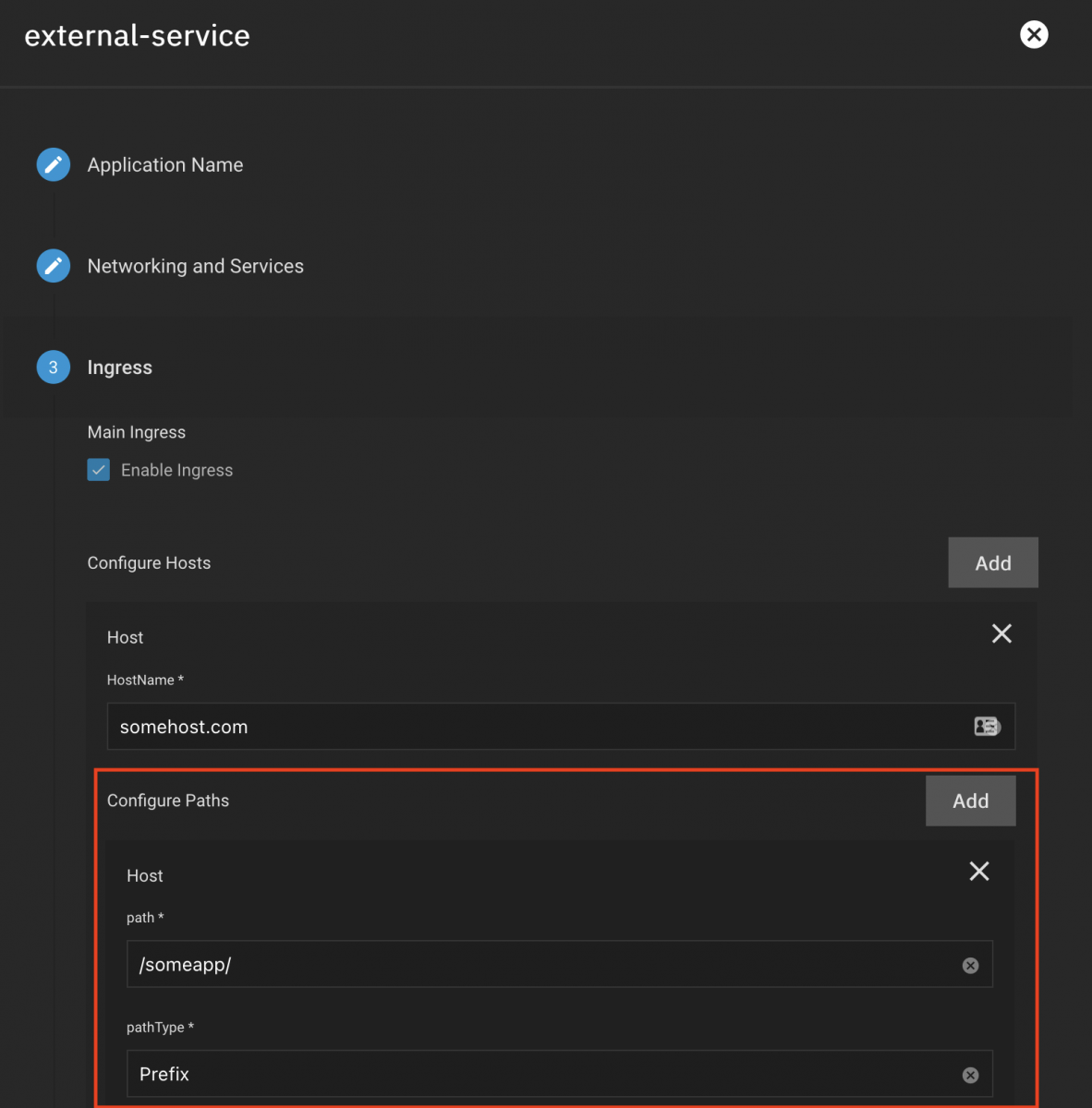

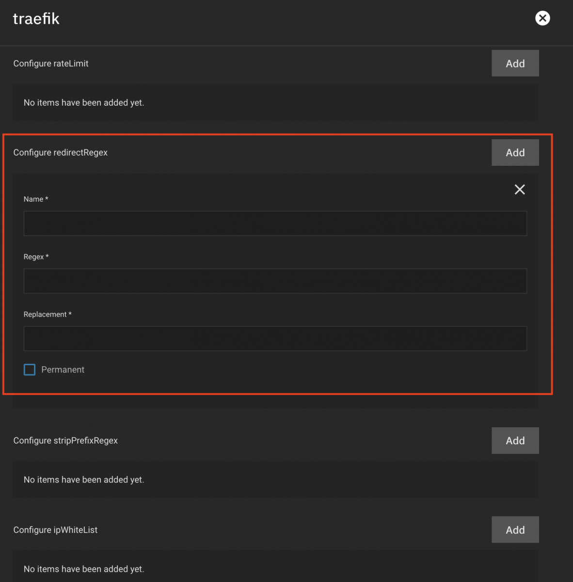

One would, most likely, also need specific traefik middleware, otherwise it would only do:
ha.mydomain.com/app -> 192.168.1.50:someport/app

Thanks for very fast reply, I've tried to setup regex redirect middleware, and plain redirect was working
sort of..
 https://ha.mydomain/app => https://ip:9541
To plain ip worked but i've lost domain name in url it just redirected to ip address.
 https://($1)/app =>  https://x.x.x.x:9541
I've tried today with truecharts app emu js which have two web interfaces
config on : 10130 (traefik catches it first in ingress, and I don't want to expose this service)
actual app on 10124 (this should be exposed)
I tried to first configure subfolder for app so I've added
^(.*)/app  => $1:10124
Regex101 replaces this nice, and without middleware emu.mydomain.com:10124 works fine
But when I've enabled middleware on emu app, it redirected me to right address but with ssl error
ERR_SSL_PROTOCOL_ERROR
Is there any way to hide port in url and to maintain emu.mydomain.com/app, and redirection under the hood?

It's probably worth mentioning that you don't always need to do the redirect if the app already supports re-writing the path...
Most of the common apps do allow for the path to be set (the setting might be called something like URL base or you may need to search around for it a bit in the general or UI settings.
Where you can get the app to know that it's in a subfolder, the first path setting should be all that's needed in Traefik
