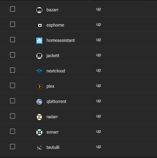

Check if traefik is linked to services (on dashboard all services are green)

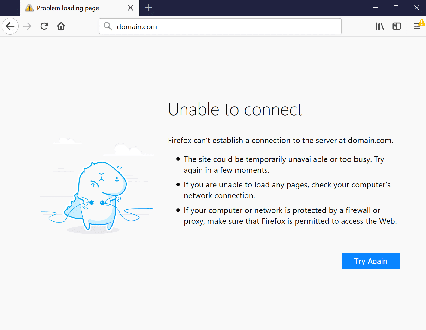

I got some services and firefox just say that he can't reach them
Connexion Failed

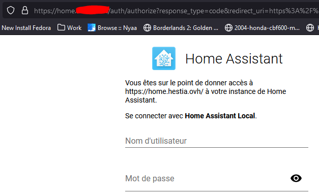

the traefik app link services with reverse proxy and when i try accessing home.*** from a computer in my network it doesnt work. But when looking for traefik dashboard all services are well connected
Hope this will answer the question

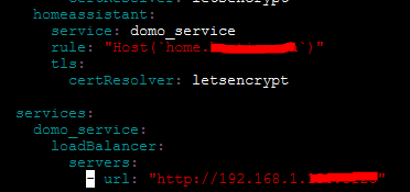

To add some details:
I tried this on my network (computer on the network but not the trueNAS)
/etc/hosts (file)
So i guess it answer the question : Yes services are accesible for traefik

I tried to do the same as this post but with my router IP and it doesn't work. I guess it can be my router that just kick me out but I did some rules to let open ports 80 and 443 to go through.
15,504
it doesn't work.
"It doesn't work" is not helpful, because there are roughly 100 ways something could "not work", as a result of roughly 100 problems. "Some connection error page" is similarly unhelpful; posting a random screen shot of a different browser error is even less helpful, unless you're certain that it's exactly the same error translated into English.
But taking you at your representation that the picture you posted does actually reflect the error you're getting, it would look like port 80 isn't open to connections from outside. This could mean that you didn't enter your port forwarding rules properly (double-check with the documentation for your router on this). It could also mean that your ISP is blocking inbound port 80--this is quite common for residential ISPs in .us; I don't know about other parts of the world. Are you able to connect via HTTPS?
I get the screen because it were the same error translated.

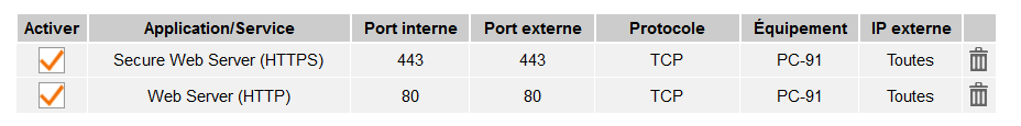

This is the rules on my router

I asked to a friend to try the connexion from outside the network and all work well... So my issue is and was that I can't connect from inside my network to my domain name who redirect to my own router I guess.
