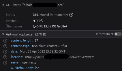

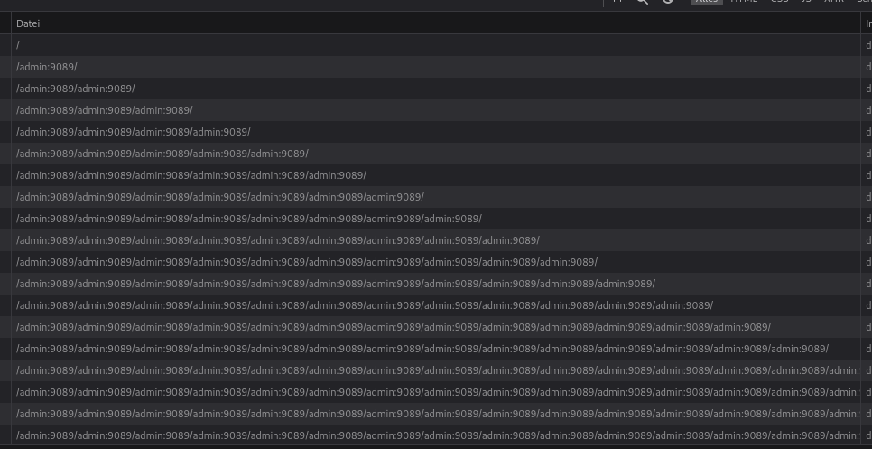

today I successfully managed to setup traefik as an ingress provider for all apps I've installed on my TrueNAS box. So far so good, I disliked the fact, that PiHole is only reachable, when calling it using the correct path (<domain>/admin). I tried to add a redirectRegex middleware to pihole, redirecting calls to the plain domain to <domain>/admin, but that results in a weird redirection loop when accessing it on a browser.
Apparently traefik responds with an invalid location, containing the port appended to the path. Even though the loop must come from an unexpected match in the regex, it puzzles me why the internal service port of pihole is appended to the path at all. The regex looks as follows:
Did I just overlook something obvious or might there be a bug within the redirectRegex function?

That does not explain where the port comes from in the first place. My request didn't contain a port. The regex doesn't contain a port. Its the actual port on which that service would be available when using "simple" networking (I'm not, I use ClusterIP, its still available as I would use "simple") but anyway. Ingress otherwise works, when I access the service using the right path no such weird loop occurs. This has to do with redirectRegex itself.

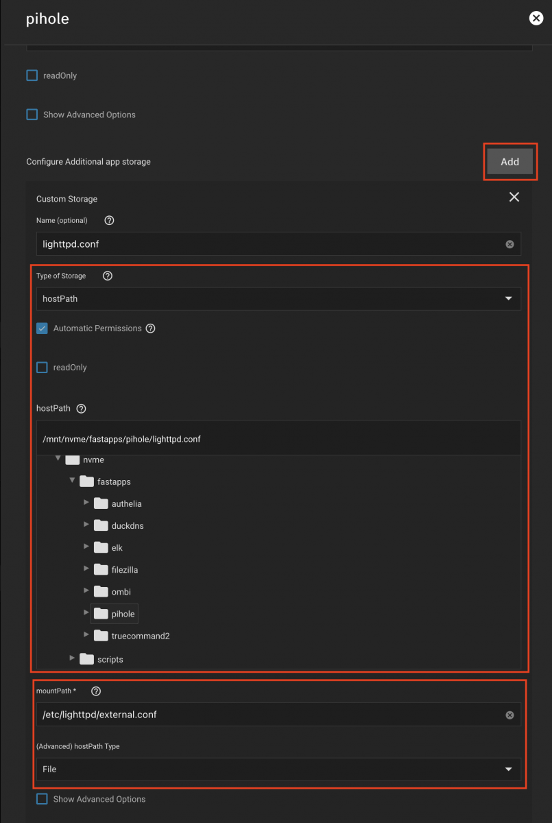

I think you're going to need to look at the last section of this:
it seems for what you want to work, you need to edit the lightppd config on the pi-hole.
That seems to be exactly what I want to do. But shouldn't this be possible to be done by traefik/some middleware somehow instead of modifying the internal lighthttpd config (which gets probably overwritten on pod updates)?
9,703
No. The app itself will fight against reverse proxies like Traefik to rewrite the URL unless it's configured to play ball.
Containers are designed to be ephemeral, so you're right that any change you make to the container directly will be killed on rebuild/redeploy, but that's why you define persistent storage for some parts of the container.

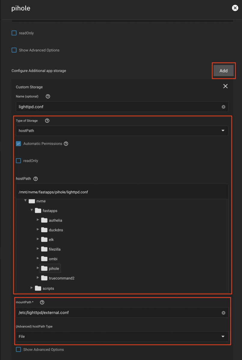

I see that the TrueCharts app doesn't catch that required config file (/etc/lighttpd/external.conf) in the config storage mount so you would have to add one in the Storage and Persistence section.
After clicking Add, you would choose the hostPath type, then select where on your host to put it, then the mountPath in the container where it will appear and the type "file", since we're not wanting to catch the whole of /etc/
You would then be able to edit that file from the host and it will be kept between container versions/deployments
Thank you very much, this approach seems to be the best solution for my problem so far! I'll try this tommorow.
That's pretty-much spot on.
Just be aware not-to file support tickets with our staff if you add customisations like these ;-)

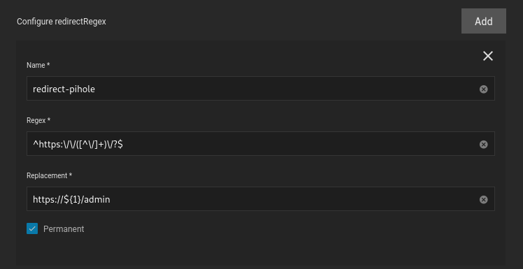

You have the middleware almost correct, just use ^https://([^\/]+)/?$ for your regex and remember to add redirect-pihole to your pihole app's settings in Ingress/Main Ingress/Traefik Middleware.
Here's how you do it.

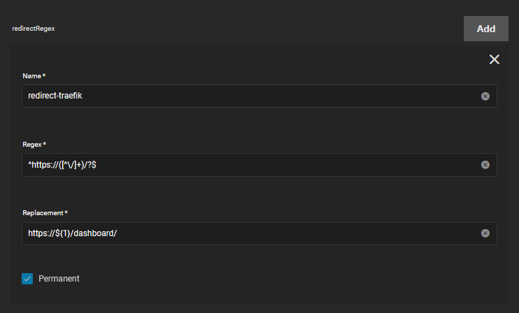

What you want to do is documented at https://truecharts.org/charts/enterprise/traefik/redirect-regex-middleware/. Like you, I wanted to redirect traefick.<domain> -> traefick.<domain>/dashboard/ but you can do the same with <domain> -> <domain>/admin/ for your pihole app.
In the traefik app, I added a redirectRegex rule. Remember the name, you will need it later. The regex rule is taken straight from the truecharts docs. Apparently "/" is valid and you don't need "\/" (but I haven't tried it both ways). Note that the "redirectRegex" is not found in "Ingress", keep scrolling a while until you get to "Middlewares", there you will find "redirectRegex".

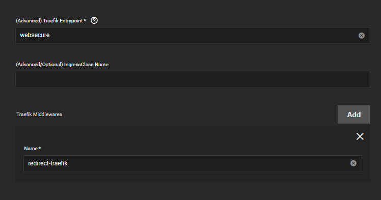

Then in the app you want to use this redirect middleware, (in my case traefik itself, for you it would be pihole), in the "Ingress" section, go to the "Traefik Middleware" subsection and add the name of the middleware you created.
We can see that the redirect is working:
I can confirm this works for pihole and elegantly solves what the original post was trying to do, namely using traefik to auto-redirect to /admin when accessing the ingress with just the bare URL. @Migsi - you might want to try the above as well, if you're still interested in a solution that avoids directly adding/editing a config file to the container. @Rarity - thanks, this saved me a few minutes!
