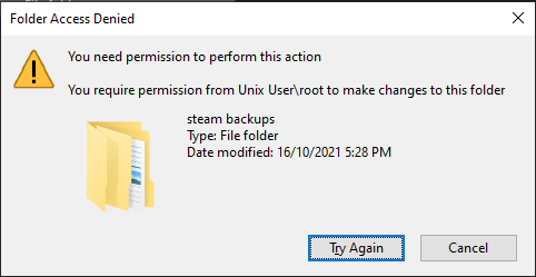

i transferred the data from the external drive to my zfs pool but i read online that the files that showed up from the external drive are read only, so i copied the files to a new folder so i could do what i wanted with them. now the read only files are stuck in my zfs pool even when i disconnect the external drive and i cant delete them because it says i dont have permission. ive tried to log in from my pc as root but it wont let me, apparently root cannot log in on smb

Try changing permissions on the files - use the recursive button

Well you could just delete the entire dataset - but the issue sounds like permissions so you need to create a user, give them permissions to the dataset recursively (so it travels down the tree) and then you should be golden.
You cannot log into a SAMBA share as root - that a deliberate design choice of TrueNAS

Never put files in the root dataset.
OK, so you need to
  • create a dataset.
  • login via SSH as root
  • cd /mnt/yourpool
  • mv <all your files> <your new dataset> - going to take a while
  • the recursively set the owner of the dataset to the desired new user
  • use that user for sharing
