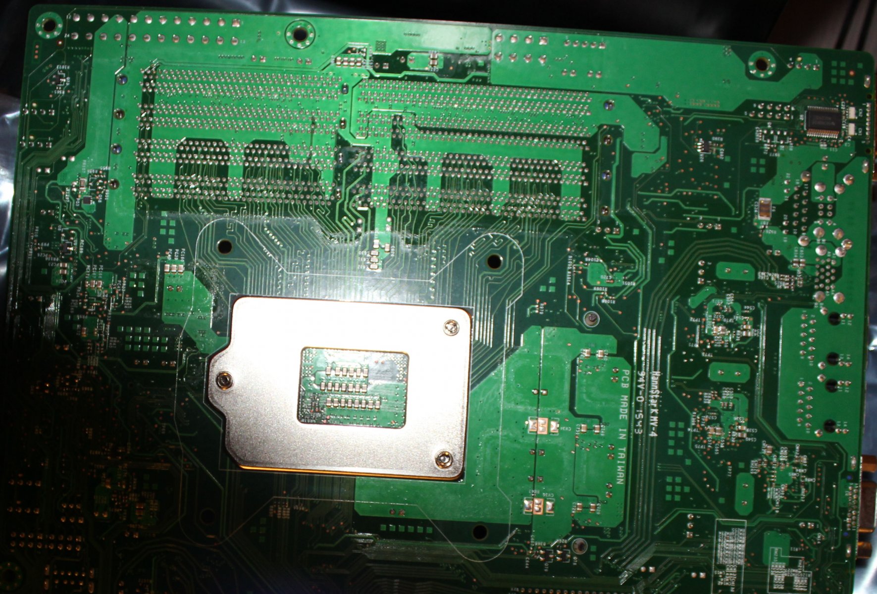

@Ericloewe I got my Supermicro MB today and during my inspection of the board I found on the backside there to be many glossy and sticky areas, primarily near solder points where are not surface mounts. It looks like there was a mask on the board covering all areas where SMT parts were located and just left the through board components open for soldering. The material appears to be flux. I'm curious if yours has the same issue? I will get some good alcohol to clean up the mess because sticky stuff collects dust and dust can short out electronic circuits. The rest of the board looks fine.
Yeah, I just installed it in the chassis. I hadn't opened the static shield bag yet, so I hadn't done the proper visual inspection yet.
Once I did, my first thought was "woah, did they just coat the whole board with flux?". Not really going to clean it, since I'd probably break something trying to do so (mechanically or ESD).

That is sloppy work, poor QA. I thought Supermicro was a better company but I guess not, in fact this is the only motherboard I've ever had with this issue. If I can't find some good alcohol in the department stores (97% or better), I'll just grab some from work. We have 100%, no water at all. If you do end up cleaning it, don't use rubbing alcohol unless you really dry the board off. I'll use Q-tips, lots of them and take my time. Normally at work I'd use an acid brush (a short camel bristled 3/8" wide paint looking brush with short stiff bristles). I'm still waiting on the CPU and RAM to arrive on Monday before I can do anything anyway. I think I'll write Supermicro a letter/email complaining about the quality control. I have no intention to replace the board unless it fails but they should know that the flux should have been all cleaned off as it's an electrical issue because of dust accumulation and can promote wiskering.

I tried to take some photos last night but it was difficult to show the shiny parts against the flash. I'll try again when I have some good sunlight before I clean it up but as I indicated, it appears there was a mask applied and then maybe it went through a solder bath, but the excess flux never got removed. So I'll try a few more photos later today and if anything comes out, I'll post them.
A toothbrush is pretty good for this too and is easy to find ;)
Great idea, I have many of those.
The board was already in the chassis by the time I replied, but I do have some pictures. I'll see if any of them show it.
Good news is that the RAM seems to be working so far.
Well, I found one that illustrates this:
It's most visible in the transition from the socket area to the DIMM area (with the through-hole DIMM slots).

That is a good photo and imagine that is around all through connectors, so any wire that sticks out of the bottom of the MB has that crap and like I said, it's sticky so I suspect it's flux.

Still not clear to me that that's actually flux, but it seems the best bet. A lot of manufacturing of PCB's has migrated to no-clean style fluxes, especially with RoHS, and the result shouldn't be sticky. But it's certainly possible that this is a traditional flux and that something went awry with the cleaning process. For about $20 you could get some MG 4140 and give that a shot, it should be very safe on the underside of a board.

What caught my attention was my fingers were sticking the the bottom of the board when I was inspecting the top side, so I flipped it over and that is what I saw.
