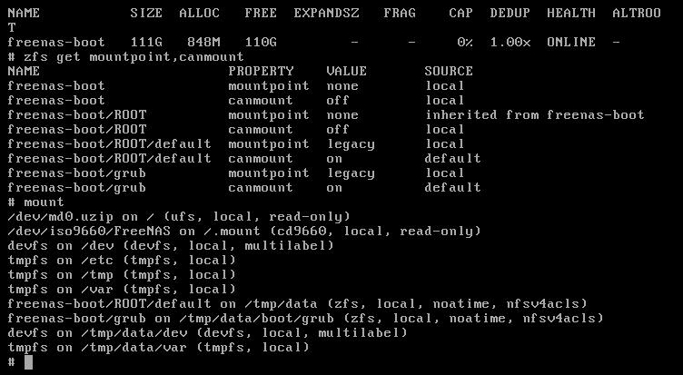

Much to my surprise and dismay, I was unable to reinstall FreeNAS on the new boot drive (an HP 120GB SSD). The install appears to work fine, then near what I assume is the end of the install process I see:
/usr/local/sbin/grub-install: error: unknown filesystem.
The FreeNAS installation on da0 has failed. Press enter to continue...
I tried build 11.2-U6, and I even tried switching from BIOS to UEFI. Nothing seemed to make any difference. The error reported by 11.2-U6 is:
ZFS: i/o error - all block copies unavailable
ZFS: can't read MOS of pool freenas-boot
gptzfsboot: failed to mount default pool freenas-boot
