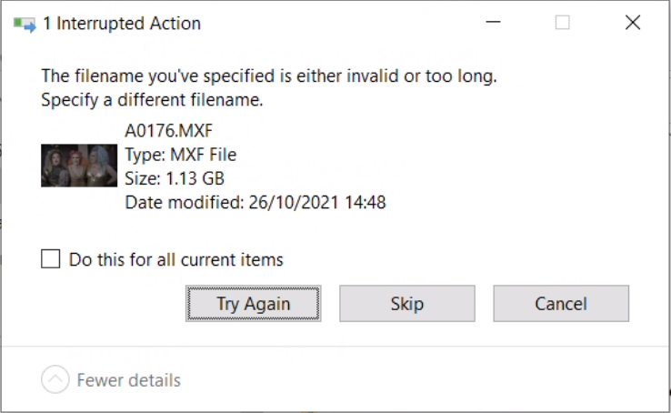

Hi folks, I'm having a issue in TrueNas that is preventing me from copying some files to my PC desktop from my TrueNas system. I'm using SMB on Windows 10 to access my TrueNas system. The error I'm getting is "The filename you've specified is either invalid or too long.". I've checked the length of the path, and it's only 131 characters in the case of the example below. I get this same error with other files in the same directory, and there are other directories on my system that share the same issue.
If I duplicate the file below within the same directory, via copy and paste, so that I have a new duplicte file called "A0176 - Copy.MXF", I'm able to drag the duplicate to my desktop, but not the original file.
This issue causes Premiere Pro's Project Manager to fail when I attempt to collect a project's files.
Example file:
(Note that I've changed some of the letters to *'s to anonymise the project, but there are no *'s in the path)
\\192.168.1.50\shared\Archive\A******\A****** - V* (Multiple Projects)\A**18089 - V* Y***B****** Phase 2\Footage\Supplied\A0176.MXF
The unix path is /mnt/tank/shared/Archive……… so no longer than the Window file path above.
I'm using Windows 10 20H2 19042.1288, and TrueNAS-12.0-U6 installed on a 45Drives Storinator.
That is highly strange. Permissions issue that Windows 10 incorrectly deems "file path too long"?
