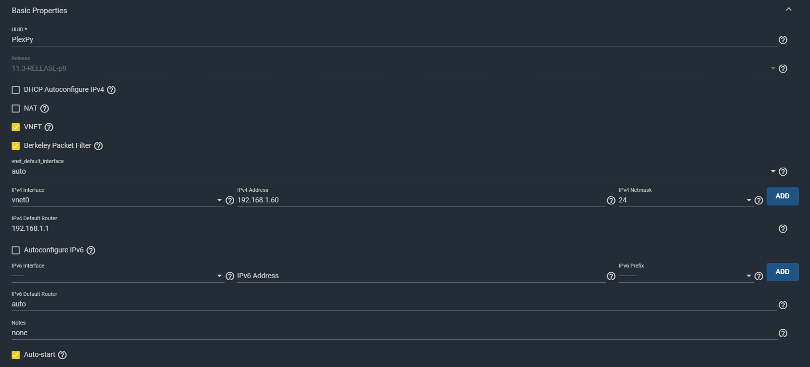

So I'm not seeing anywhere to set or check the default gateway or the DNS server. I've also already updated all the packages and did the python and sqlite installs:

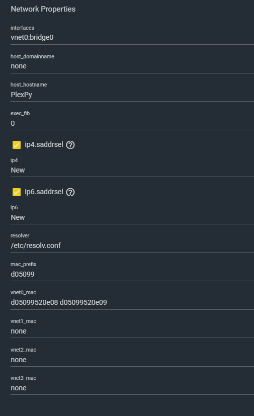

OK, you do have a default gateway set in the jail. What does /etc/resolv.conf inside the jail show? You may need to add nameserver 192.168.1.1; in the resolver field of the Network Properties of the jail.
The resolv.conf has this:
# Generated by resolvconf
search local
