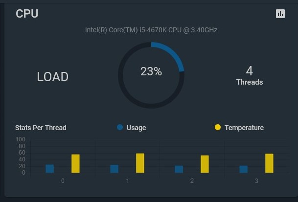

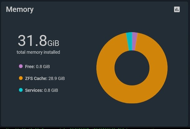

So I'm a photographer/videography and been using FreeNAS for about a month. I store all my projects on my Freenas system and work on the projects from there. But I noticed that the freenas system start to slow down after some hours depending on my work load and noticed that the 32gb of ram is full. Is this because I'm running out of ram.
Here the hardware info:
Case: Cooler Master HAF Stacker 935
CPU: Intel I5-4670K
Motherboard: Gigabyte GA-Z87-D3HP
RAM: 32gb

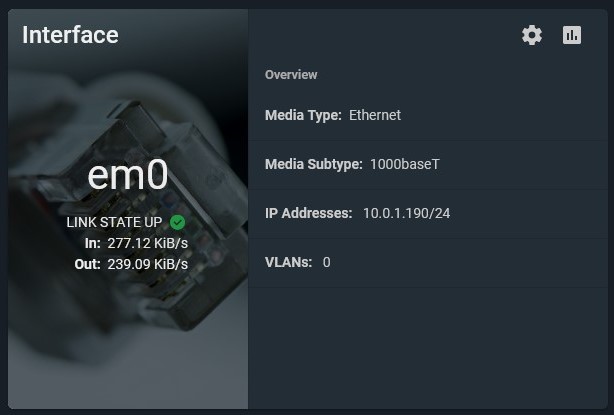

Ethernet: 1GB network
16 port sata controller card
USB: 2- 64gb 3.1usb (for FreeNAS)
4-12tb hard drives ( RaidZ ) for Videos projects - 11tb used
4-10tb hard drives ( RaidZ ) for Photography projects - 12tb used
Is there any thing I can do to keep the speed of my FreeNAS system other then restarting my system before working on it.

Your motherboard does have an Intel LAN card, so that's good, but I'd like to hear more about this piece of hardware:

As far as the amount of RAM used, it's all being used for cache. ZFS will use all available RAM for read caching, and release it back if other services require it. Does your system show it as using any swap?

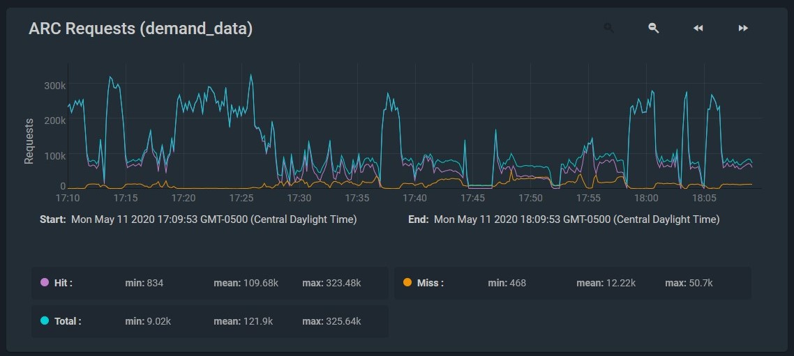

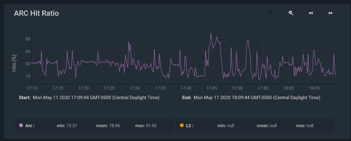

So read speed. When it gets slow, what does zfs-stats -a have to say about ARC hit rate? Both file and metadata fitting entirely into ARC may be of interest.

Is this what I looking for, for sfs stats

I was hoping for the actual output of that command from CLI, accessed via SSH so you can copy/paste. One possibility is that tuning ARC to hold more metadata may help, unless you want to just throw another 32GiB of RAM at it.
Not saying it is ARC. I’d love to see whether it’s evicting metadata when it starts slowing down.

Oh right. Yes. You’re running out of cache space for metadata.
So a thing about L2ARC, secondary cache: Its index takes away from ARC, primary RAM cache. You want it large enough to solve the problem, but not so large it makes the problem worse.
Do you have a small 128GB SSD? If so, that could be added as L2ARC as a test. If not, someone will be along presently to help calculate the amount of metadata nearly 2 million files generate, the amount of ARC the L2ARC will eat, and the optimal size of that L2ARC.
About adding L2ARC: That’s reversible, but adding a disk to the pool proper is not. The latter has catastrophic impacts to pool redundancy, so, best to be very deliberate when adding read cache and making sure it’s really being added as read cache.
Come TrueNAS 12, which should be out in summer, you have another option: Remove the L2ARC again, get a second SSD of the same size, and add them as a mirror pair to the pool storage as a “special allocation vdev” that will only hold metadata. For that, definitely calculate how much metadata you will hold, first. This is also not reversible and will require careful planning.
What is your “pool layout” currently? Number of disks, in what kind of vdev? As in, 6-wise raidz2, or 3 mirrors, or something else ...
How much data do you have total in those files, expressed in TiB?
