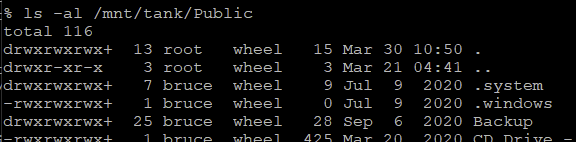

(no .system directory). Then I look under the Public dataset and see:

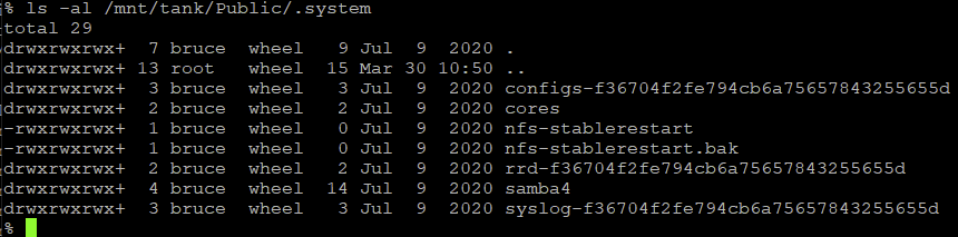

...and the .system directory contains the following:
I don't know where this data came from, and I have no idea whether I can delete it.

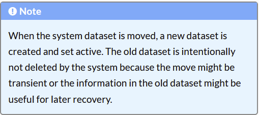

I'm not sure how the .system directory got into /mnt/tank/Public in the first place so it's probably flotsam. I also noticed the following in the TrueNAS documentation:
