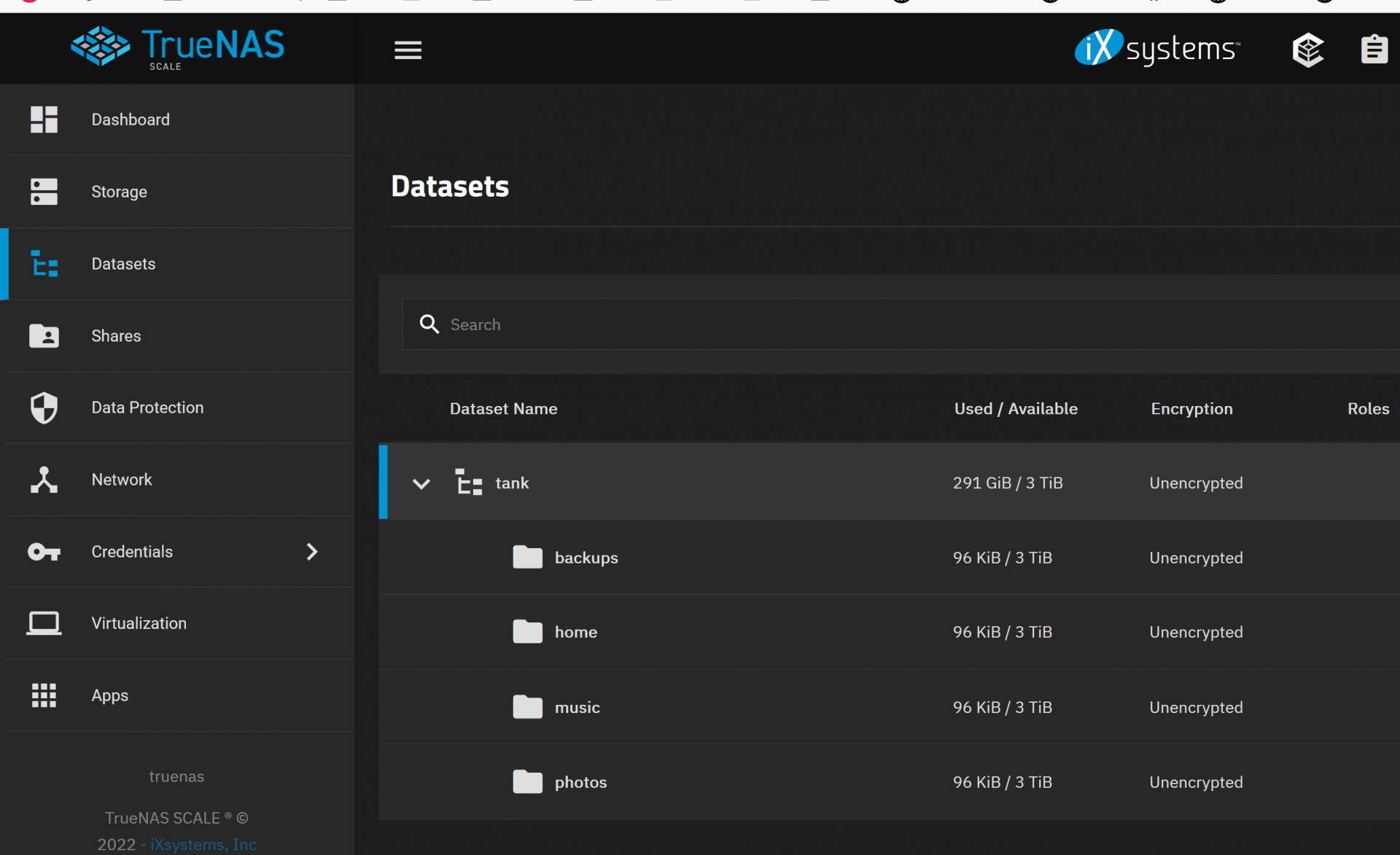

For context, here are some screenshots from the GUI.
First is, starting in Storage > select Manage Dataset:

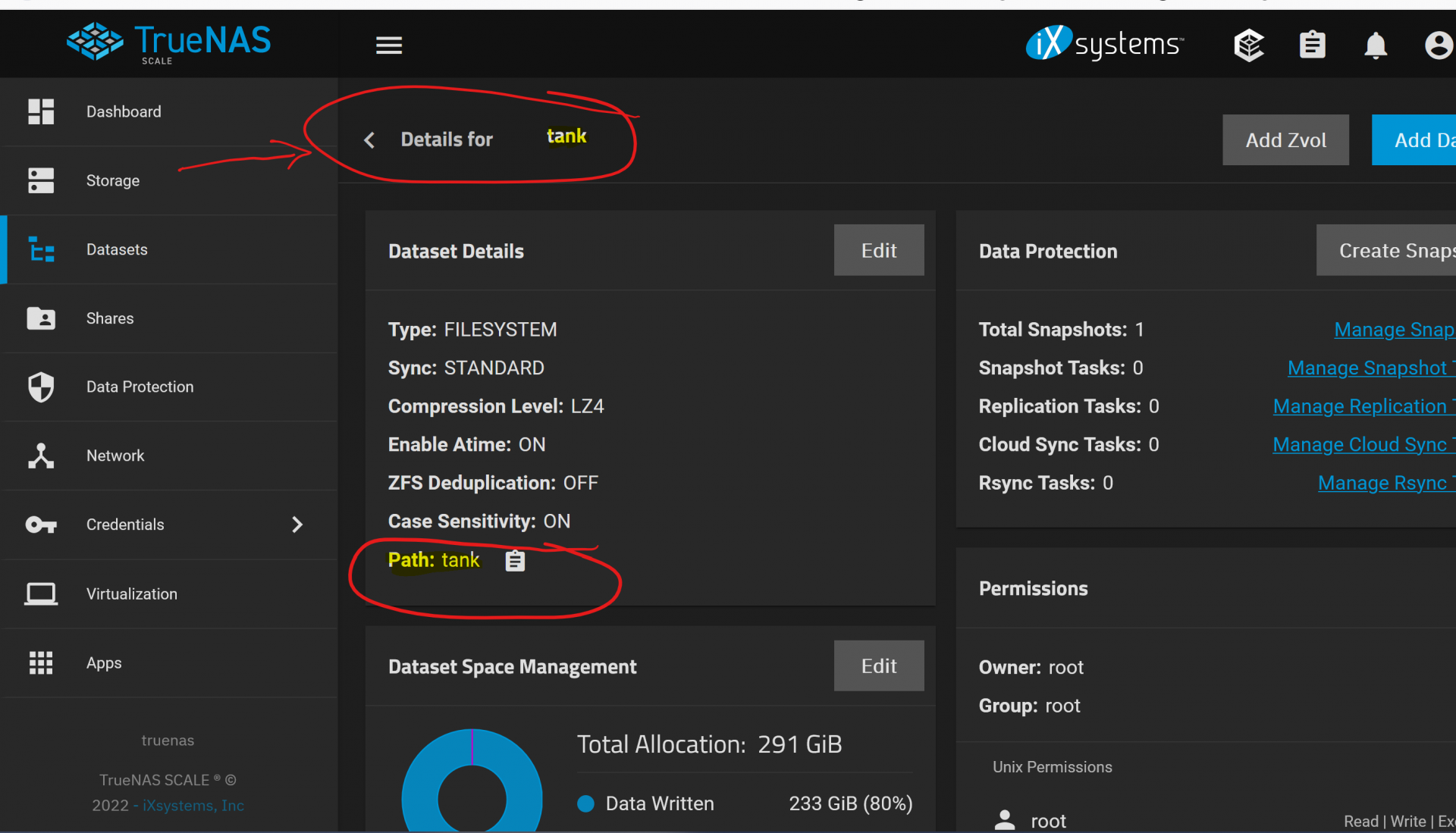

Second is Dataset Detail - where the path is simply 'tank'.

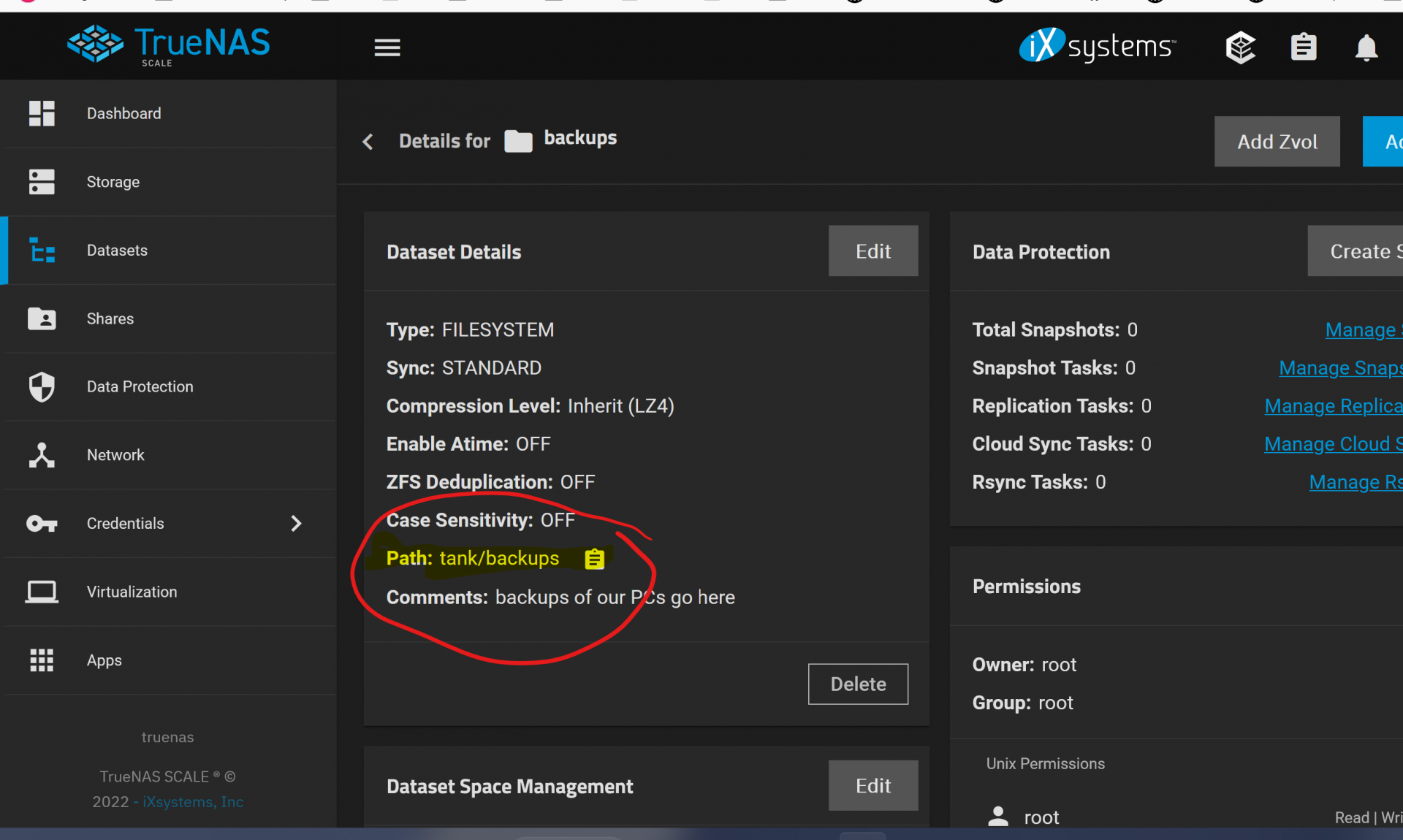

And under Datasets, here is the Dataset Details for 'backups', where it shows the path is 'tank/backups'.
