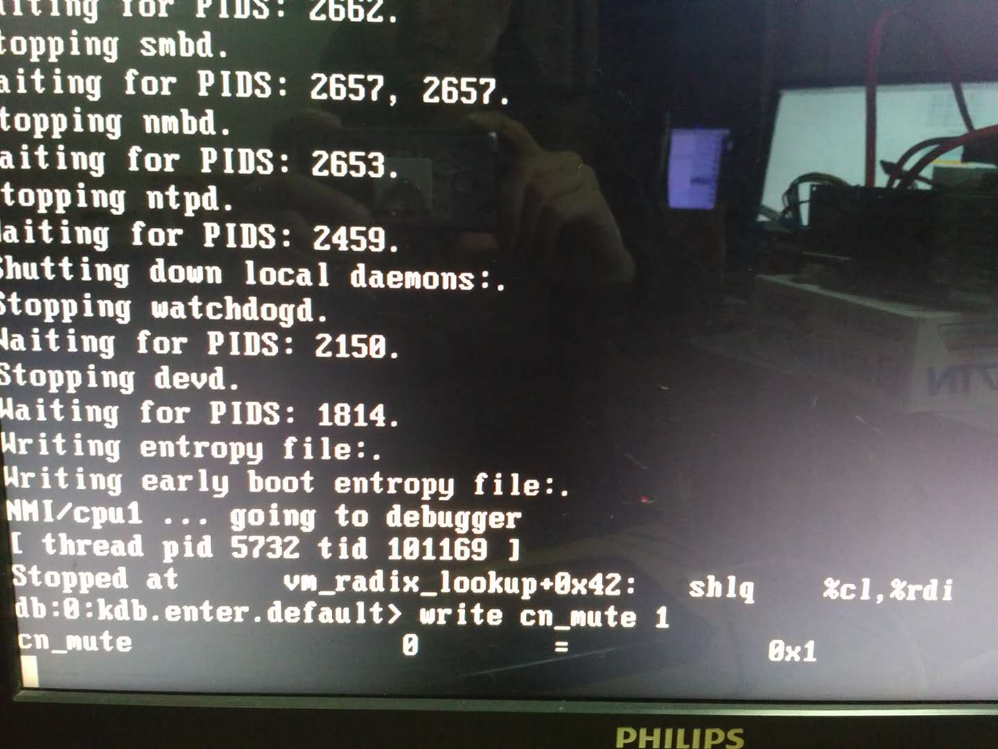

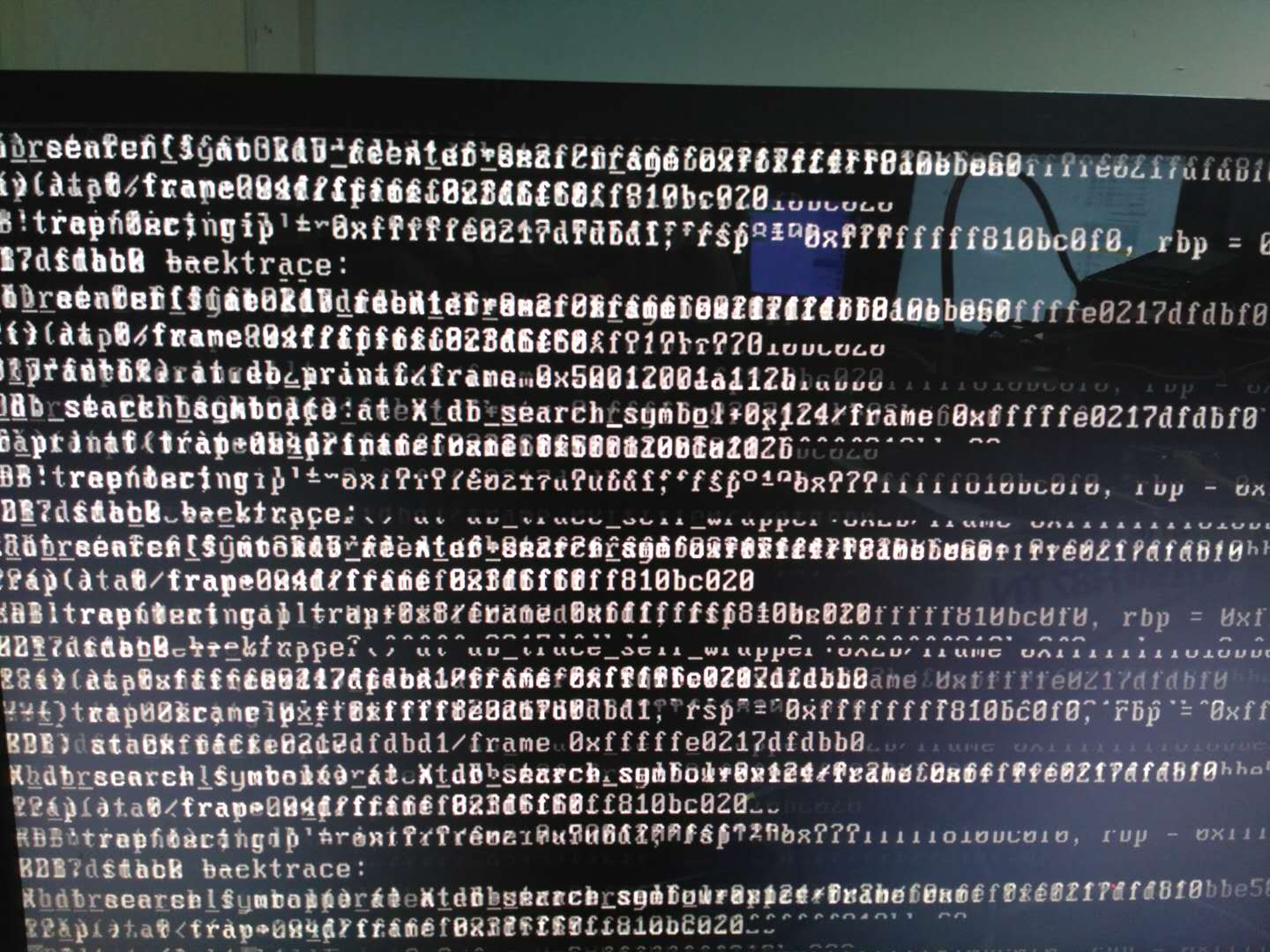

Hi Everybody, I have a issue with my new FreeNAS box (FreeNAS 11.1 latest official stable version). My box is build on:
Intel G4600
Asrock rack C236WSI ITX
8GB ddr4 witho ecc
8*ST 3TB hdds with RAID Z2
Everything is working good but except 1 thing.
When I want to shutdown or restart the server it will going like 2 pictures in attachment file, not every time but 3-5times each. Please anybody has idea with it?
PS: I already replace the ram, cpu, power supply and upgrade the bios the newest.
Thanks a lot.

As an experiment, install 11.1 on another stick to see if the issue persists. If it doesn't, upload your config and test again if the issue persists.
Hi Dlavigne, I tested but its same. not add any tunable parameter.
In the attachment file is the system debug file may be you need it.

Please create a report at bugs.freenas.org and attach that debug to the ticket so a dev can take a look at it. You should then delete the debug from this forum post as it may contain private info. Thanks!
skyyxy
Jul 16, 2016
136
Big thanks. I push created the report.
