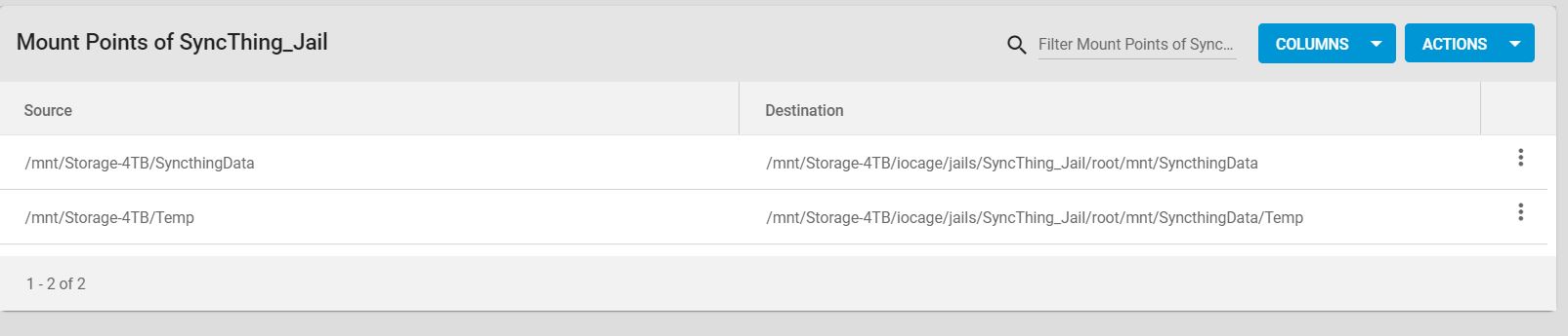

I am looking to have multiple jails for SyncThing. When I try to setup multiple jails, SyncThing doesn't start after creating a second jail. Is it possible to have 2 instances of Synching running on the same TrueNas system? If it is possible, what are the pros and cons of running 2 instances? Thank you.

I think I meant mount points rather than jails. I am looking to setup multiple mount points within one jail of SyncThing but that doesn't seem to work.

First, I stop SyncThing. Then I go to Mount Points. Click Actions, then Add. I select a Source and Destination. I now have 2 mount points setup in SyncThing_Jail. I go back to the SynThing Plugin and try to restart it. It does not restart.

Please show the configuration of the two mountpoints.

Here is a screenshot of both mount points. If I remove the bottom one, SyncThing will start up. TrueNas version TrueNAS-12.0-U3. SyncThing version 1.15.1. Thank you for all your help so far.

They cannot be nested. Plain and simple. You need two separate paths inside the jail.
E.g.
.../root/mnt/SyncThing/Data
.../root/mnt/SyncThing/Temp
