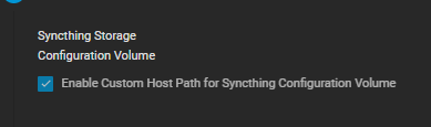

Is that option for the first picture from the TrueCharts app or the stock one?

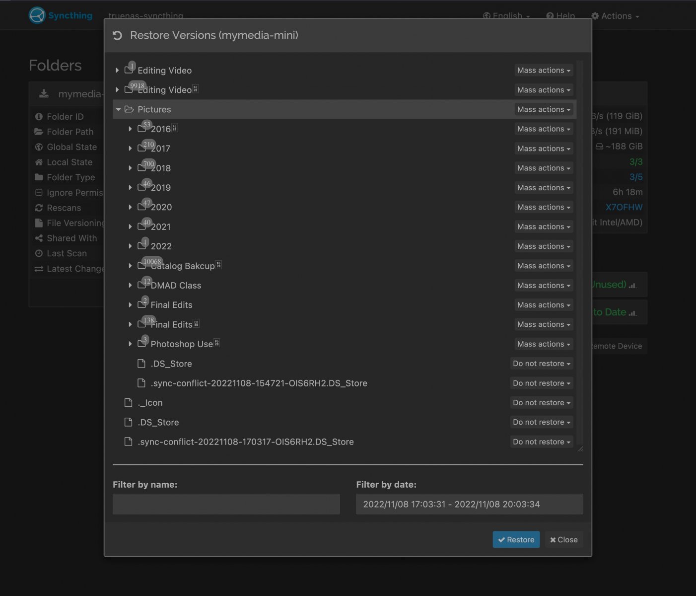

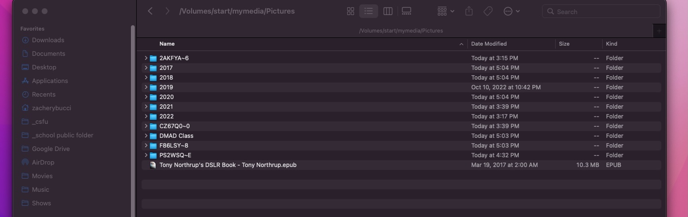

Also, something else that's interesting that I see now. In the picture below, Synchthing displays the correct file structure, but as you can see form the other picture, just logged into the server with my mac its all wrong.
